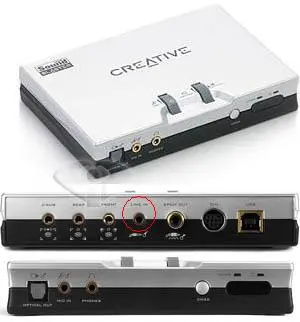

ok, i have it all correctly set-up, i believe.
studio projects b1 mic > ART phantom III > xenyx 502 thru xenyx mic preamp (xlr) > tape outputs to sb live! line-in/mic-in.
from what i can tell on my documentation, the mic-in is the same as the line-in on the sb live. i selected line-in in the playback settings in the control panel. for the first time, i'm gettin decent vocals; but it's only on the right side of the headphones, the left still has the feedback hiss (almost sounds like buffering inside the computer).. i can just copy the right channel and paste it over the left channel and get decent vox. but, i'm just wonderin if i'm stuck with this until i get a new soundcard or if maybe somethin is still wrong with the set-up?
Well, the line-in is usually stereo, and mic-in is mono(i think the line-in might be on the back, as shown below).
Generally, if you are working with 2 channels, you'd want to pan one left and one right, giving you 2 separate channels to work with in the pc. You could change the settings in your software to record mono, which would save you copying the right track to the left(although mono is usually the left channel).
