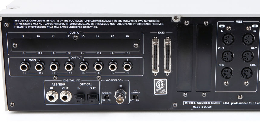

I'm saying, that as a MIDI device, keyboards are limited in that way. While in Electronica, they may need an audio out for each MIDI voice
