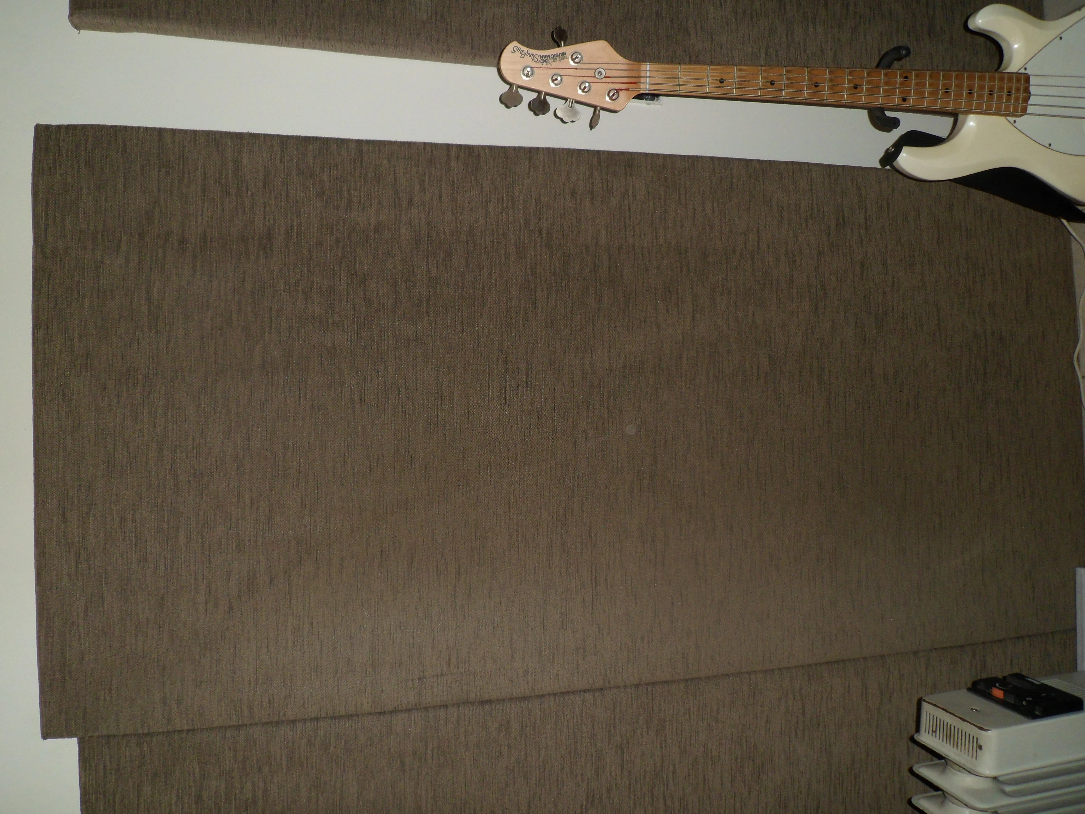

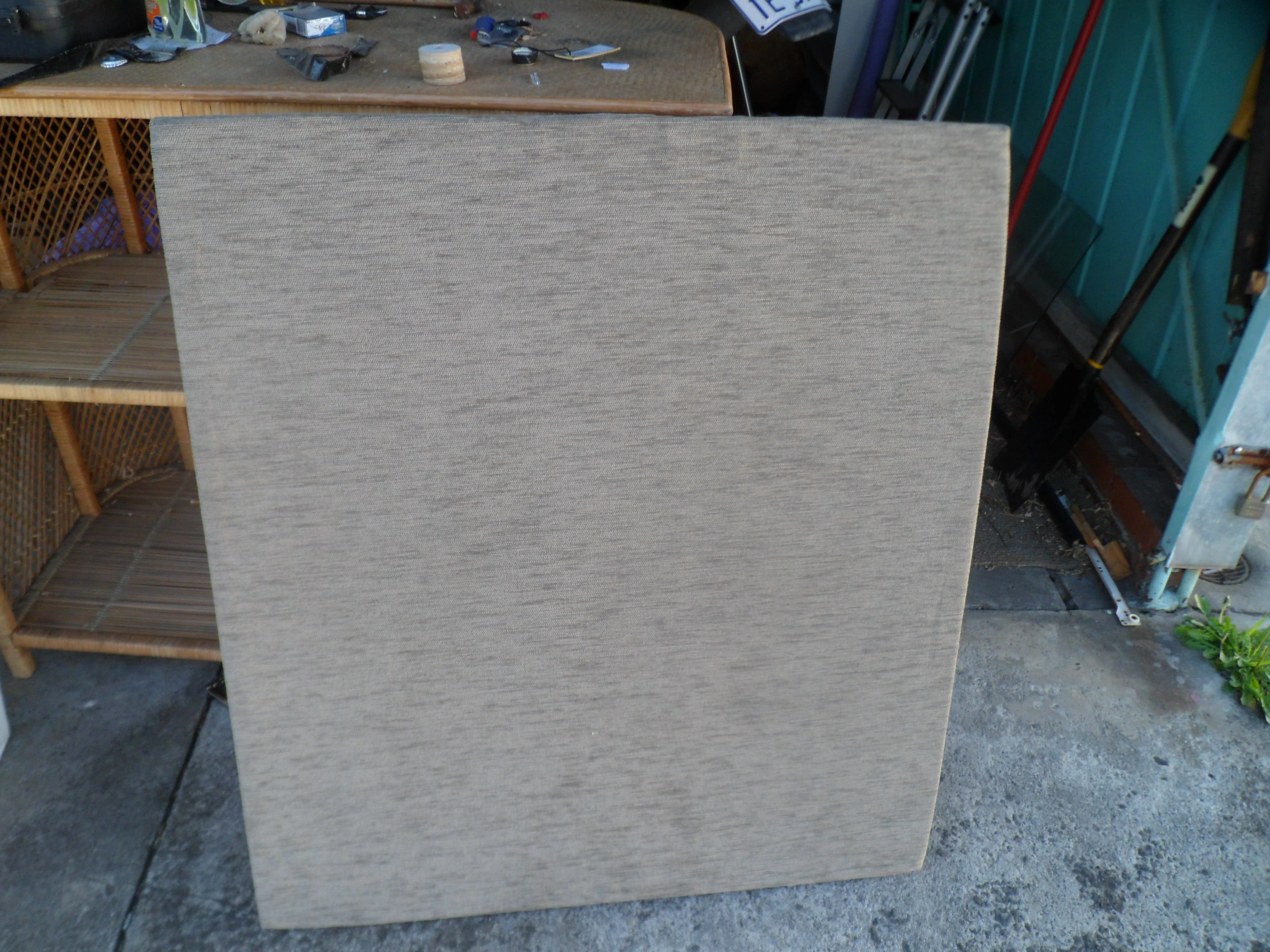

Helo all.
I am about to start building my home studio and would like some tips/advice before i take to my materials with hammer and saw...
iv found 10 1900x900mm pannels and 4 1000x900mm pannels out the front of an old warehouse, i know their not ideal seeing as their made from foam not fiberglass but am doing this on a budget so they will have to do. was thinking of putting some cardboard between the foam and the cloth covering the pannels to compensate for the foams softness. is this a good idea or would it be better to just leave it as it is??

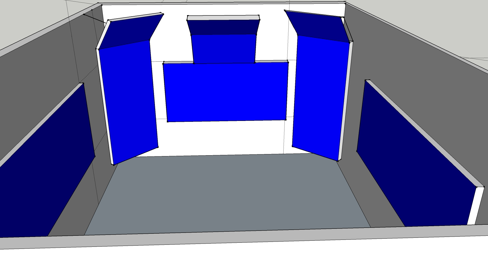

I would also like some advice on placement of the pannels. iv done some reaserch and have come up with what i think is a good layout but would like some feedback before i get started.
here are some images of what im working with and the planned layout of the pannels, with an identical layout on the rear wall. any feedback would be great
cheers

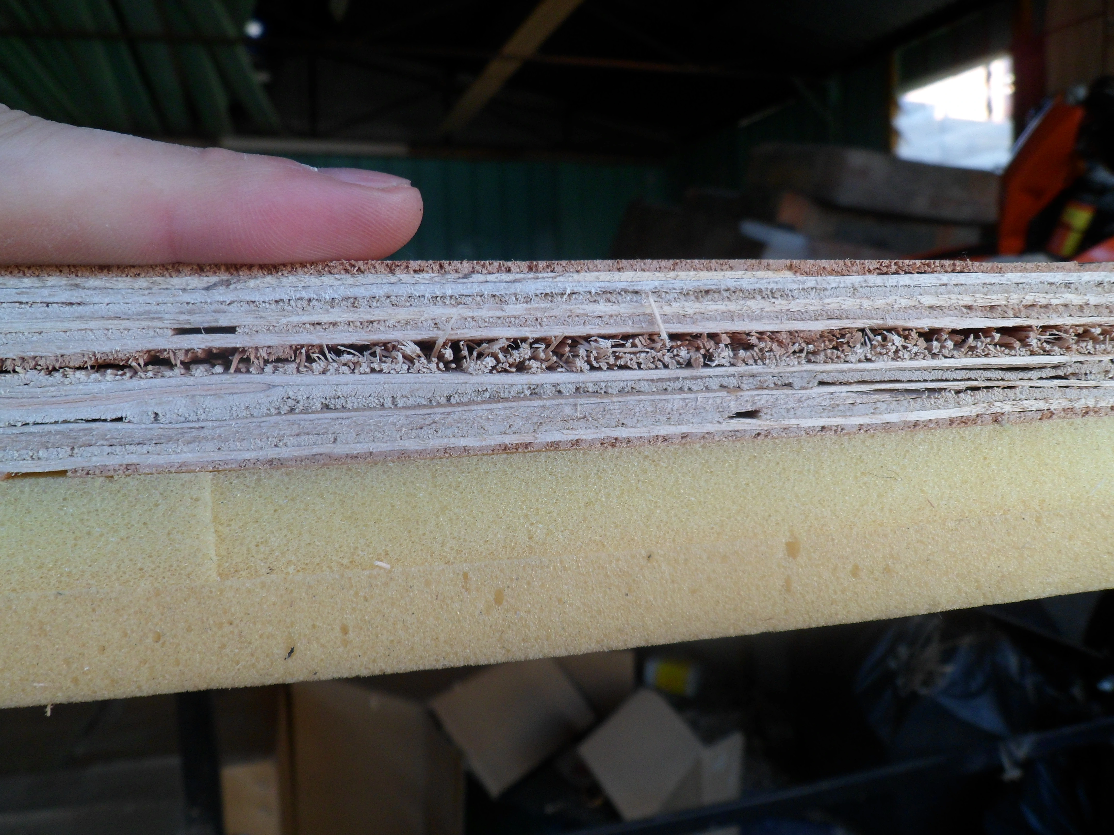

I can't be certain, but that doesn't look like acoustic foam. Can you blow through it easily? If not, it's just packing foam. It also looks too thin to do anything at bass frequencies. It might help a little, but probably not enough to be worth much effort. Regardless, placing plywood in front of foam as you show is not useful.

cheers for the advice guys. iv started to put it all together and it is making a bit of a difference but not a heap, i guess ill have to wait until i have the dosh for some owens and then just swap it with the foam...
--Ethan
ill be placing the foam on the outside with the plywood against the wall/across corners, im hoping this shoald have a prety decent affect on the higher frequencies?
Sorry mate. You're not after advice; you're after confirmation that waht you are doing is OK.
It's not & you'll be putting in a lot of effort for little return.
That's cool if you're strapped for cash, have lots of time/energy and don't expect too much from your efforts.
That plywood's pretty heavy looking & quite thick compared to the foam - take care hanging it all so that nothing lands on your scone.
I hope you have success with it. I'd be happy to say I was wrong!

Before? Apparently you re-defined the word to mean...AFTER. Your pictures prove it.
Ditto.
apparently this is an english class. your so smart arnt you
I think he was referring to you asking for advice on if what you were doing would work after you already did it.
More of a confirmation that what you did would work instead of getting advice on what WOULD work. And it won't work great but it will help some. I'm guessing it'll help more along the lines af your mids and highs more than bass buildup.
Just a thought...:drunk:
(p.s.... in this tense, it's you're...not your...aren't...not arnt.... and I believe a comma is used after "smart")
:D
(p.p.s..... just messin with ya dude ;) )
No, that's not correct. Using wood will reduce the effect of the bass traps.
--Ethan
Apparently this is an English class; you're so smart, aren't you? (Possibly intended to be rhetorical which may or may not make the quotation mark redundant depending on which side of the Atlantic and irony you live).
No, he was referring to your original statement and the lack of tense agreement when it met the photographs as demonstrated by the following quoted statement and your 2nd, 3rd & 4th attachments.
"I am about to start building my home studio and would like some tips/advice before i take to my materials with hammer and saw..."
Whereas the snaps show work that has undergone hammer & saw processes.
I reiterate my initial statement though amended to correct the spelling mistake and therefore bring it into line with the grammar & usage parameters of this thread:
Sorry mate. You're not after advice; you're after confirmation that what you are doing is OK.
P.S. Bass traps are't bear traps & Ethan is, as usual, on the money!
