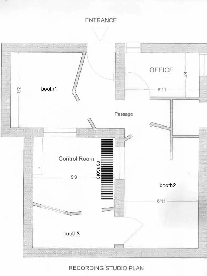

Hello friends !
I am waiting for your advices and support for designing our studio. Please point out your suggestions for best optimization.

Hi Charoo - I received your email today - and yes I will help. In fact we can all help here at HR.
Guys - you can check out where Charoo is from at this site.
http://www.i-indiaonline.com
They are an NGO working with street kids in Jaipur, India. They want help with the design of a studio they want to build for the kids. :)
This is the plan charoo sent:

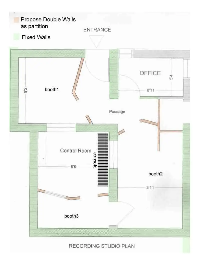

One thing to get started -- what walls are fixed, and what can be moved around? Could you post a drawing with just the fixed, unmovable stuff so we can play in the interior space?
Offhand, (and I am *NOT* an expert like some of the great folks around here) I am concerned about the lack of symmetry in the control room. Seems like that would make it hard to have a good balanced stereo field.

Dear Friends !
Once again thanx for caring and sharing ur opinon and advices on our project. Please find enclosed revised drawing imparting fixed, and unmovable stuff.

What will they be recording? Is it music, or spoken word for radio or what?
I ask because the design of the control room is still bugging me. If you are just mixing down to mono for AM radio, then a lot of problems go away, but if you are trying to produce good music in stereo, you need to be able to hear a good balanced sound in the control room.
Offhand, I wonder if it would work better to get rid of the third vocal booth, and to use the area for a larger, symmetrical control room. That way you can put the monitors in a position where you can have a good balanced stereo field.
Yes, the downside is that the control room is rectangular, but with the right treatments on the walls to control reflections, and bass traps in the corners, I wonder if it could be made to sound good. I defer to the experts around here -- this is just my guessing.
How high are the ceilings in the rooms?
-lee-
hey !
Well i am ready to use full space for control room by merging vocal booth too. The ceilings are around 10Fts high in the room.

application of studio
well we are looking forward for handling entire music production in stereo only as we''ll soon update it into a community FM station if we got some financial support.
Here is our technical configuration we gona operate:
TASCAM DM-24 Mixer
Pyramix DAW
DA-78HR, DA-40, MD, 130 Cassette Deck
Monitoring system: Genelec 1029A and 1032A
luv
charoo
I would recommend moving the console and more importantly, the monitor speakers onto the narrow wall at the top of the control room. I would also recommend getting rid of the third booth. For an example of a similar control room plan, check out rsb's recent post.
