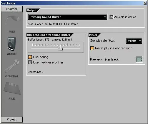

Increase your buffers in FL.
Options - > Audio Settings
Do this until the underruns stop increasing. The example on the screen is a crappy laptop soundcard. You should be able to run about 20-30ms on a good soundcard.

I tried Rustyfingers suggestion with the buffer and it helped a LITTLE bit. Now the song wil play great for a few seconds and then it starts crackling again... but I notice the comp on the whole also slows down...
Is that because I need a better soundcard? or just cause I was running my dial up internet conection, Internet Explorer and MSN Messenger along with FruityLoops?
