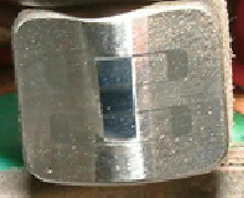

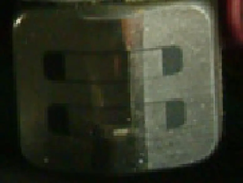

Are these worn? :confused:
There looks to be just under 1mil of metal gone as indicated by the flat spots on the tape lifters and heads. Yes, there is some ware, looks even, nothing severe but it's hard to tell how much metal is still left on the heads. I'd still venture to say that the heads look to have a lot of life left. I'm not sure how severe the guides / tape lifters are to warrant turning them around but I'd def see what it does to the tape. I may also want to overcompensate, a bit, for the head ware, by adjusting the EQ and maybe bias.
The thin black line....
Take a look closely at the center of the head to see if you can see the gap. If you do see it it will appear as a thin black line running from bottom top of the head. Human hair is about 80um (micrometer) in diameter and a record head gap is typically around 10 um. So if you see any line you can expect to replace that head. (Note, erase head gaps are around 50 to 100 um)
Use a magnifying lens to get a good look in a bright light.
Regards! --Ethan
PS if you have an other half track you could make your own test tape. Record some 0 vu and -10 vu tones at 30, 100, 1000, 10000 and 16000 Hz. then play that tape on the DUT (Deck under test ;-)).

Well, For some reason I was thinking that this deck was close to you. And heads are very hard to photograph!
Best of luck (They really don't look too bad but YMMV!)
Image processing does not bring out any gap....
Another
Can't see any gap line here doing an edge enhance on the image. So there is a good bet that this head is OK. my guess is 50% worn (but don't trust me on this!)
50% would be another 5000 hours? If it's true, that's pretty good.
