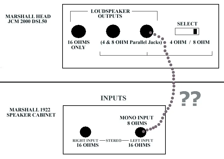

Looks like I may have found the right place for my question!
I've just bought a Marshall JCM 2000 dsl50 head and I've plugged it into the mono 8 Ohm jack of my Marshall 1922 cabinet (using the one lead I was supplied with) from one of the parallel jacks (as illustrated in my attachment). Am I doing the right thing?
I searched this forum before posting but the one thing I couldn't find was whether it's OK to use just 'one' output from the parallel pair on the head (??).
I've been playing guitar long enough to know things like this but I really am a dumb-ass when it comes to equipment. Don't wanna mess my lovely new amp up so any help would be greatly appreciated. CHEERS! :)

THANKS SO MUCH FOR REPLYING ...
I'll get it all fired up now !!! CHEERS !!! :D
I'm guessing it's the same for a DSL 2000 100w head as well, thanks Cheetle. I'm an experienced dumb ass when it comes to physics stuff too-I needed to know this.
Yes, it will be the same with all tube amps. You find the impedance of the cabinet, then connect it to the output that is the same impedance.
