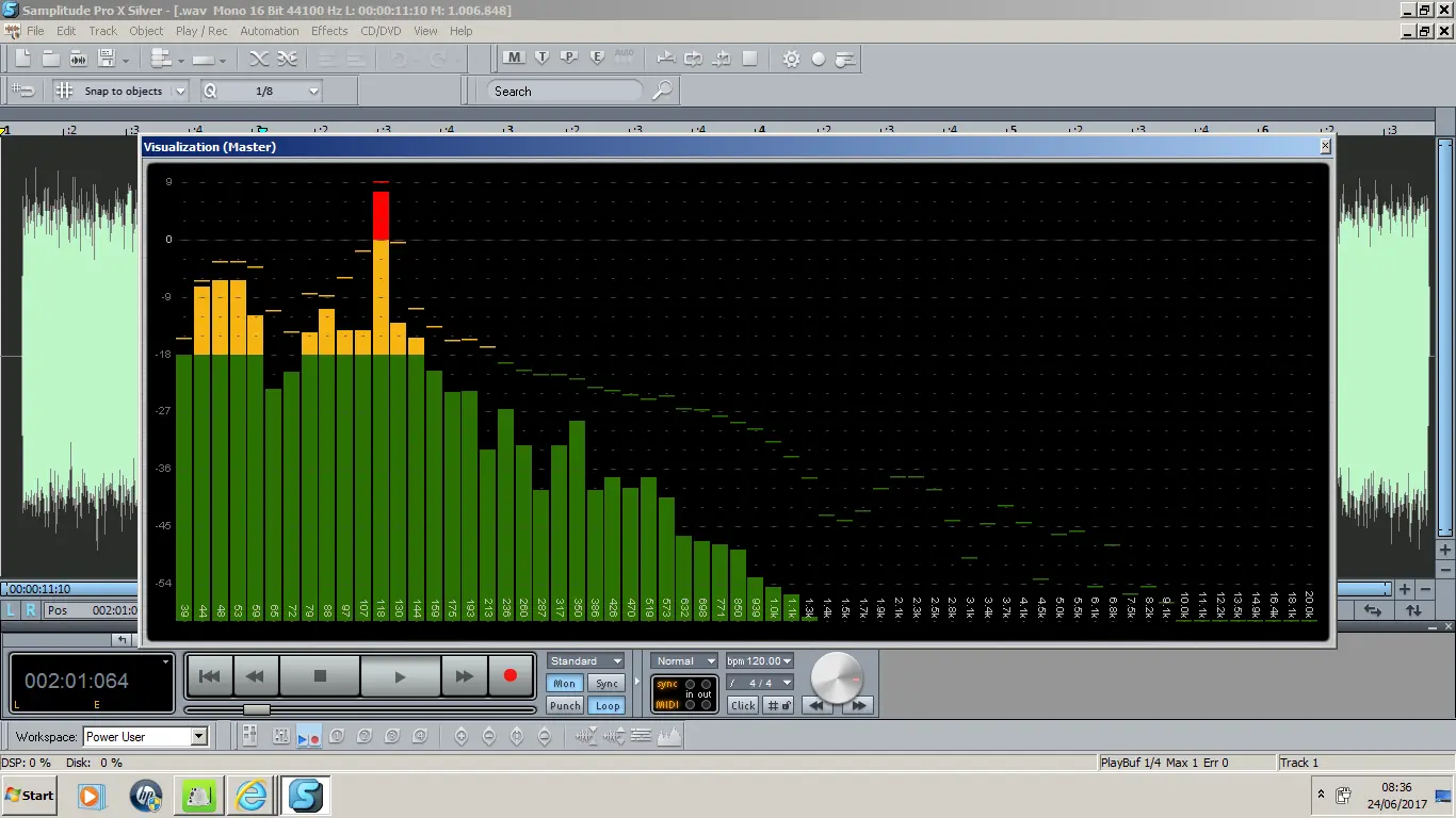

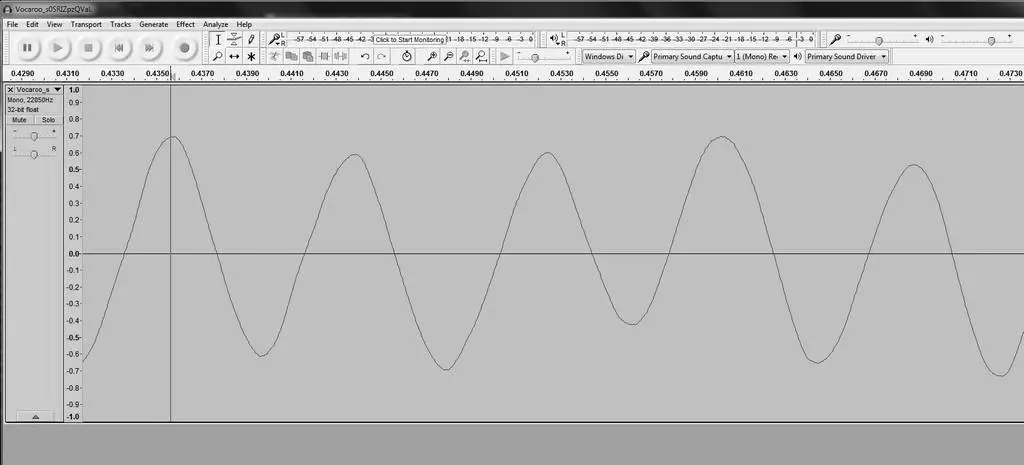

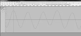

Normalized wav as mp3. Is this the 'hiss' or 'hum behind the wall'?..
I hooked up my RE20 into my 286s (trs-trs) into a Tascam US144mkii. I have a Fethead, but didn't need to use it as the gain of the 286 and the Tascam was more than adequate. I could get a reasonable -12db level into Audacity to record voice at about 4" distance. I did have an XLR cable that was acting up and creating a staticy type of noise, but changed it out and it cleared up. Tonight wasn't a good night to check for background hiss as it's raining and I have a sky window where I record and the rain on the window would have made any hiss impossible to hear. If I get a chance tomorrow I'll try it again when it's quieter.
Looks like 120Hz mains crap to me Mark?
There is no trace of 60Hz in Right Mark* so the hum has to be coming from a rectified power supply.
*Weirdness, never happened before..When I inserted the MP3 clip into Sam Silver to convert it to .wav for RMA, it would not work 'Wrong sampling format' . Sure 'nuf, it was 22050 Hz. Now Sam S has a very comprehensive converter for all sorts of audio formats so, not a problem but why 22050? I NEVER set ANYTHING to other than 44.1kHz,EVER!
