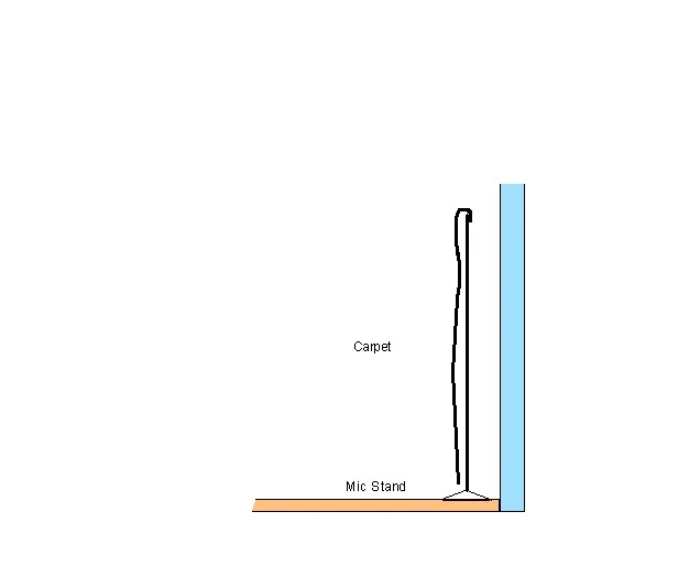

My question is how should I go about hanging them up without having to muck up my walls?
You can get a couple of extended mic stands (or something similar) with a bar across them and hang the carpet from the bar.
Like this (side view):
Kevin.

Good idea. Unfortunately I have hardly enough mic stands as it is already for my drums because I'm a jobless high school student. I'll get some more eventually and try that out, thanks.
Well, they don't have to be mic stands... a couple of 2x4's with some sort of base attached would work OK too. Like John said, the main thing is to get them off the wall 6" or so.
Kevin.
