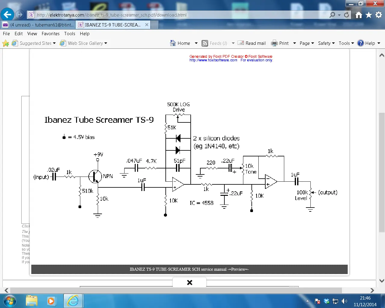

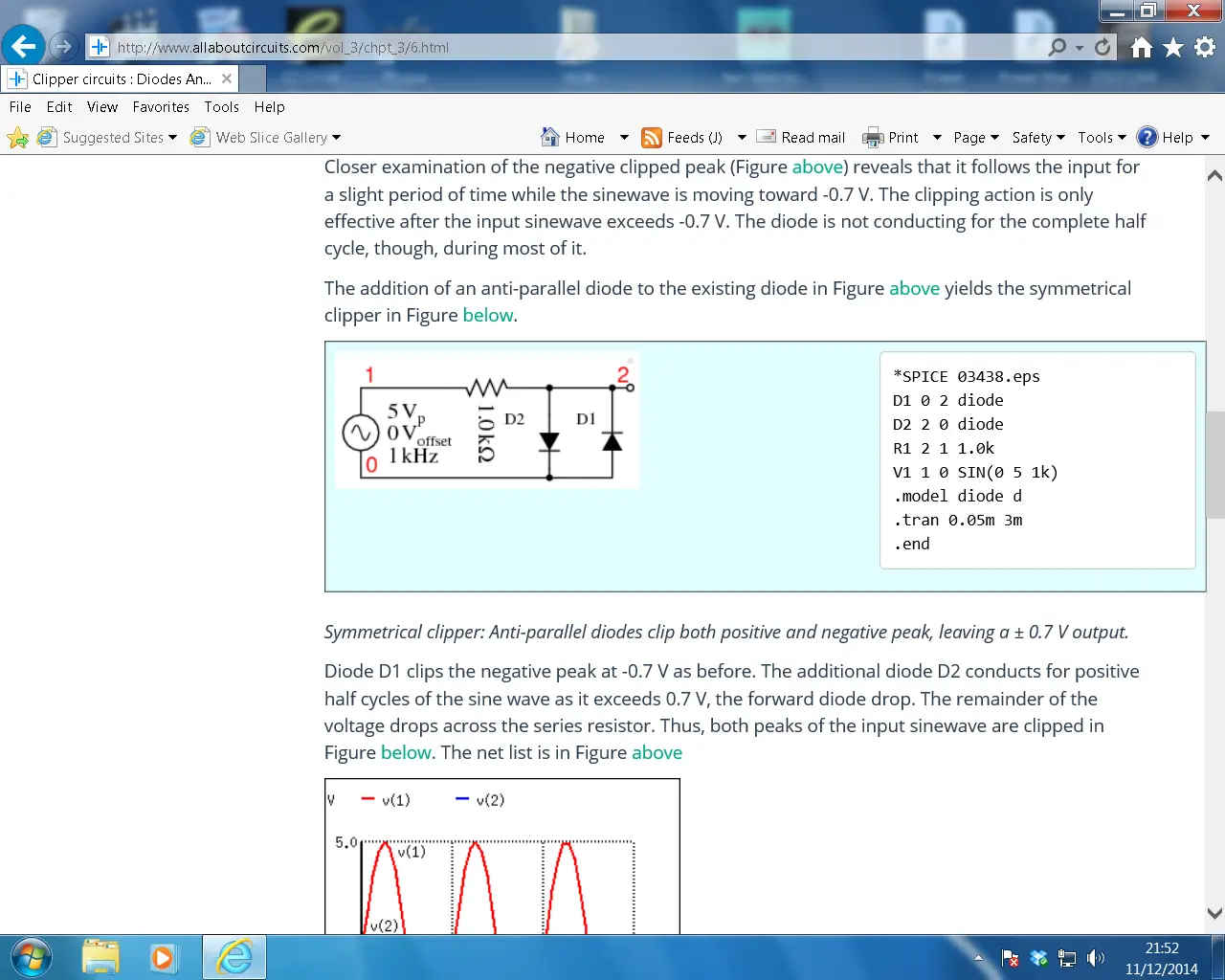

I was wrong! The Tube Screamer does NOT use a diode clipper but the non-linear feedback arrangement.
The attached shots show the two circuits, hardly ever see a true clipper in a guitar amp.

If you can please, if you have the time, check out the schematics for these amps:
Marshall JCM 900 2100 MkIII
Marshall JCM 900 4100 Dual Reverb
Marshall JCM 800 2210
I believe all three of these amps have "diode clippers" for their secondary gain channels. Or maybe even LEDs.
Here...look at this one. This is the Marshall JCM 800 2210. I'm not very good at reading schematics, but I think I see the diode circuit at V1b.
