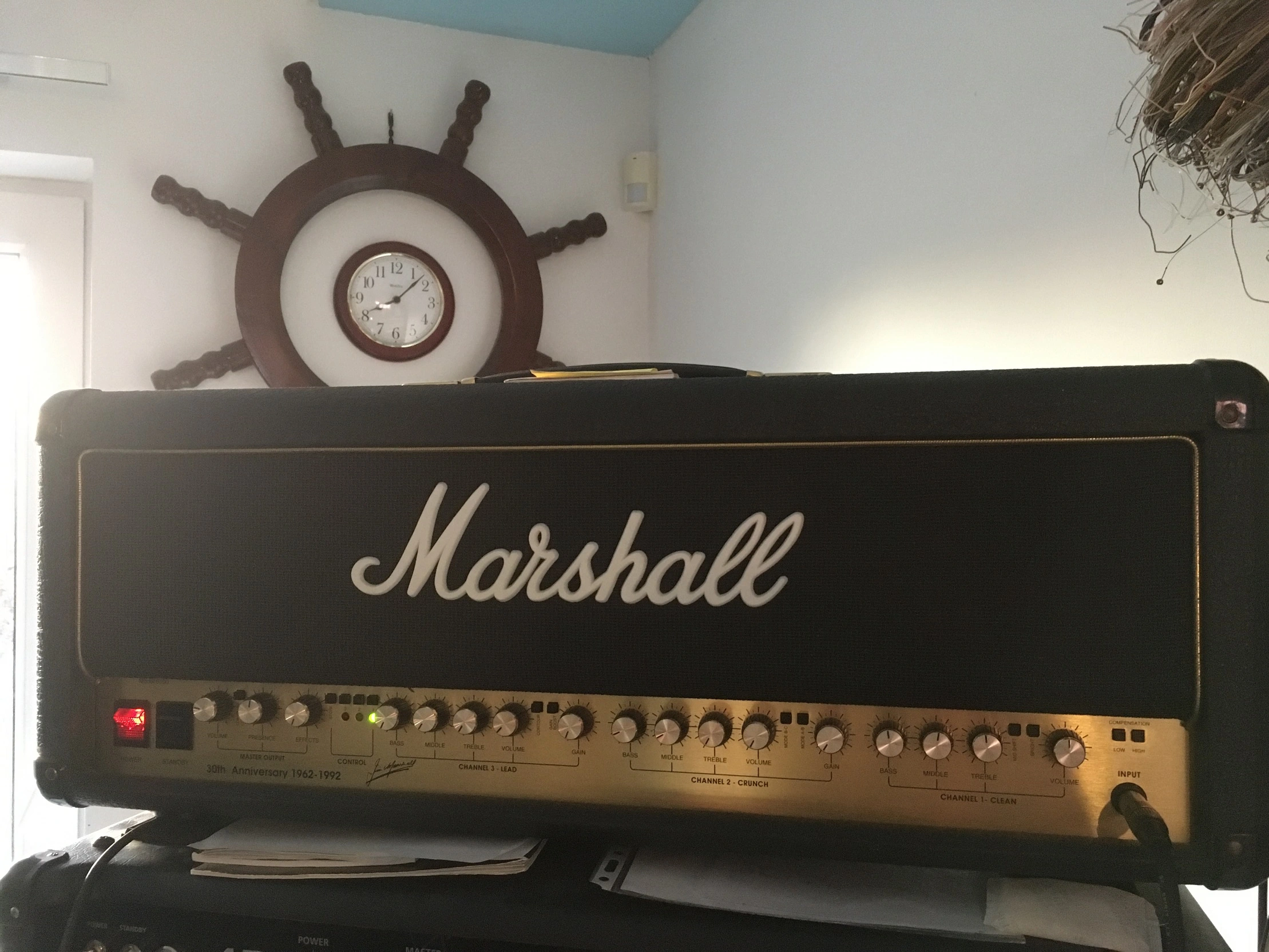

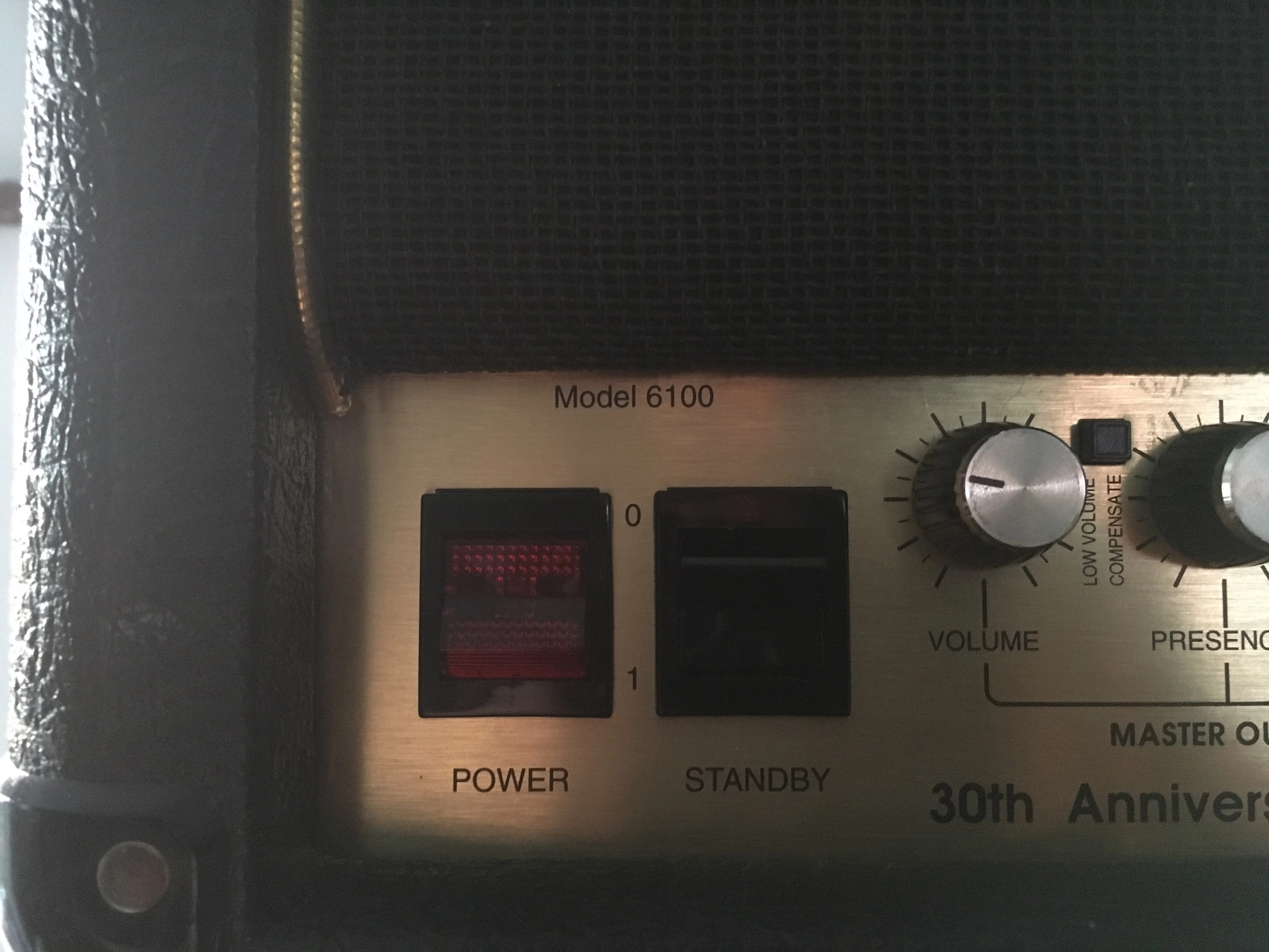

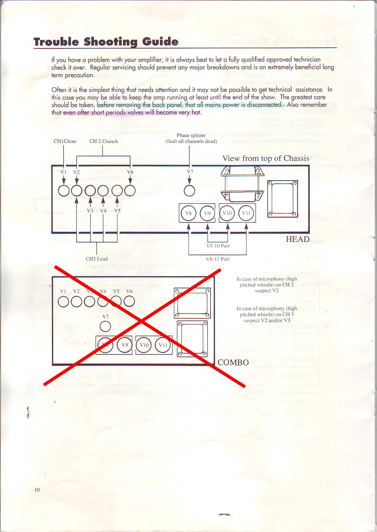

Let me have the Marshall model number and schematic if you have it and a description of the problem. I communicate with a top bloke in Scotland who knows all there is about guitar amp servicing.
Hi Dave, I've sent you a notification about my Marshall crackling problem. Here I just add an audio file with the crackling recorded (as I can't upload it in the notification).
