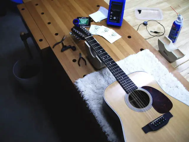

I feel stupid just reading this. I have no idea what you're talking about. LOL! I'd like to know, but i've been stuck with my cheapy $14 korg tuner for many years. Maybe a video instruction??
I highly recommend this tuner Peterson Strobe Tuners - V-SAM it is very accurate, has many different tuning modes for different instruments and has a built in tone generator and metronome. When I first used it on my Martin D12-28 I was astounded by the sound. I had never heard that guitar sound so exact, pure harmony with virtually no interference beating.
