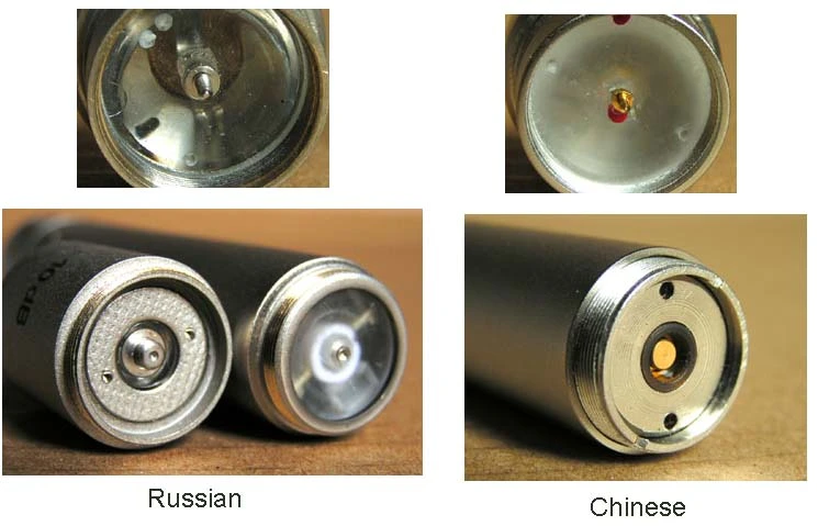

It looks like the presumptive rip offs are differentiated by the plastic instead of metal clip, lack of the -10dB pad, and most telling, copper instead of silver contact pins. Just unscrew the capsule when you're in GC and the difference should be apparent.

It looks like you just unscrew the capsule and see what color/configuration the contact pins are.

Yeah, so what's the deal... I'm not clear on that... how can I tell?

All the genuine oktavas are brass construcion with tiny flat head screws (nickel plated brass?). I have one ASM oktava that has no serial number but is definitely identical in every way to the other oktava.
The chinese version is definitely not made of brass, looks like lacquered steel and uses philips head black screws. Both the construction material and holder are like the behringer B5 whoever makes those.

These pictures.
