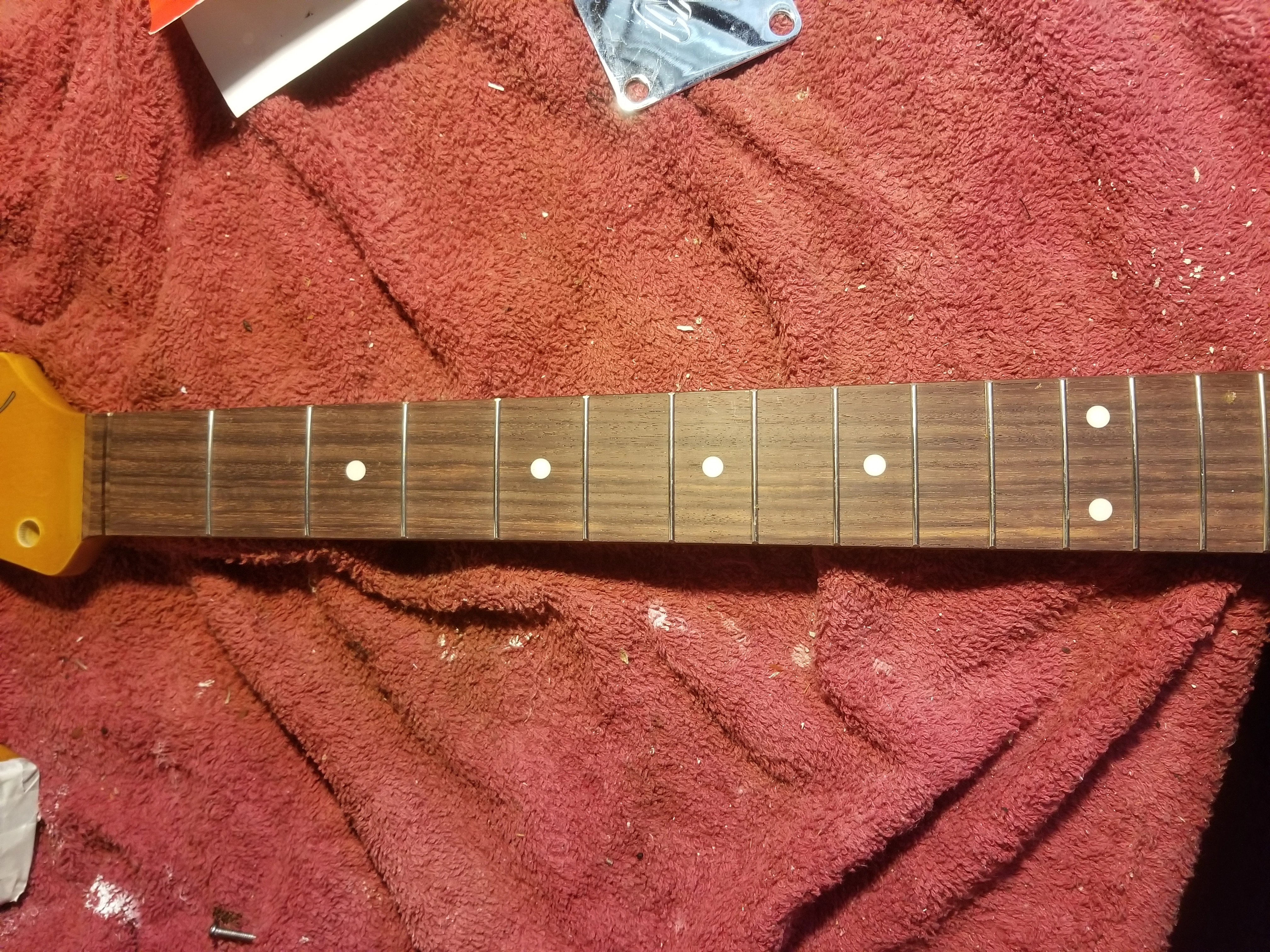

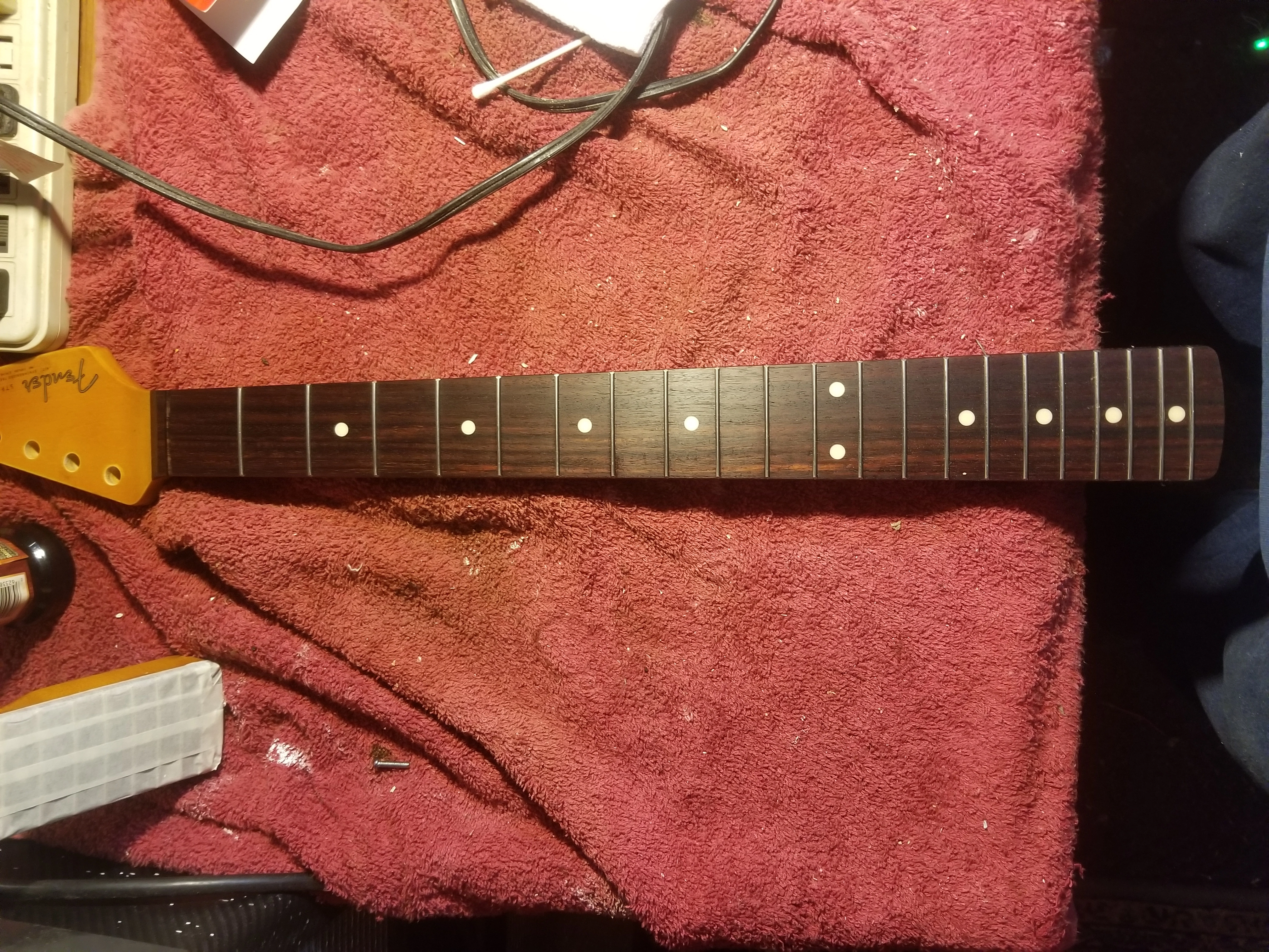

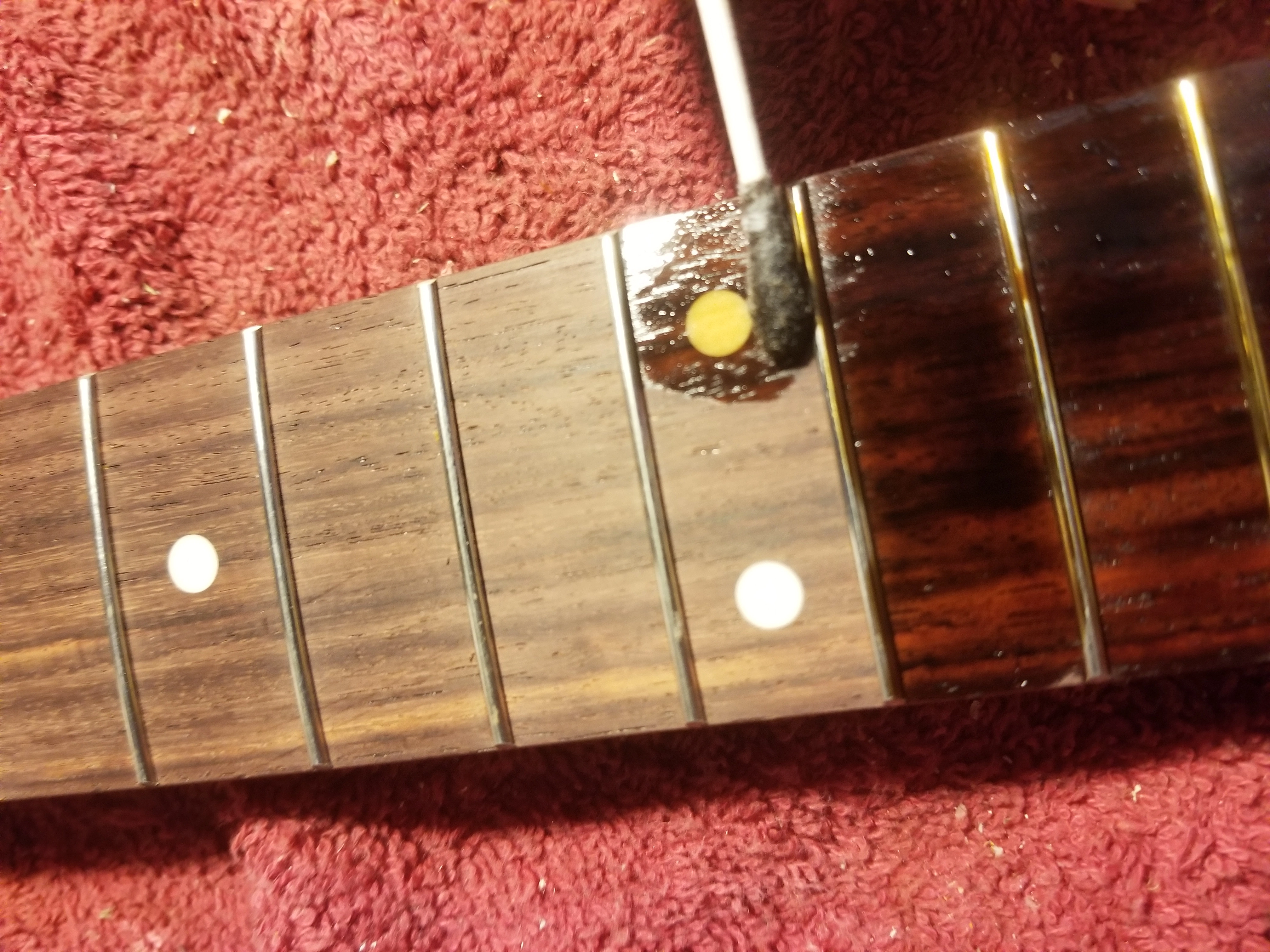

The allparts neck for my strat project has a rosewood board with a GORGEOUS grain! It's a little on the light side for my taste, but man what a nice grain it has!
time to darken it up with the Old English scratch cover for dark wood (aka Miracle Tonic!)
The difference is unbelievable after only one treatment!!

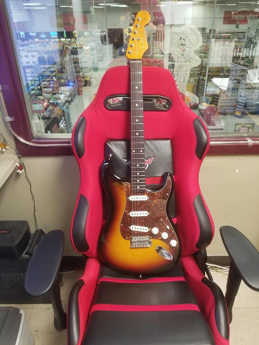

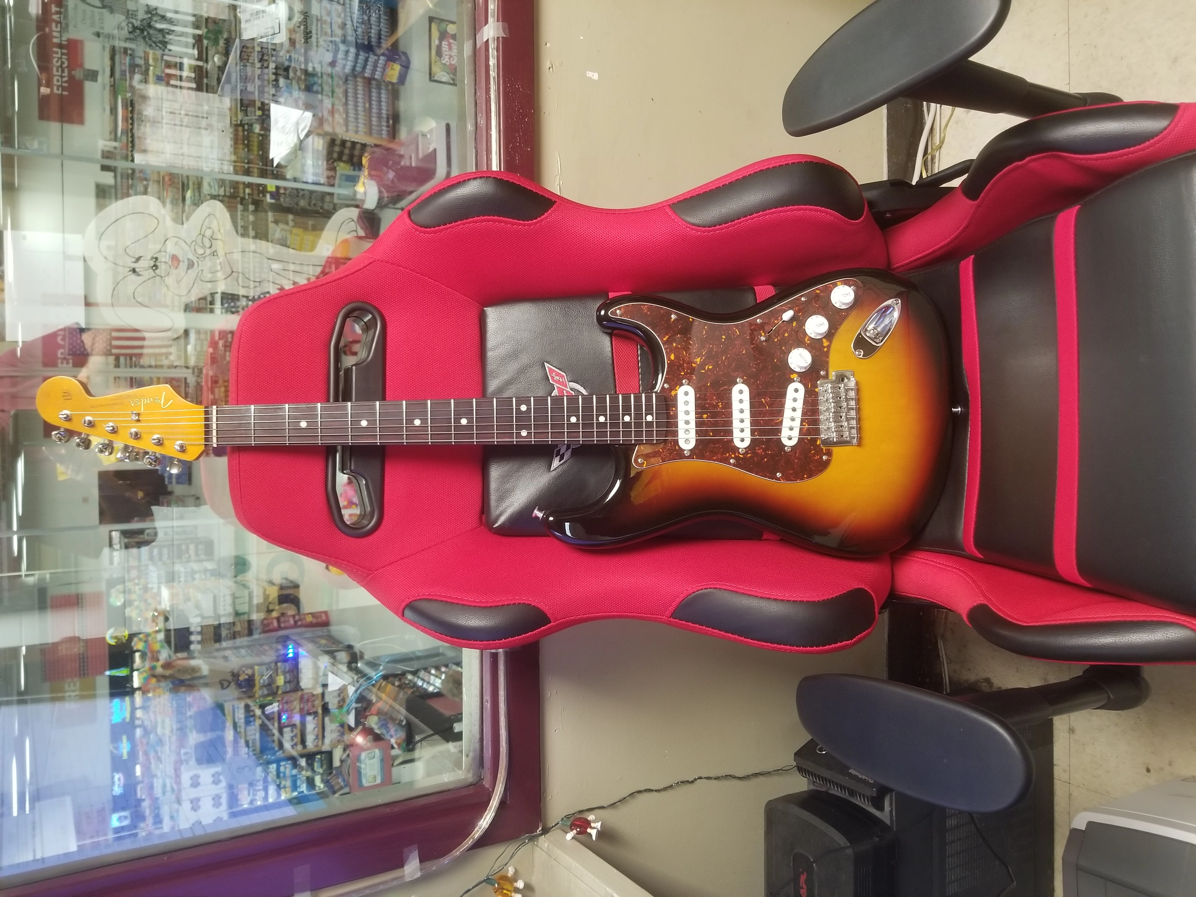

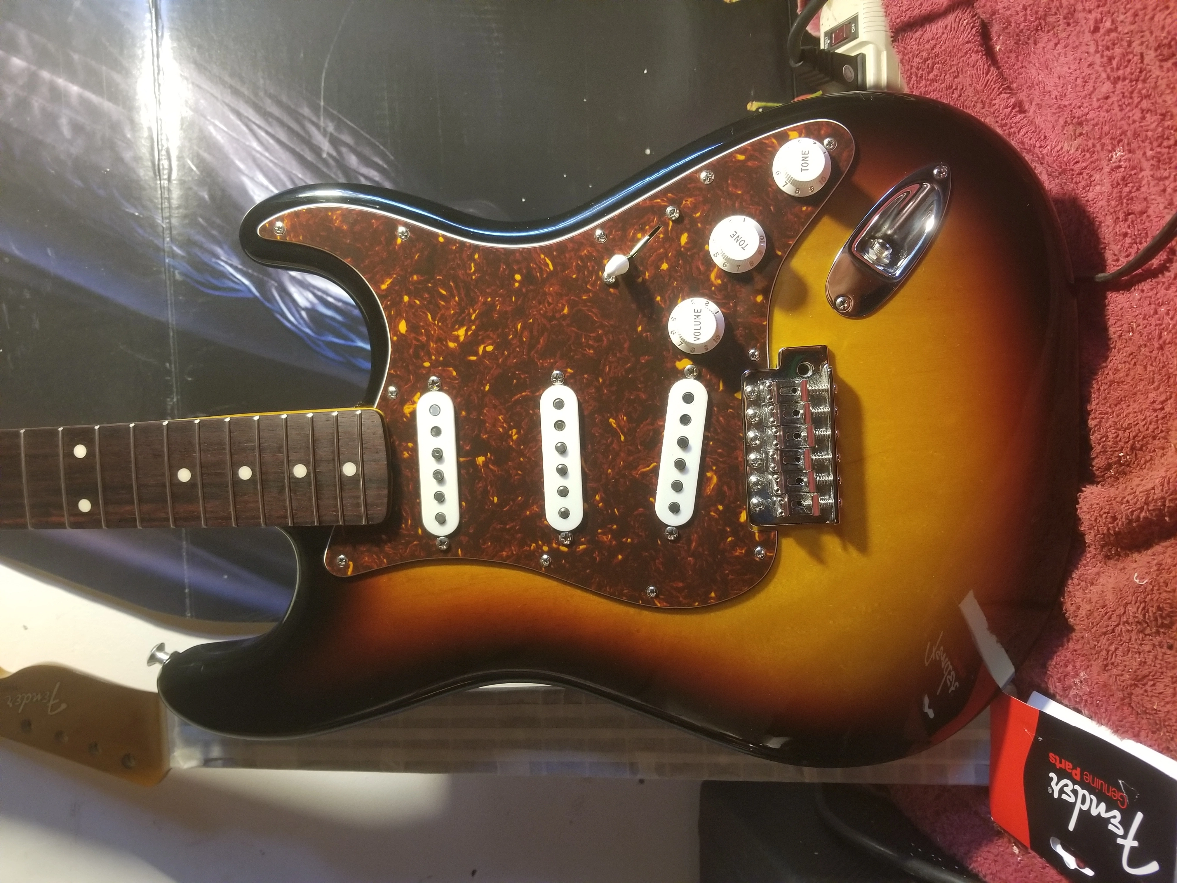

I drilled the holes in the heel of the neck after I treated it with the miracle tonic. ....
bolted it on just to check it out!!
That darkened rosewood board and tort pickguard go together like bread and butter!!

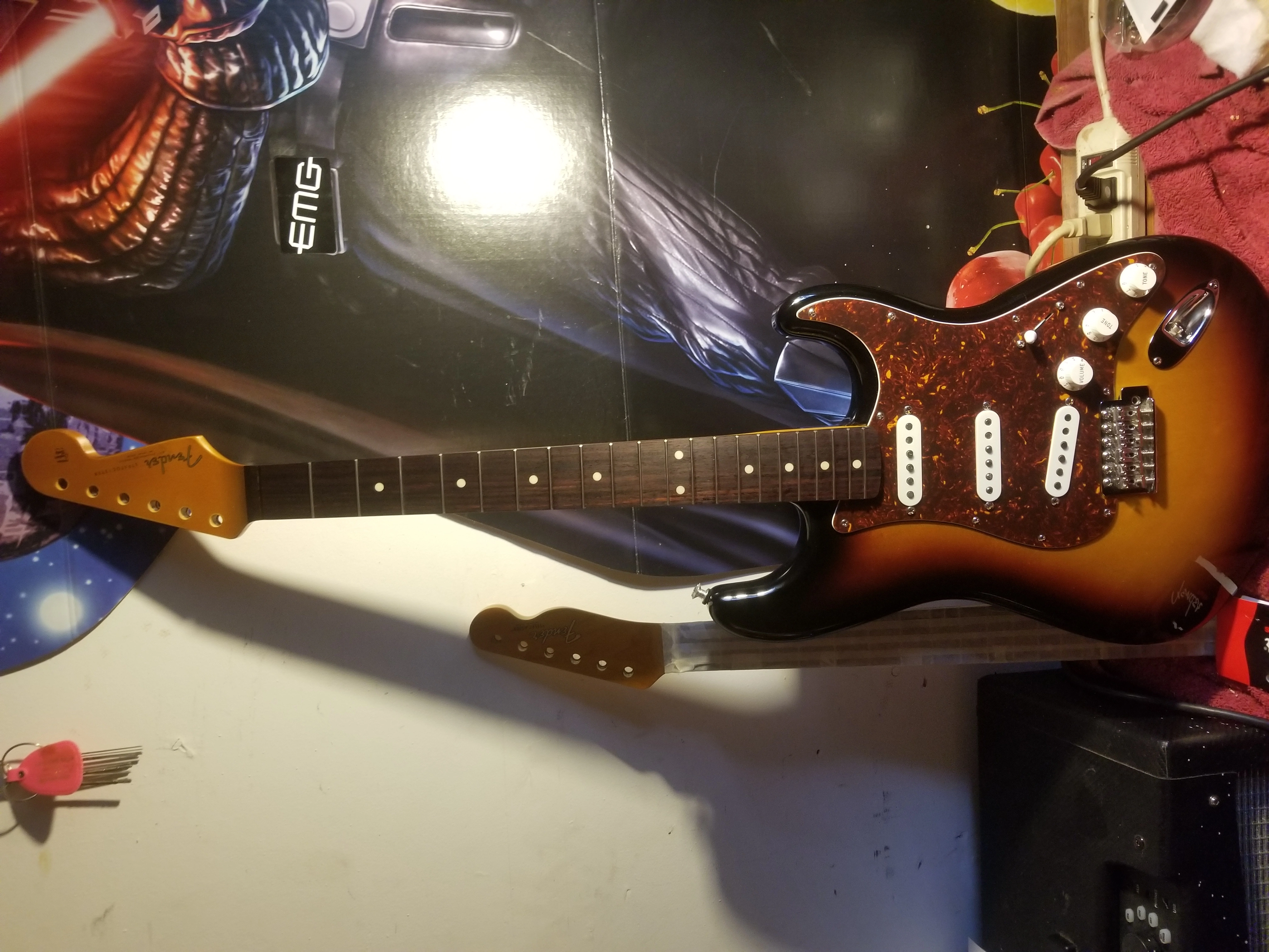

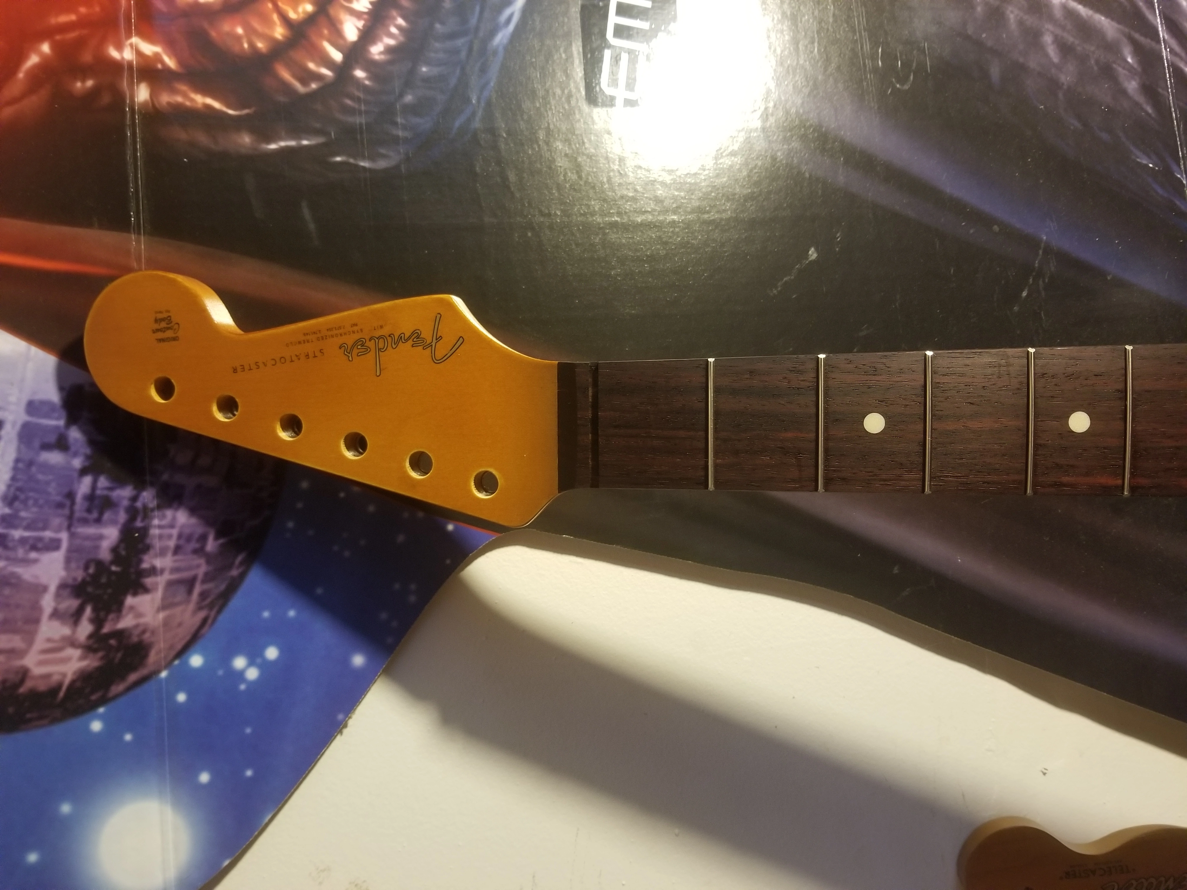

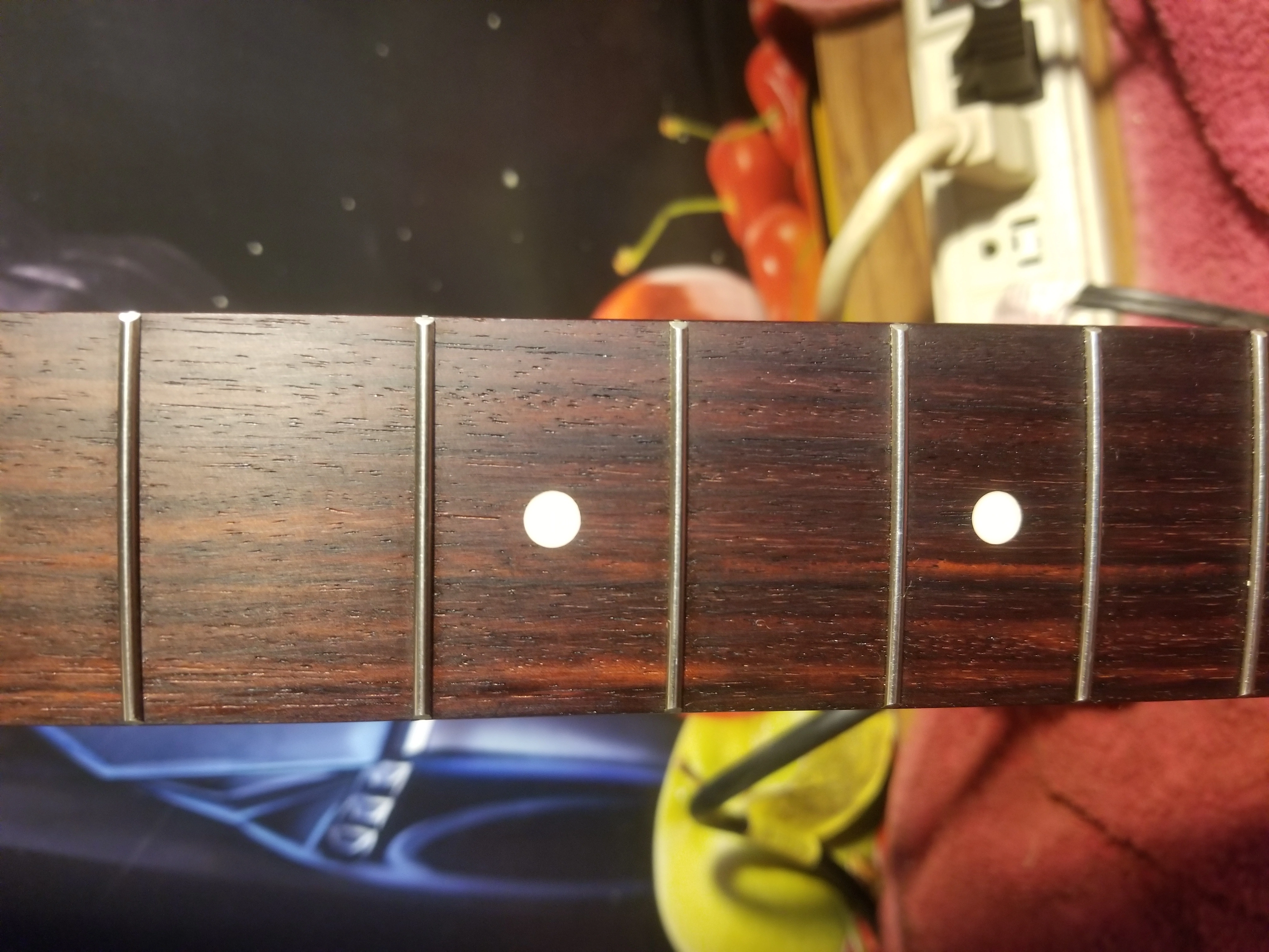

Well, after leveling, recrowning, and polishing the frets....
This strat plays fantastic!
I'm still going to dress the fret ends a tiny bit and roll the fretboard edges go put the icing on the cake. The pickup combination I used just kills in this particular strat.
