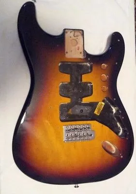

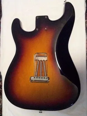

So, I'm buying Tele parts on ebay and I find a fender lonestar strat body.
It has the vintage fender trem, saddles, claw, springs and large steel trem block. Also the strap buttons. It has a beautiful 3 color sunburst finish too.
How in the heck am I NOT gonna buy it?
Are you kidding me....I'm not even done with the Tele and I have another project going.

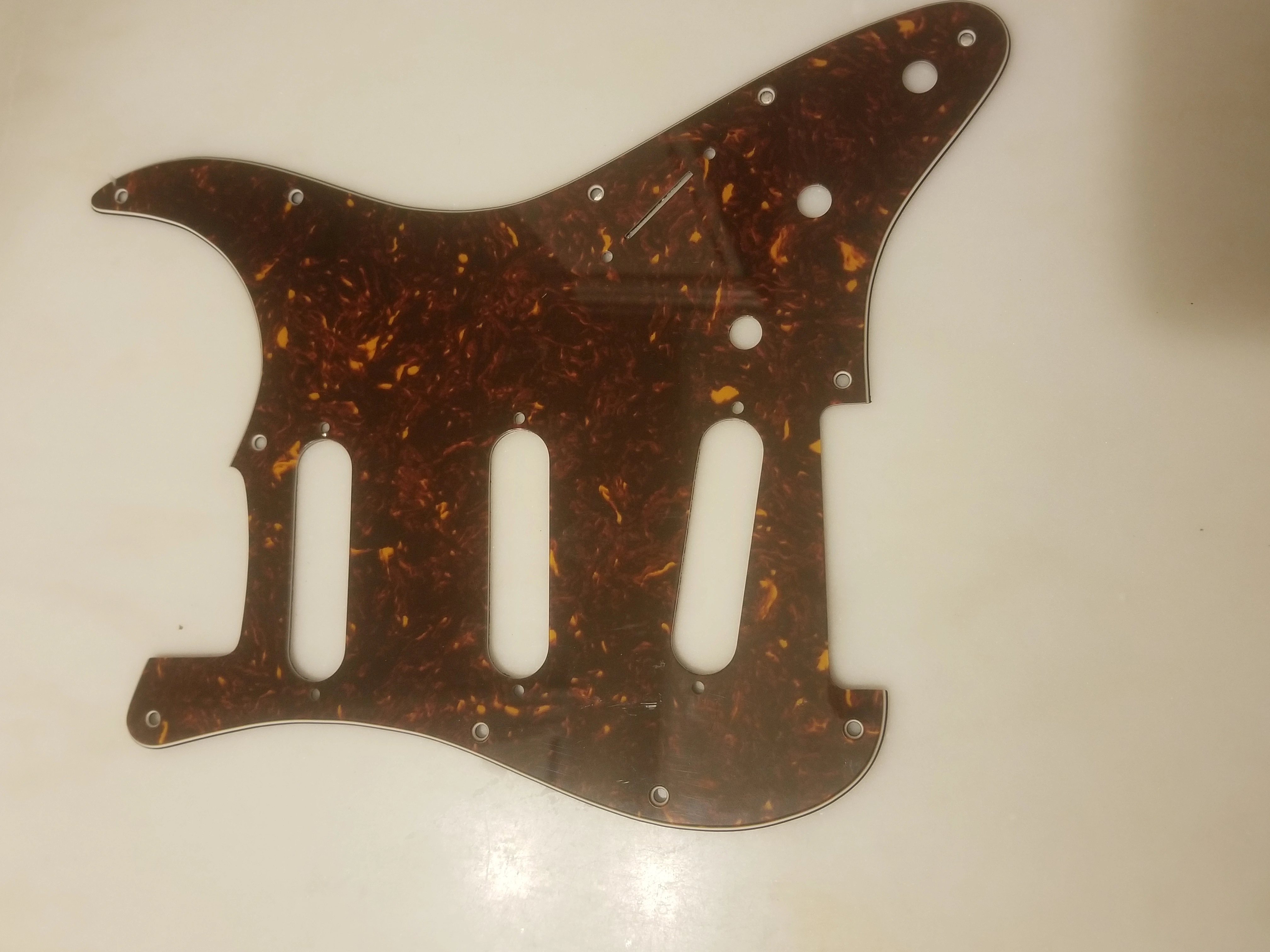

I bought a really cool tortoise shell pick guard. I have a tort guard on a vintage bass and this guard is almost the spitting image of that one.
It's REALLY hard to find a modern tort guard that looks likentge vintage stuff. The modern ones are really orange or really red or damn near black.
This one looks great so I bought it.
I bought a really cool tortoise shell pick guard. I have a tort guard on a vintage bass and this guard is very simular to that one...except the vintage bass guard is a red tort and this one is a brown.
It's REALLY hard to find a modern tort guard that looks like the vintage stuff. Most modern ones are really orange or really red or damn near black.
This one looks great, IMO, so I bought it.

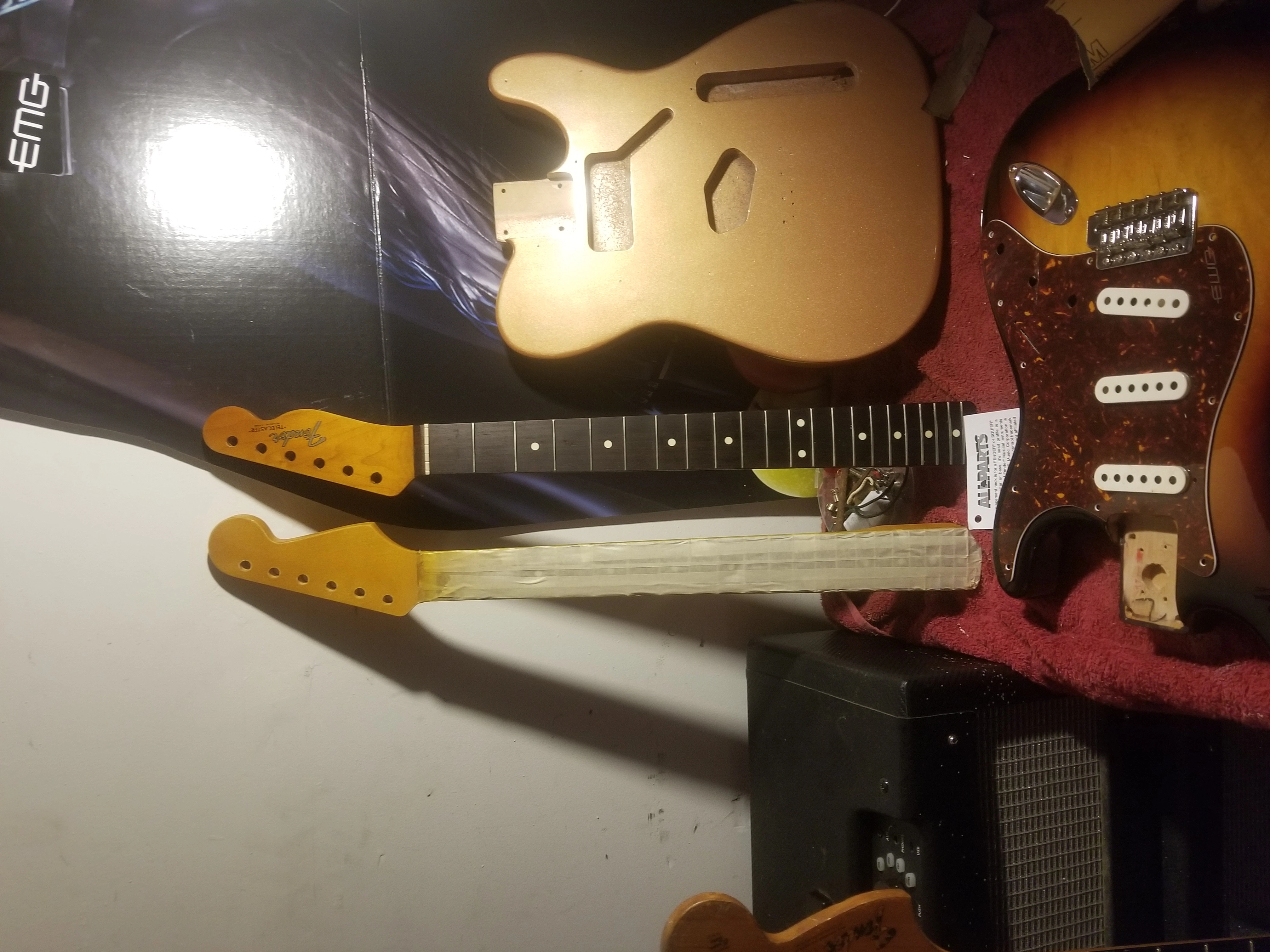

Here's a parts mock up of what I have in mind on the strat.

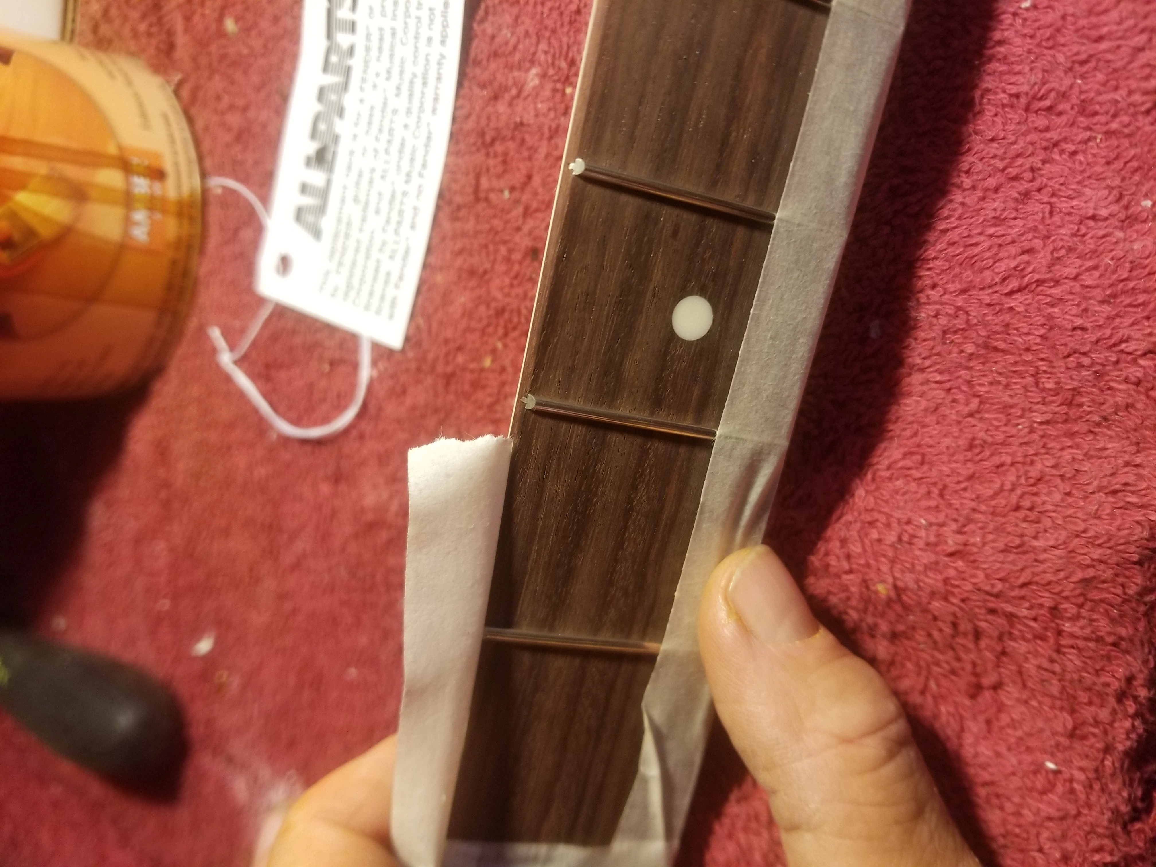

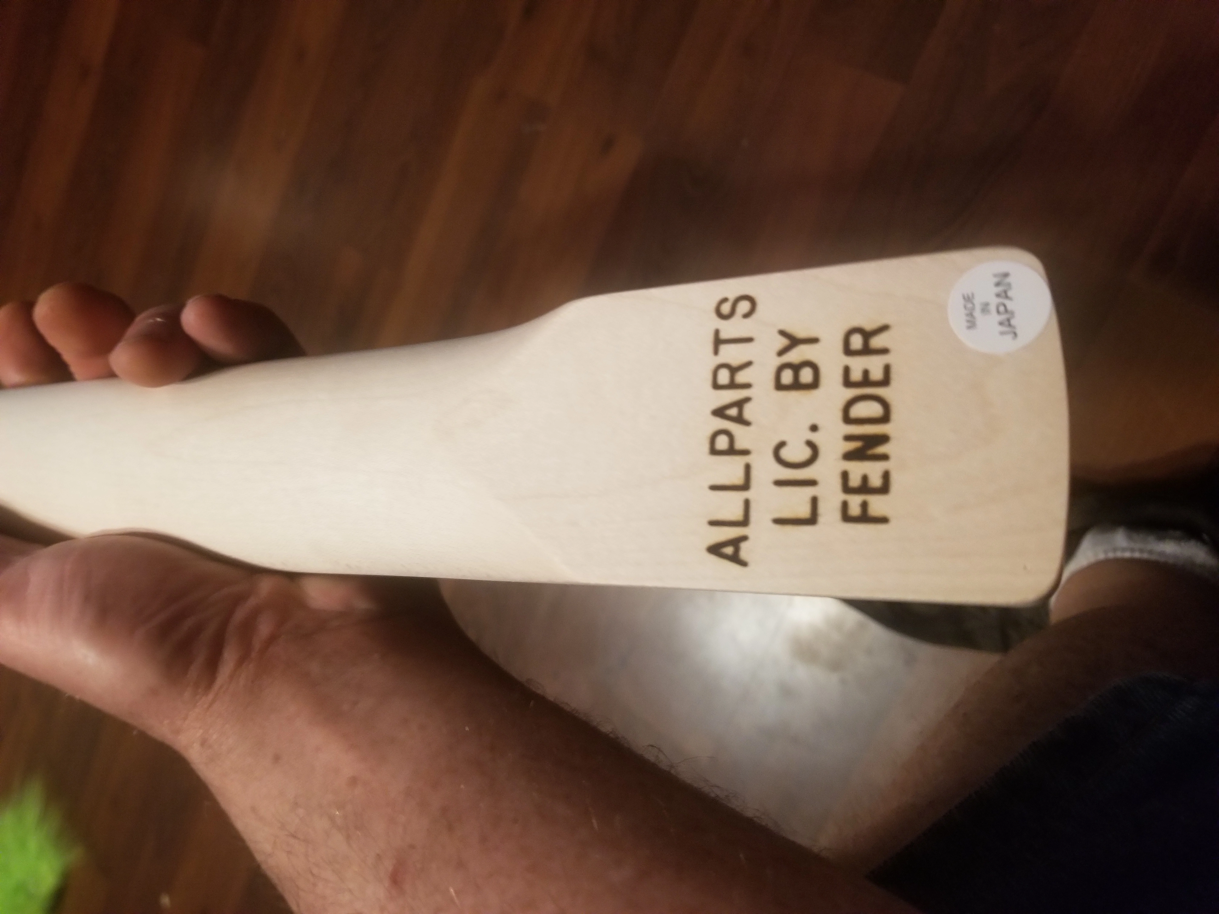

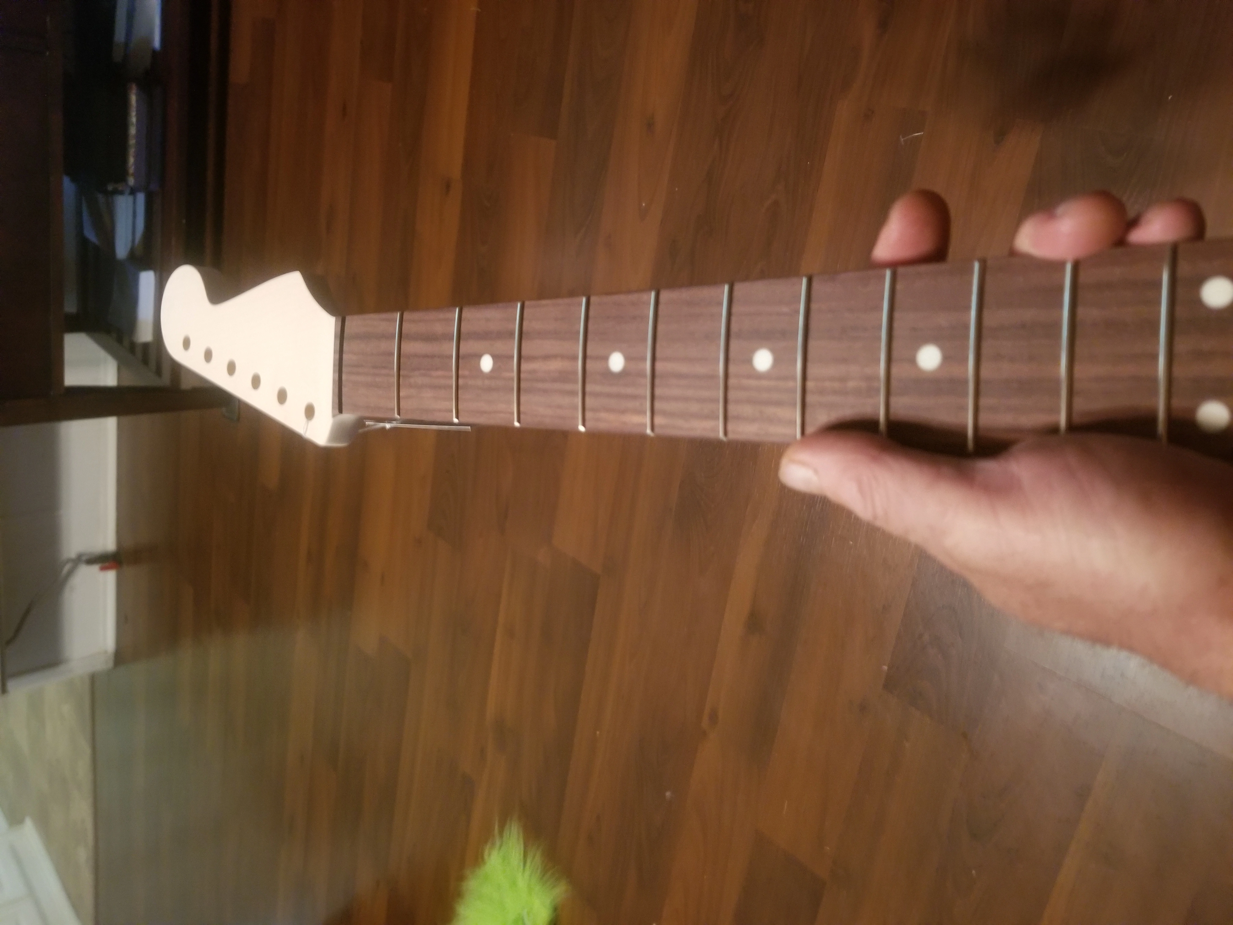

The neck for the strat arrived. It's a really nice allparts neck. Fine sanded and rready to finish.

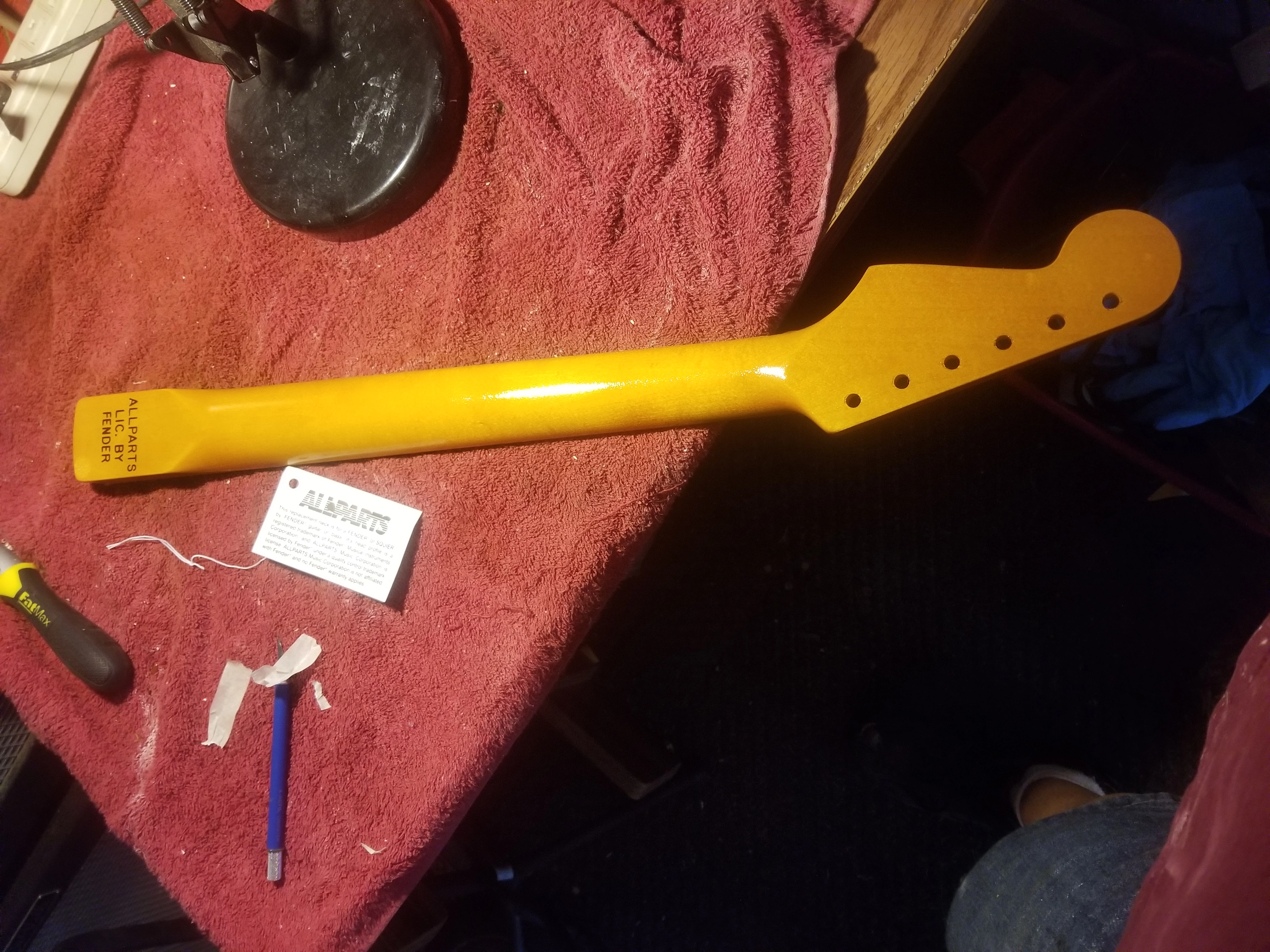

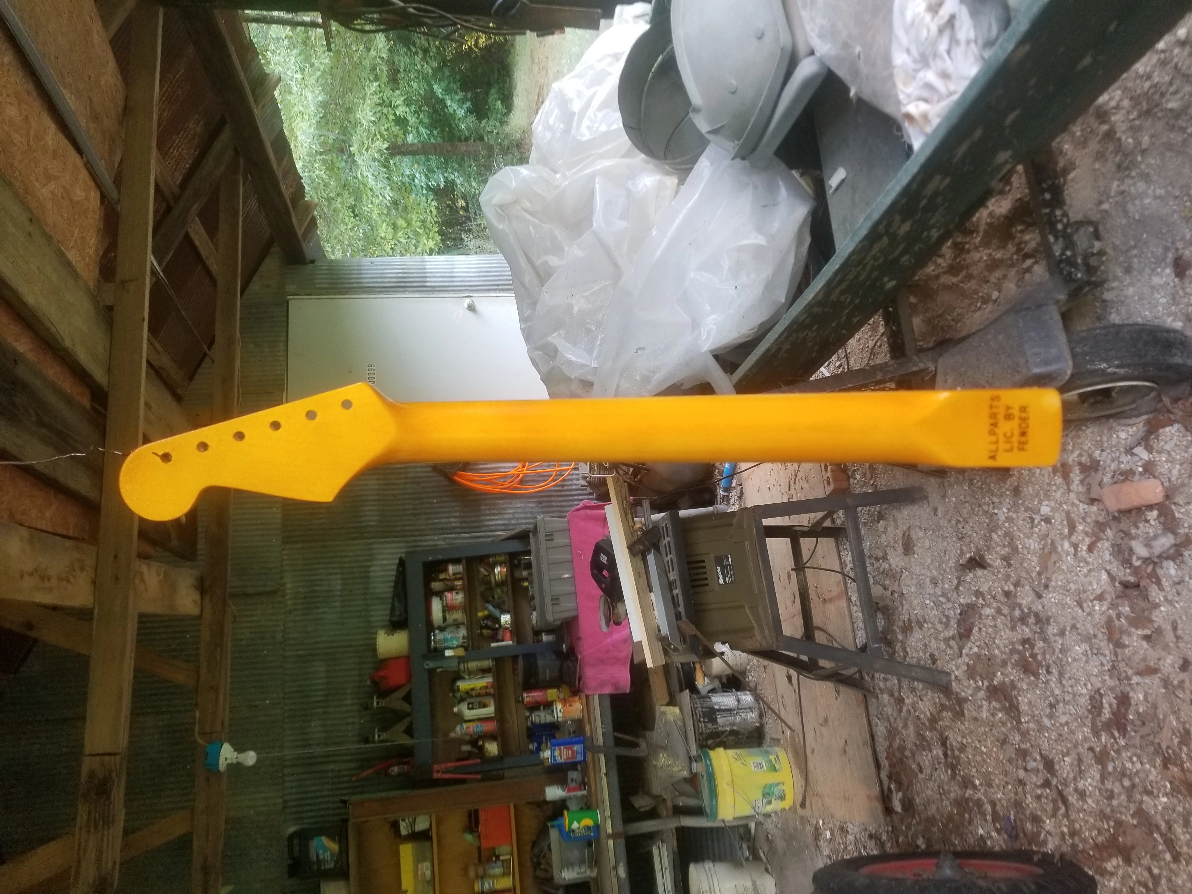

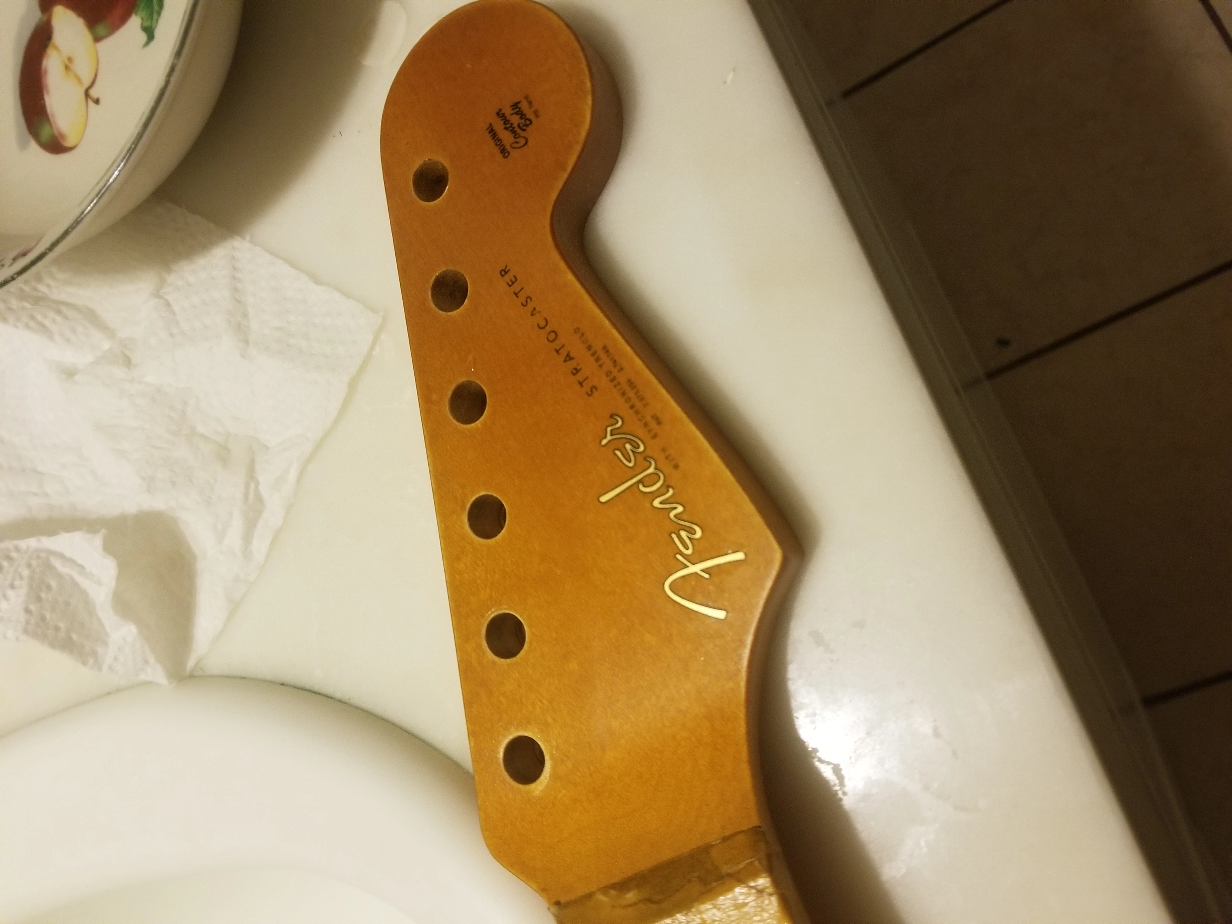

I went ahead and hit the neck with amber tinted shellac. When I get the color where I want it I will hit it will clear lacquer.
It's close to the same tint as the Tele neck I just did....maybe one more light pass will do it. After getting the tint right and lacquering it, I will darken the fretboard with the Old English scratch cover stuff.

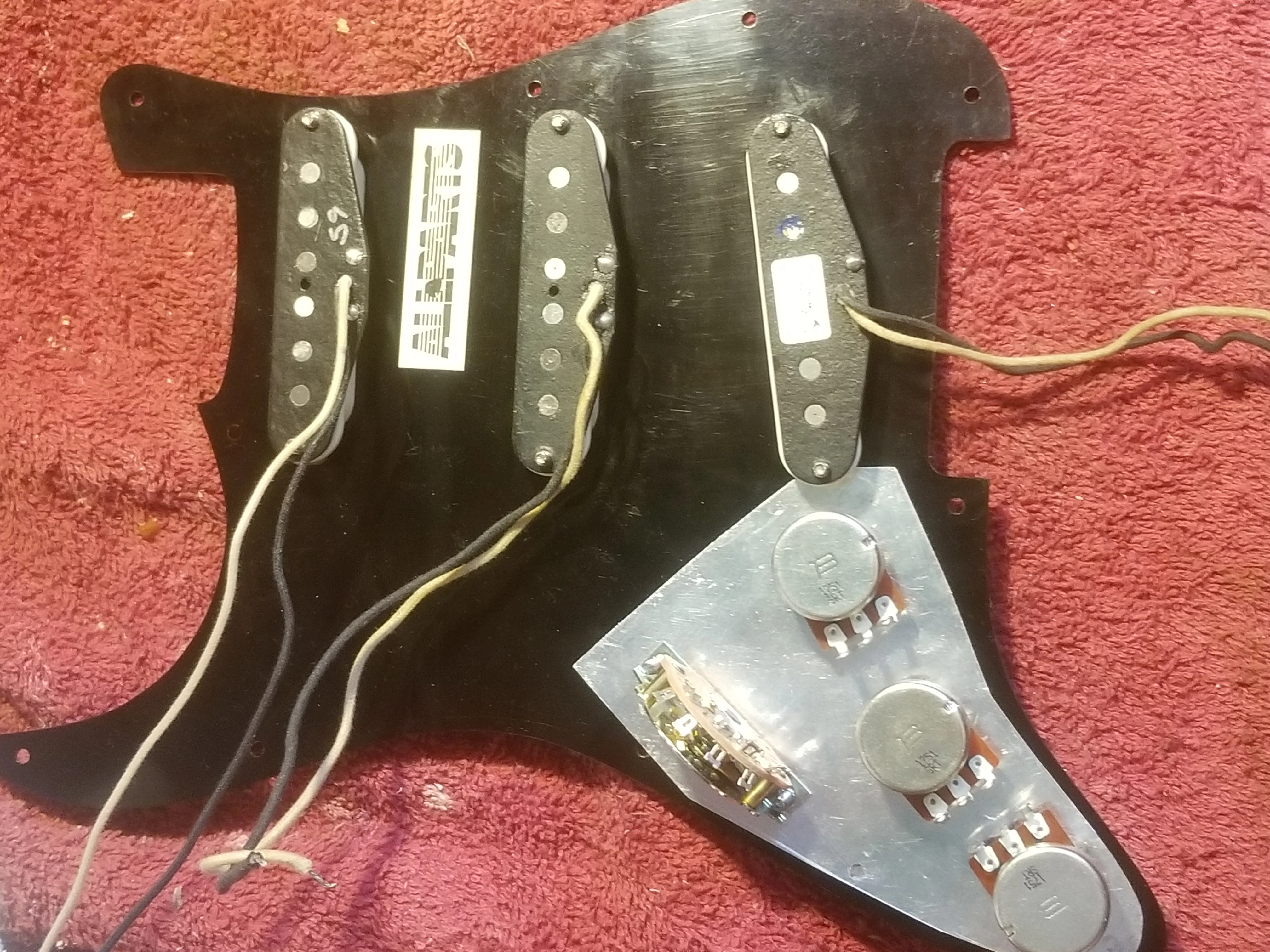

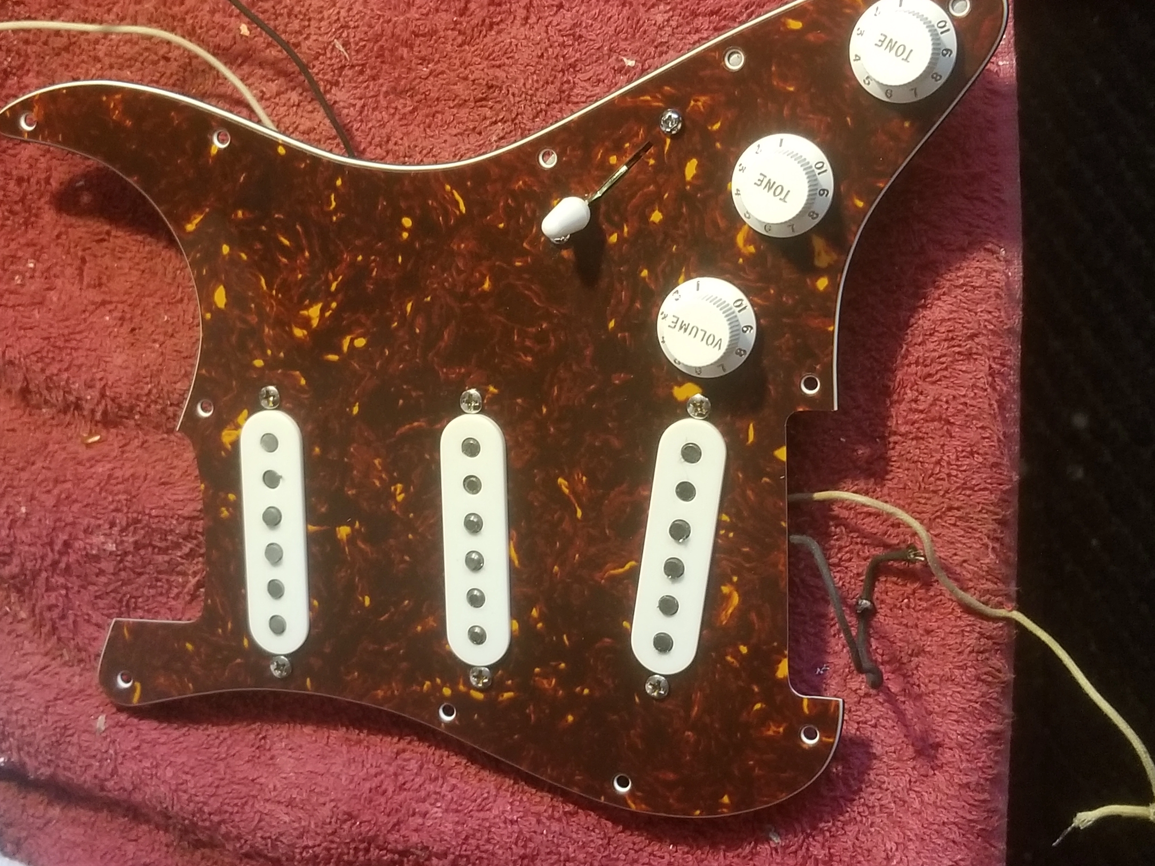

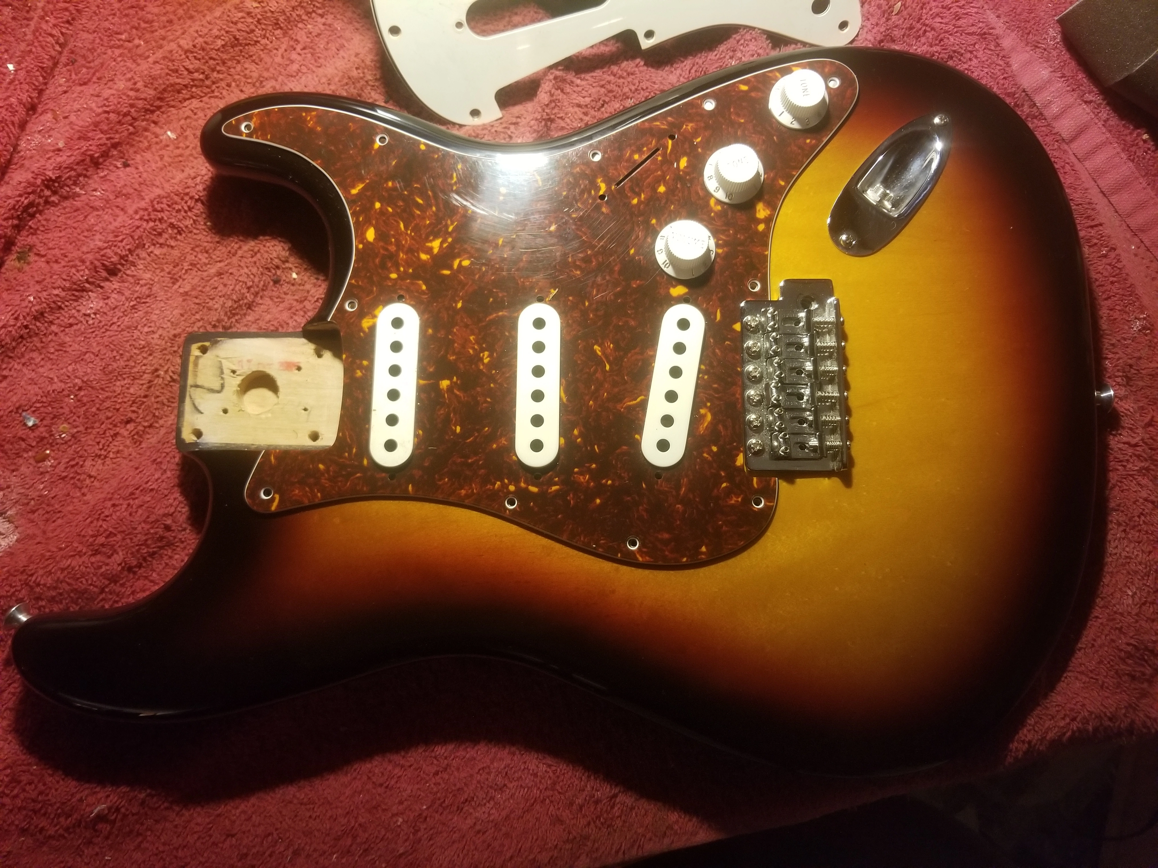

All components installed.

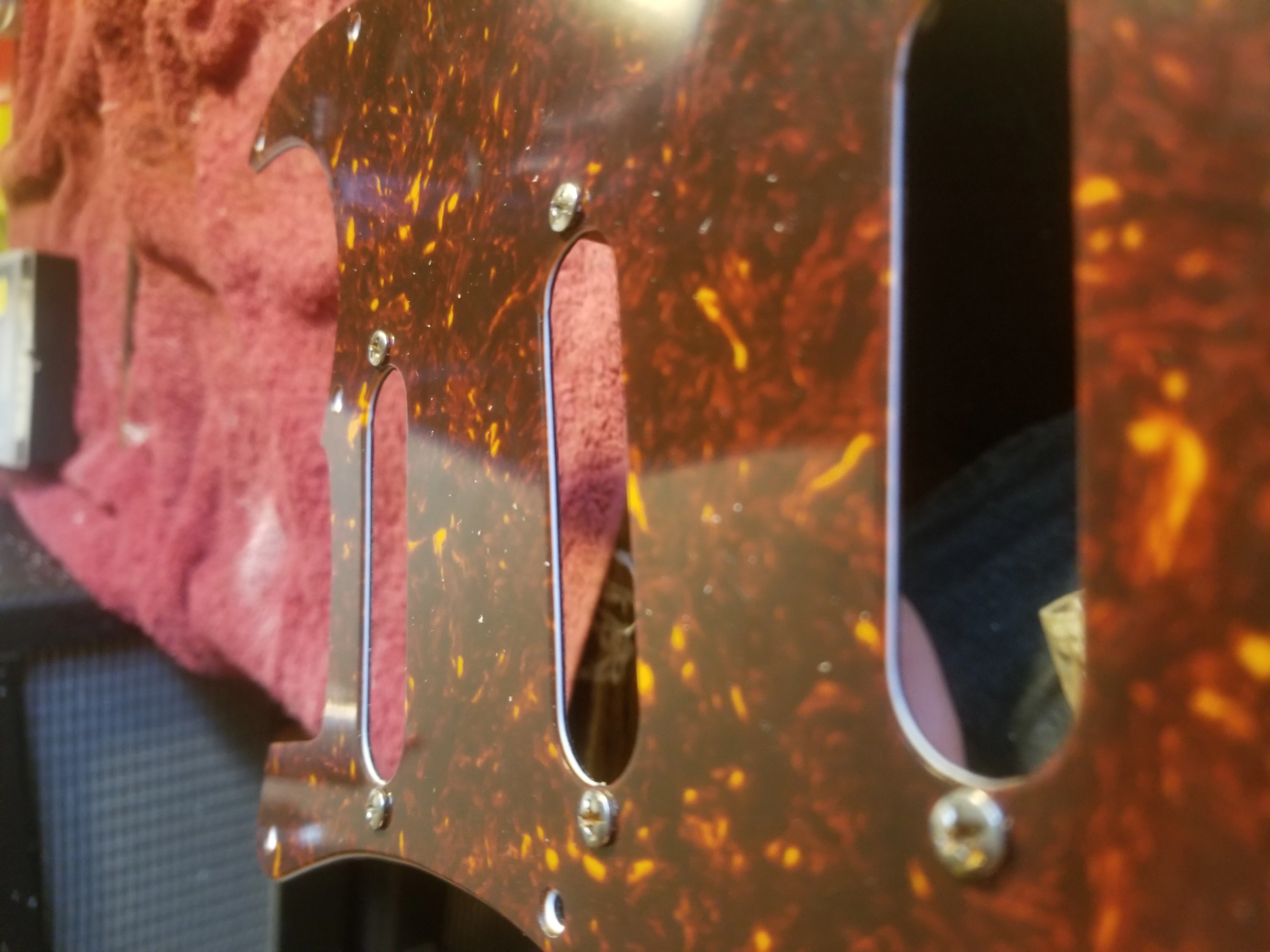

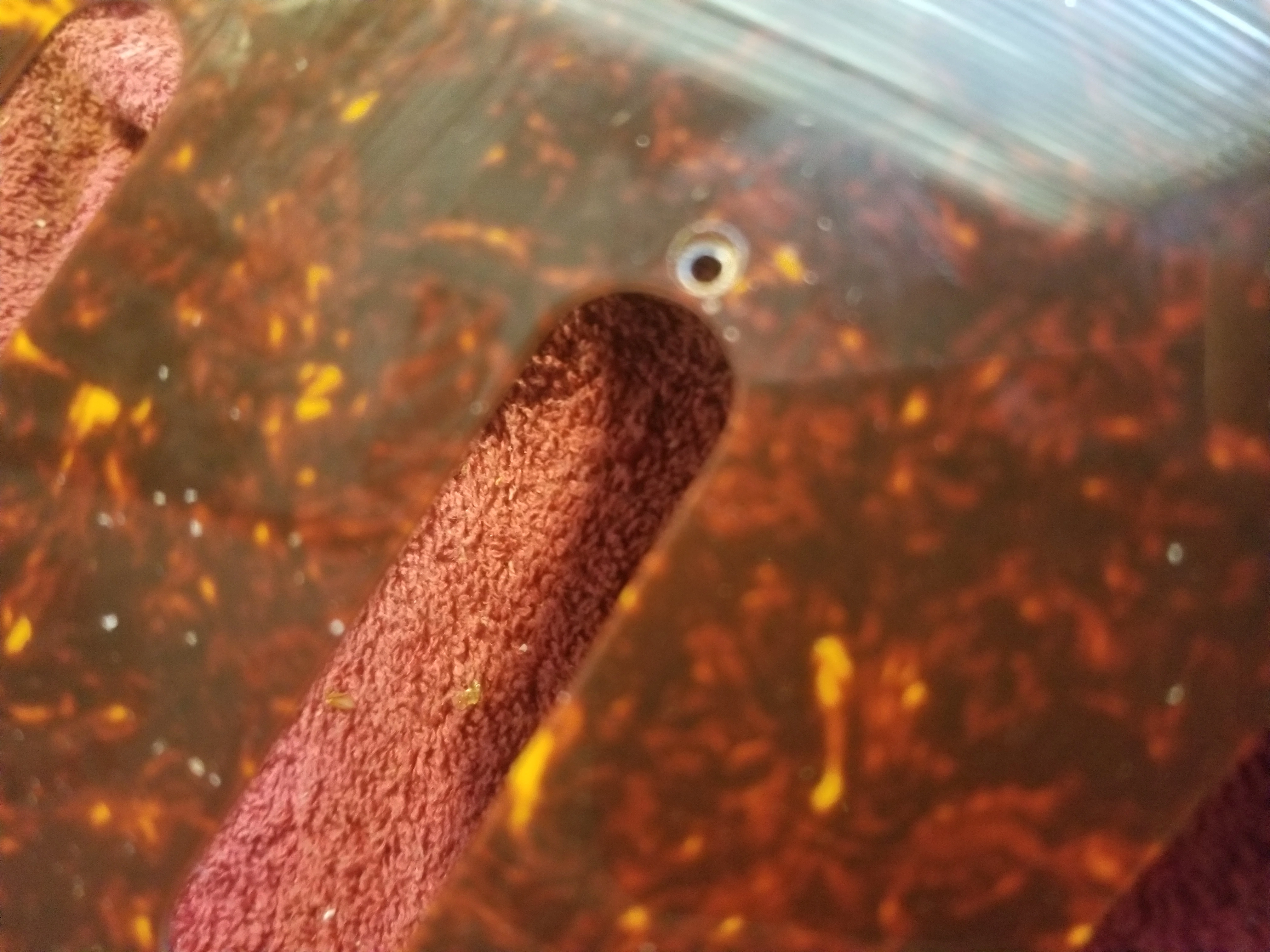

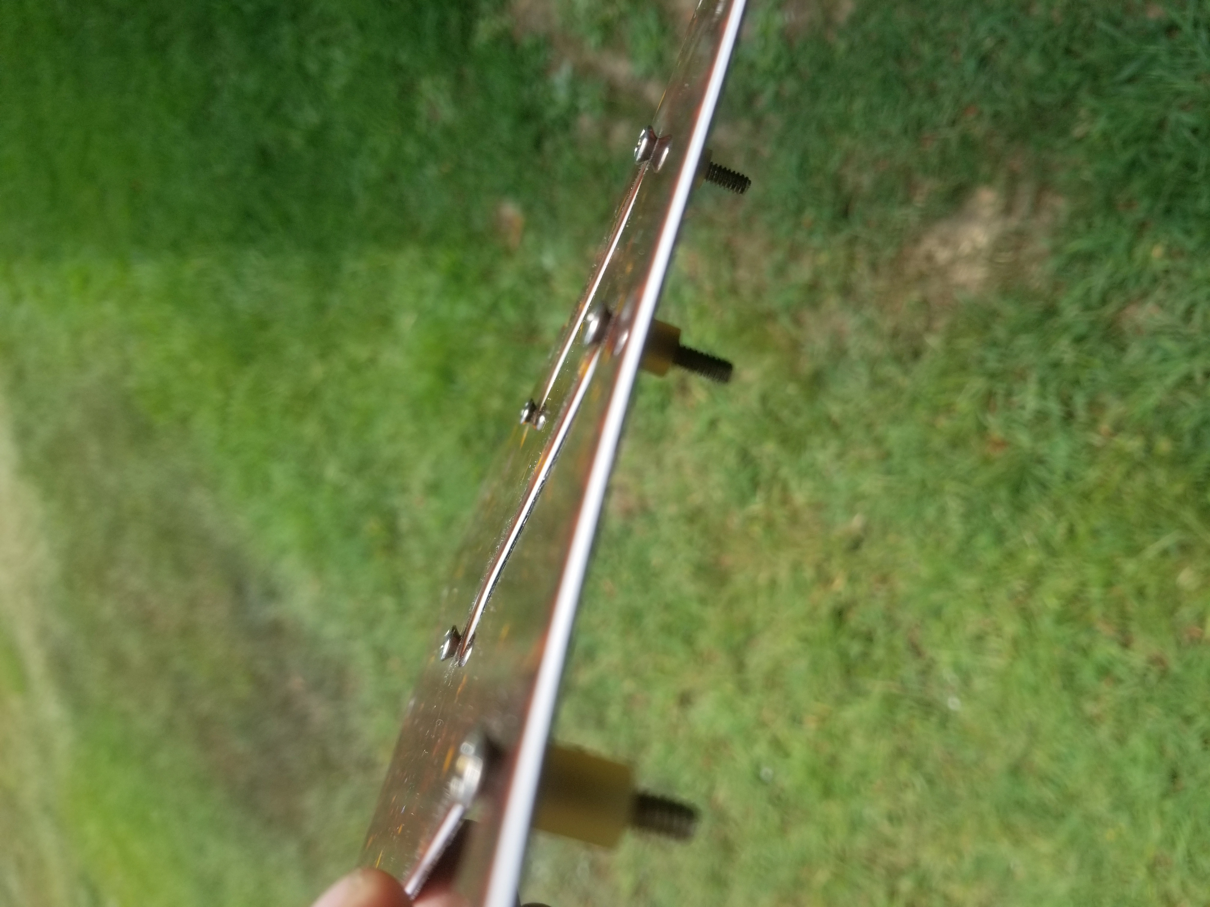

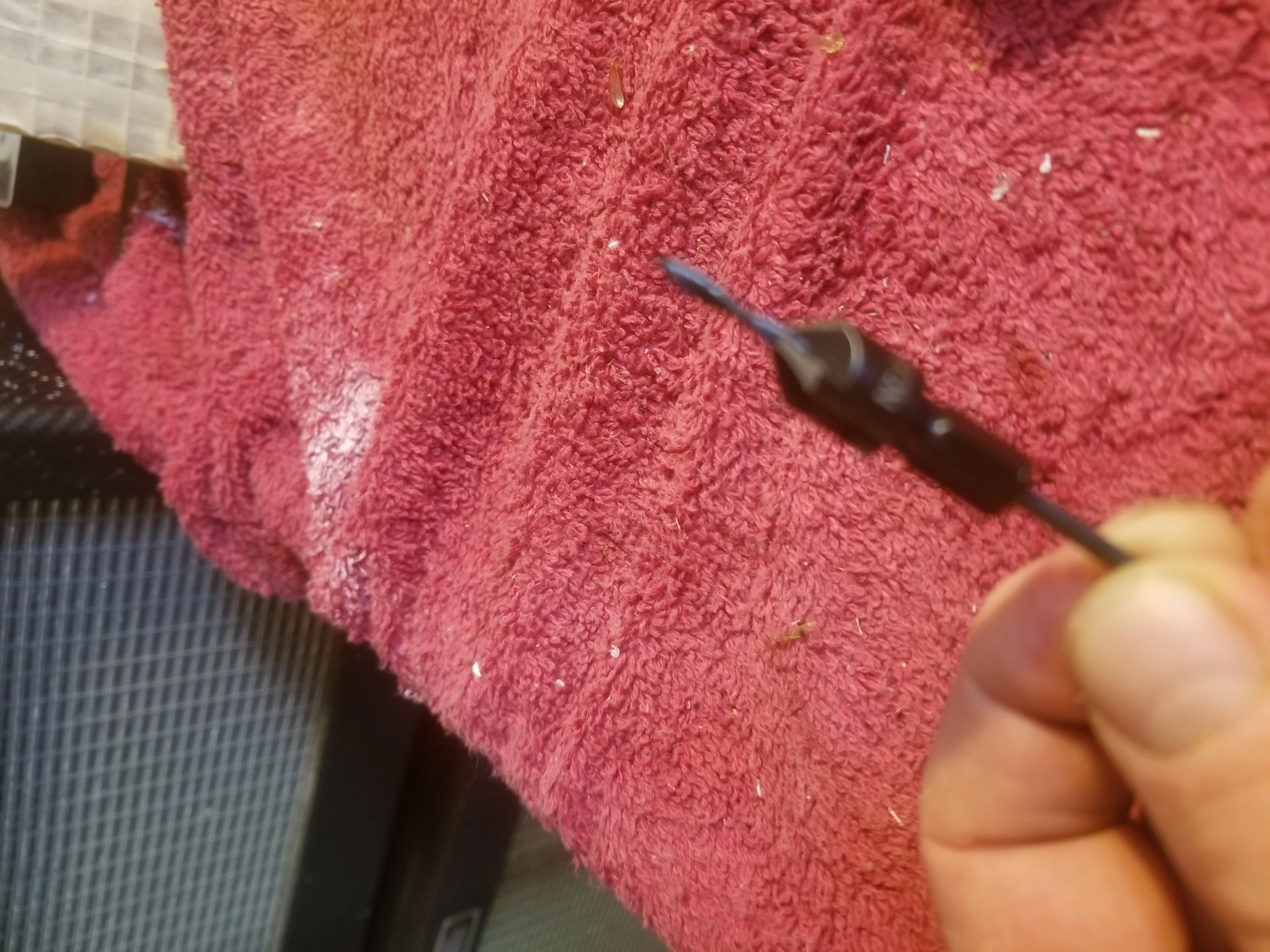

The pickguard pickup screw holes weren't beveled for the counter sunk pickup screws. I could have used flush screws, but the beveled ones look much better. So, I had to counter sink the holes myself. The bit for this cost $7.
looks nice now.

No junk under this pickguard....only the good shit!!

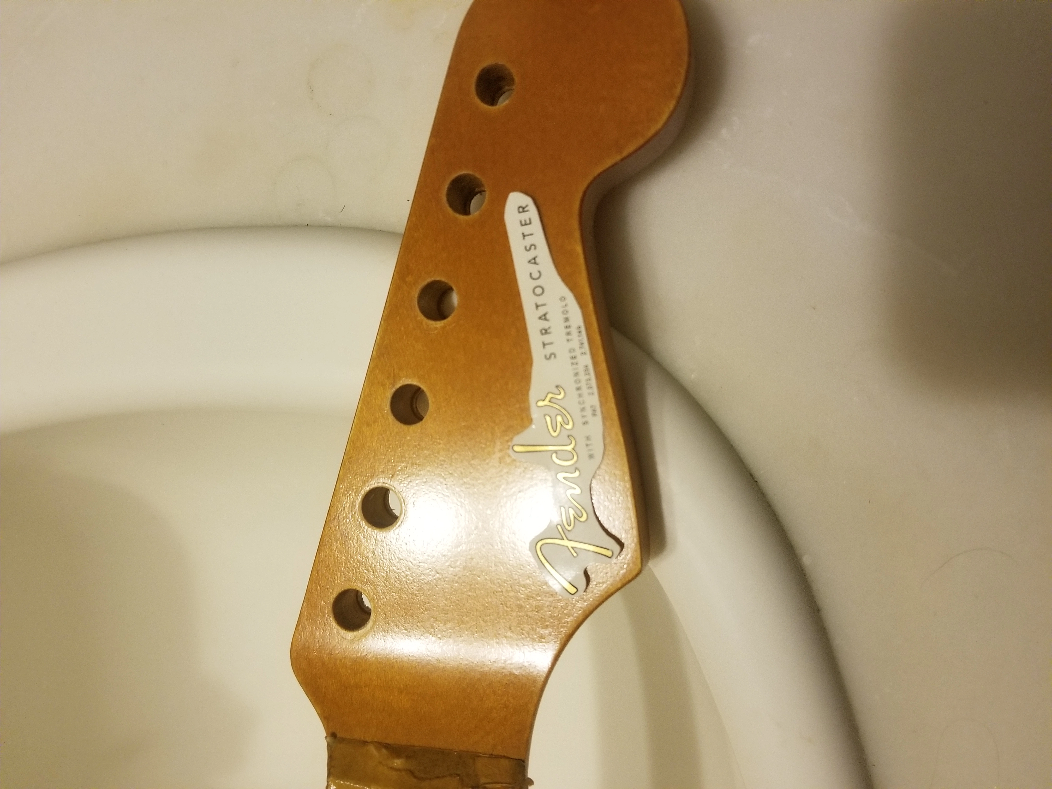

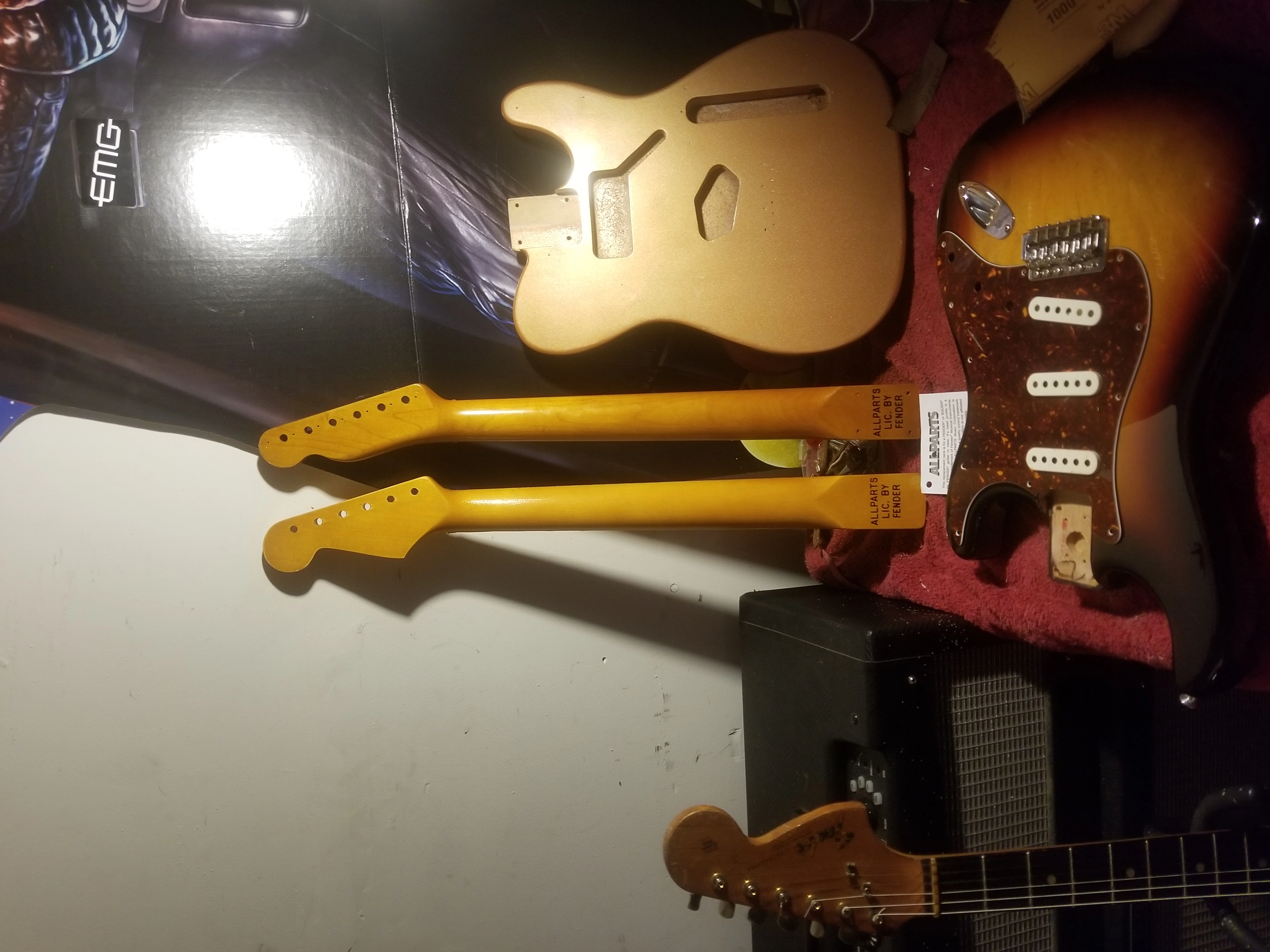

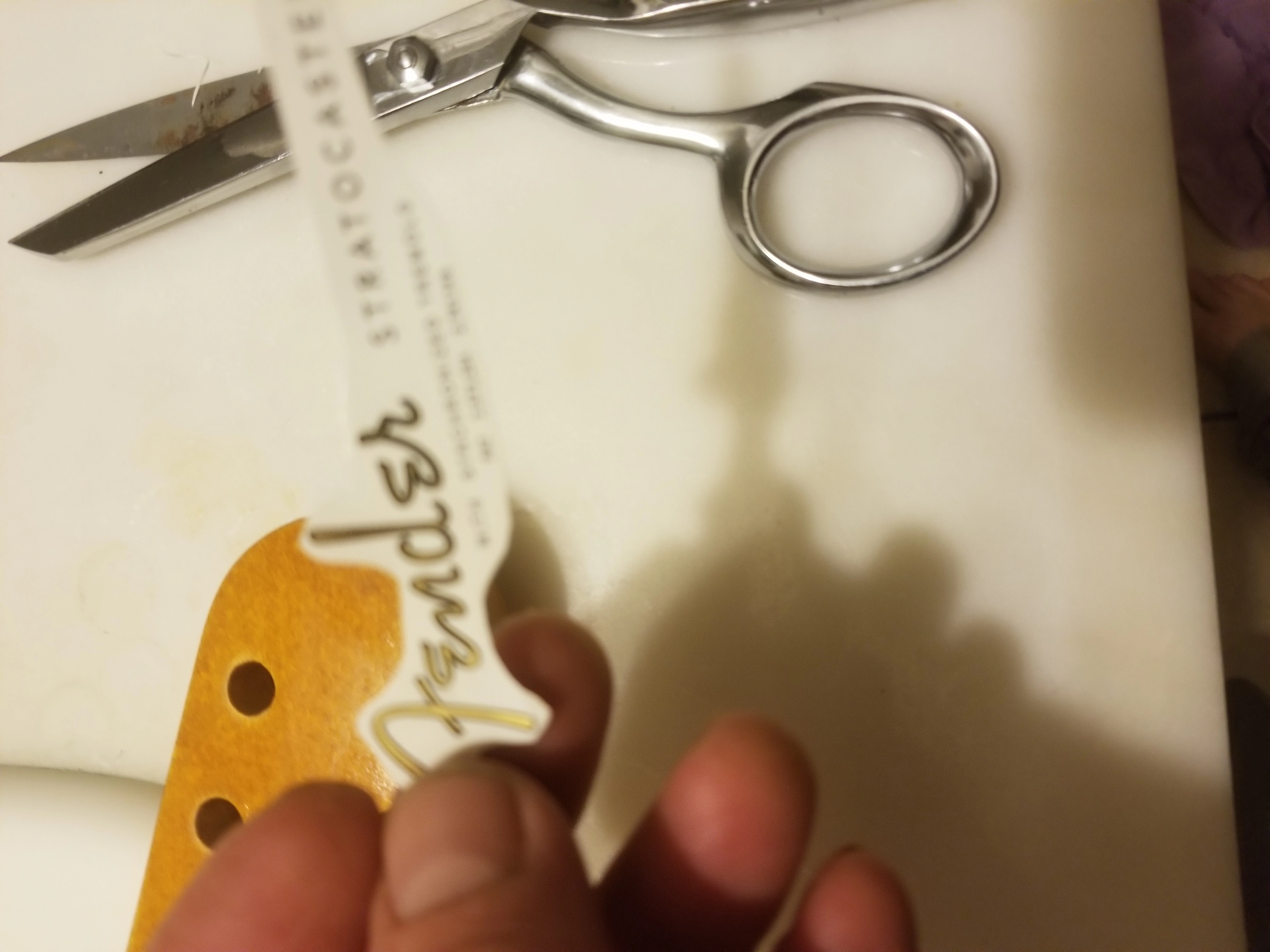

The neck was already sanded. I tinted it and clear coated it with nitro lacquer. Last night I put an early 6os strat decal on. A 1962 to be exact. A neck with the truss adjustment at the heel, and a laminate rosewood fretboard, would be '62.
Even though this strat is not a 62 clone in a few ways, it is done along the lines of a '62. If I ever decide to do a 62 clone I will already have a neck with the correct decal.
This vender's decals are the best!!!
light years ahead of the rest of the decal pack!
