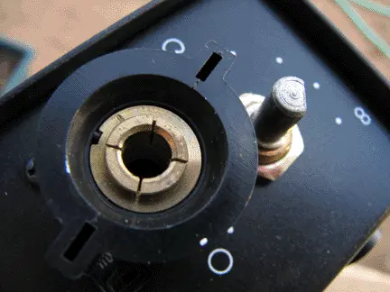

Mine doesn't. No biggee, but although it switches through the detentes, when it gets to either end of the switch rotation the knob keeps turning. I don't see a set screw - when I get a chance I'll pull it off and wedge some toilet paper in there.
Probably means the whole pot is turning, not the knob. I can't imagine any way a splined knob could spin on the shaft. Pull off the knob and tighten the nut more and it should fix the problem.
No, it's the knob turning on the shaft. The knob has a brass split pressure insert (smooth interior), and the switch shaft has a flat for a set screw. But for $95, if that's all that's wrong, it's still a great bargain.
Oh. I assumed they used a splined nut/pot since you couldn't find a set screw. Dunno. Both of mine slip if I push them hard enough past their limits, but they don't slip easily, so it's not a big deal.
