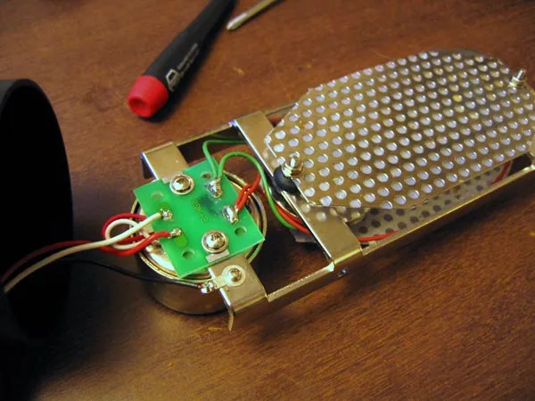

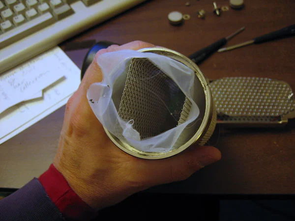

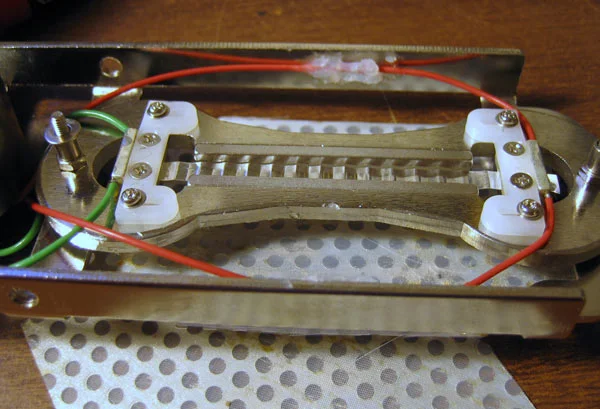

Hi All
I pulled apart my ACM-1 to get a look at the ribbon. First time I've had a ribbon mic, but from what I have seen/heard/read it looks fine--no sag, no flopping. As a matter of fact, I couldn't induce any untoward movement at all. So that's good, at least to my untrained eye.
The layers of mesh/screen/grater/silk in this thing are quite elaborate! They look like this, outside going in:
1. Exterior basket of screen, backed with finer mesh.
2. Silk
3. Rectilinear sheet of screening (matches exterior)
4. Heavier grill of cheese grater-like material with silk attached to back.
5. Ribbon
The PCB is interesting, if only for how it's labeled.
I've attached some photos of what I saw--sorry about the color rendition, I tried to balance it but it was hard--multiple light sources of differing color temps...

Well sun of a gun. That ribbon is adjustable! :D
That is also a very easy to upgrade transformer. Cinemag makes one that is practically drop-in.
Also, a popular mod with that type of ribbon is to leave those inner plate grills that bolt onto the ribbon assy out.
You just have to be a bit more careful with it.
Could that same system be incorporated in the other ribbons? Or is there not enough real estate.
Yeah, great pic of the slots that allow the ribbon clamp platforms to slide fore / aft to adjust tension!
Thanks, I thought that's what I was looking at, but didn't want to hazard a public guess.
Yes, it would be nice if similar systems were in all of these. There certainly is a lot of room to roam in the head of the ACM-1, though, so maybe not possible(?). Must be possible to downsize the system for other spaces...
I could see doing something like that, maybe replacing the plate with just a frame of the same size that has some silk stretched across it, as a compromise.
