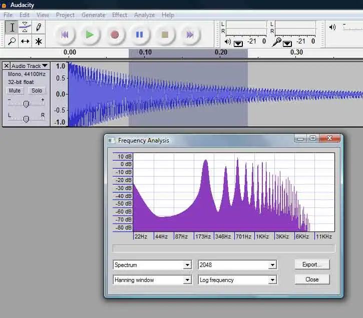

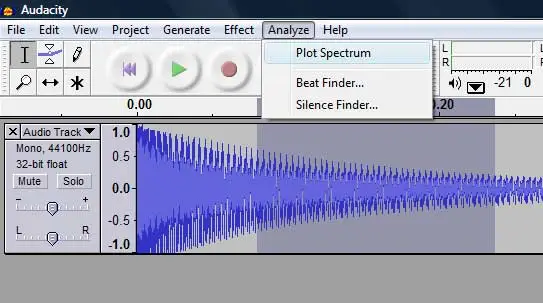

I know you guys have a lot going on with trying to fix these pre's and all, but could someone post details or post where I can find the details on how to test my 73's and 84's for the hum issues? I see all these frequency graphs and things you guys are posting and I have no clue of how to do this. I have a friend who can handle doing the work on them, good with electronics and such....but I need to know how to test them to show him what I want fixed. Iv had mine for over a week now and have not even hooked up the pres, just kinda sitting back and waiting till someone finds a fix for them...
Well, you can just fire them up and hear the hum/buzz and tell him that's what you want fixed.
Or you can look in your recording software and see if it has a FFT function (fast fourier transform.) This will plot the amplitude versus frequency of a sampled track. You record the output of the preamp with nothing hooked up to it (in theory with 100-200ohms of impedance across pins 2 and 3 of the mic input - I just shorted them together). Then use the FFT filter to plot the graph. I'm sure you can get software just to do this alone too.
I have a free recording program http://audacity.sourceforge.net/ that has a FFT filter (called Analyze->Plot Spectrum) that I used for this.
