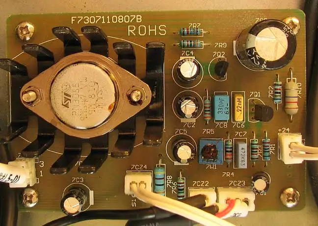

whoa what the heck is this? I smelled something, opened up the case, and found this:
now, everything is fine, its working:

Given the size and value, I'd guess that's somewhere in the power supply, perhaps between filter caps or something. I would replace that with the same rating, or perhaps higher seeing what happened to it . . . 1W at least . . .

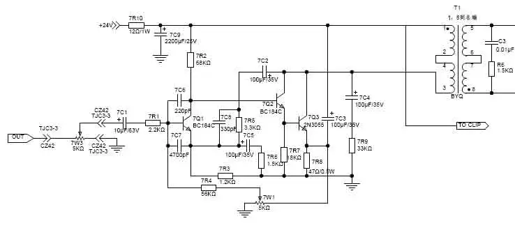

That's the emitter resistor for the output stage power transistor (2N3055) - I wouldn't run the unit like that, or you risk blowing the transistor and possibly other components. I don't know why it blew, unless something upstream biased the transistor on too hard. Maybe 0.5W isn't robust enough, try a higher wattage (though that risks blowing something upstream if there's a problem there). Here's the germain part of the schematic:

Probably - try a 1watt 47ohm resistor. If they don't have a 1watt one, you can try a 1/2 watt one again, or piggyback two 100ohm ones in parallel. Can you solder? If so, you can either remove the old one and replace it, or cut it off its leads and solder the new one to the remaining leads (don't have to remove the pc board that way.)
Is 7W1 a trimpot? That would seem to set bias for the output stage . . . dunno what it is supposed to be though . . . jason, while you're at Rat Shack, pick up their $14 multimeter. Once you replace the resistor (or before), measure the voltage across it. If that's much more than 4V, then the resistor's rating is exceeded (4V^2/47=0.34W). 7W1 probably would need to be adjusted until that is a safe reading, but I'd wait for more expert confirmation before you go screwing with it . . .
Yes. It's factory adjusted with a drop of glue (whatever "factory adjusted" would mean in this case. :D)

Since the resistor problem seems to be related to the pop problem on the switch, this could be a reliability problem with every unit. Resistors take time to heat up, even if their rating is exceeded, so it would be best to switch past the pop as quickly as possible. It would also be good to replace the part with 1W or even higher. If anyone is brave (and has appropriate safety equipment . . . glasses and an extinguisher handy!), you could measure the voltage with the switch held in the pop/buzz position, that would give you an idea of how much power is being dissipated. The secondary problem is that current might stress other components as well. Hopefully somebody at prodigy can comment on that.
The issue of whether bias was truly set is interesting. Obviously, if your unit had a power connector that was not connected, how did they set bias? It's possible to order trimpots set at a particular value from the factory, so maybe that's what they did?
