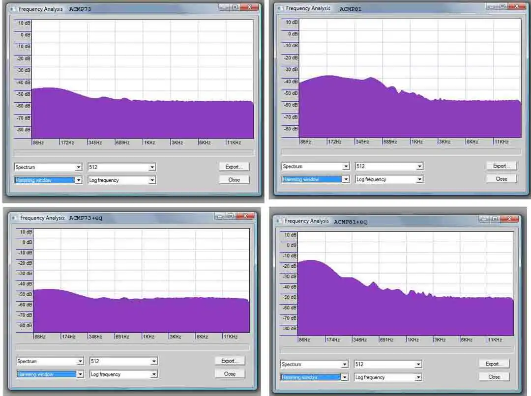

I got my 4 pres out of their boxes this afternoon (3 81's and a 73). A brief report:
ACMP81 #1 After spending an hour wondering why I was such a dumb shit that I couldn't get a signal into my interface, swapping mics, cables, punching and repunching all the buttons, I swapped it for ACMP81 #2, which worked fine. So #1, though all the lights and clipping indicators work, is not producing a signal at output.
ACMP81 #2 The best of the 81's - has the eq buzz, but that was expected. Noise floor is like the 73, not great but acceptable at this point.
ACMP81 #3 Very high noise floor, and has the buzzies. The worst of the two that work.
ACMP73 No real issues. Noise at high gain, to be expected. No buzz perceptible.
Here are spectrograms of the bad 81, and the 73, with mic inputs shorted pins 2 and 3, input and output gains at max. First without eq, second with eq engaged but all set to off. (My interface noise, with the units turned off but same setup, is below the -90dB threshold of the spectrograms, except where it rises to about -85dB below 200 Hz.)
I'm not too happy, but I knew what I was getting in to. C'est la vie. :)
Anyway, thanks to chance for the opportunity. I still have hopes for the mics.

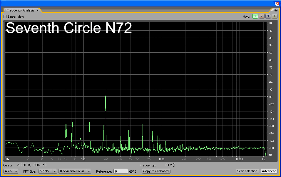

Crazydoc, you should change the FFT size (where it says "512") to the highest number it'll allow. The way you have it is pretty useless to find the true noise floor. There's too much averaging going on at 512.
Also your noise floor is WAY higher than I measured. What gain / output did you have the pre's set to? The following measurements are with gain all the way down, and output all the way up.
This is what I got: (using a SCA N72 as a control preamp to compare to)
Note: scale does not go all the way up to 0dB.
Green line = no EQ
Pink line = EQ engaged
