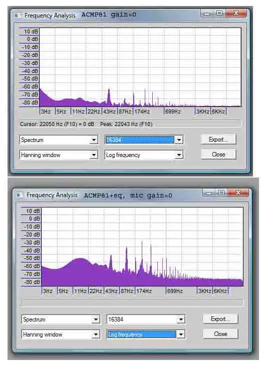

Crazydoc, you should change the FFT size (where it says "512") to the highest number it'll allow. The way you have it is pretty useless to find the true noise floor. There's too much averaging going on at 512.
Also your noise floor is WAY higher than I measured. What gain / output did you have the pre's set to? The following measurements are with gain all the way down, and output all the way up.
Mine were done (as I mentioned in my post) with the mic gain maxed (80dB), to show the worst case noise scenario.
Here's the noisy 81 with mic gain at 0, with and without eq engaged, with the FFT sampling length at the max my free (Audacity) software will allow. Unfortunately it doesn't resolve below -90dB.

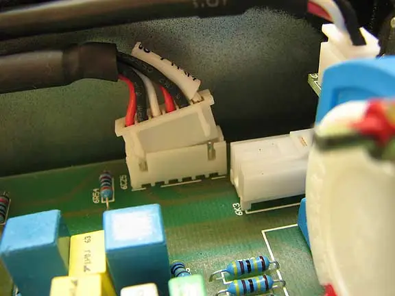

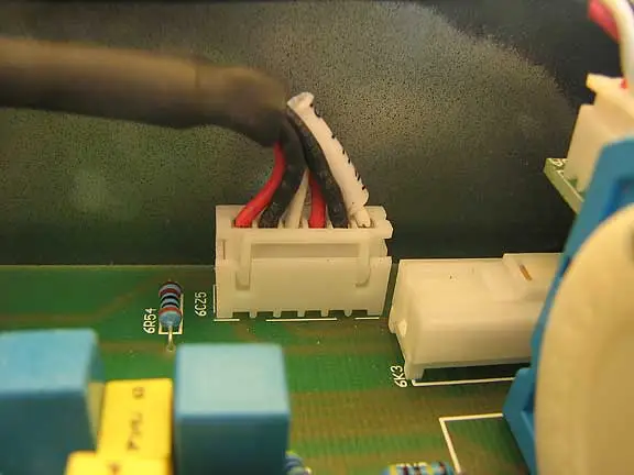

It took me 30 seconds after I popped the lid to find the problem with my no-output 81.
5 seconds later. Works as well any any of them now (not to say a lot.)
Doesn't say much for QC either. :D (I doubt this happened in transit.)

LOL! That, along with the dented Grills on the AVM-1200s, really sums up our quality control issues! Even visually obvious flaws went unattended... much less sonic ones, which would require, you know... advanced skills like listening!
