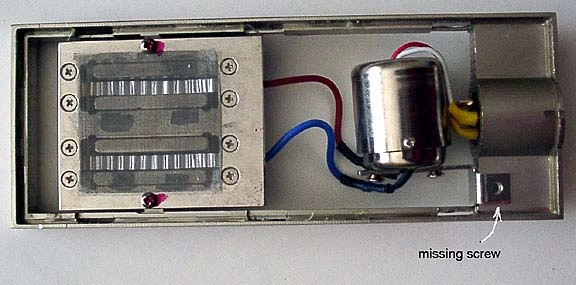

Thanks a million, chance. I am happy as a pig in shit with the mics, and well worth twice the money, so don't get me wrong, but the build quality on the HRM 14 leaves a lot to be desired.
Mine had a rattle when I opened it - screw loose inside. I took the mic apart and put the screw back (transformer mount.) But the upper and lower front and back panels, which are supposed to snap in, were glued in with contact cement, and one of the snap lugs was broken off.
I made some slight modifications and it all fits together well now, but mechanically this may not be a long lasting mic.

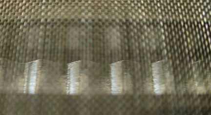

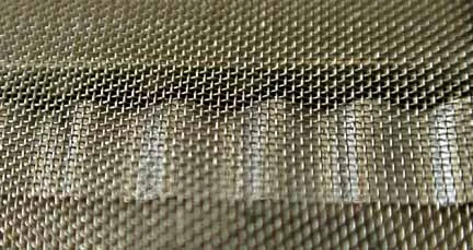

On another note - front versus back.
I don't know which is supposed to be which, but the two sides of the HRM 14 differ in the ribbon depth between the magnets. One side is several mm closer to the surface than the other, so I expect there will be differing frequency responses from the two sides.

Can you E-mail me that photo with the missing screw? I want to send this data back to China. It will help (for leverage) on the next buy.
