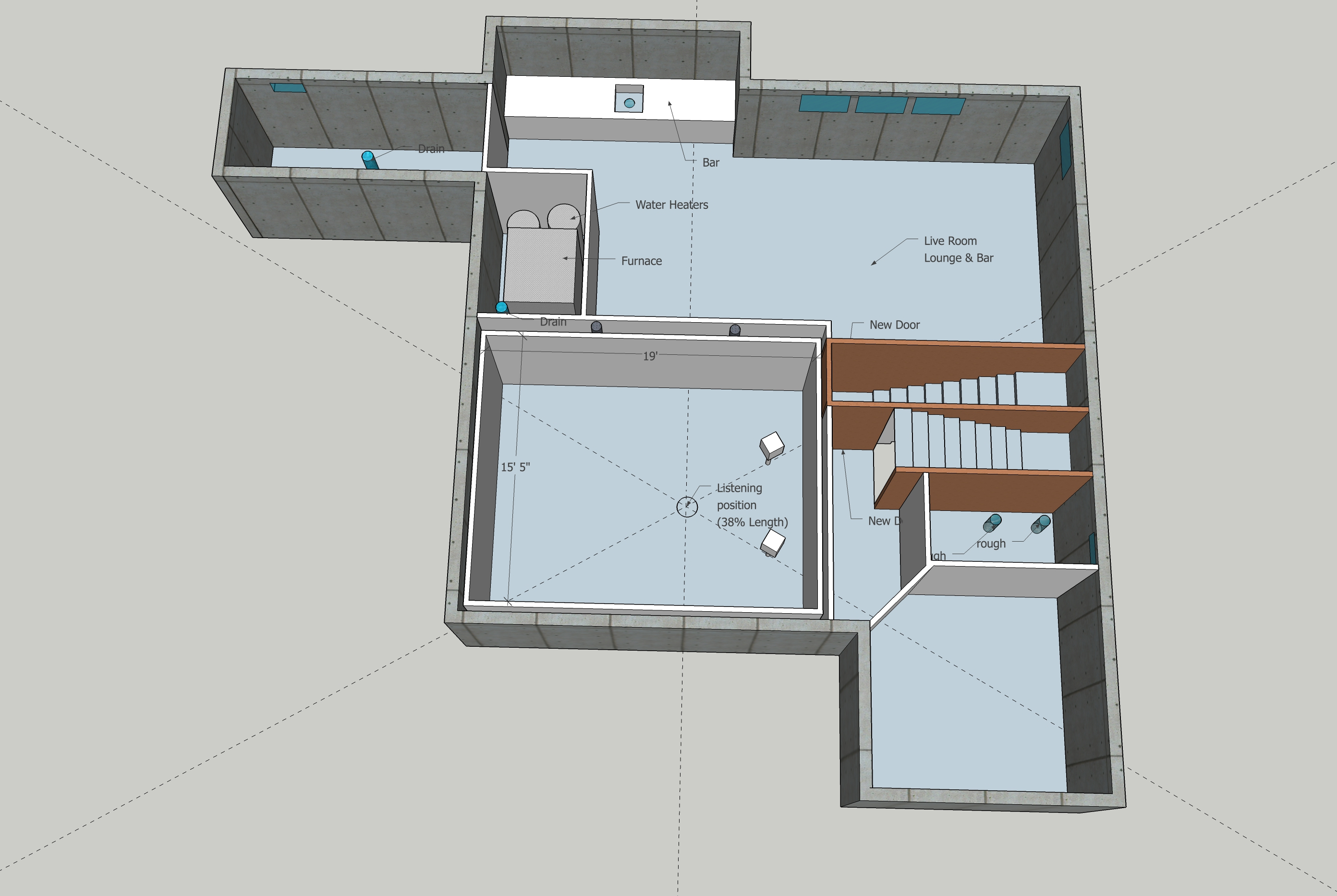

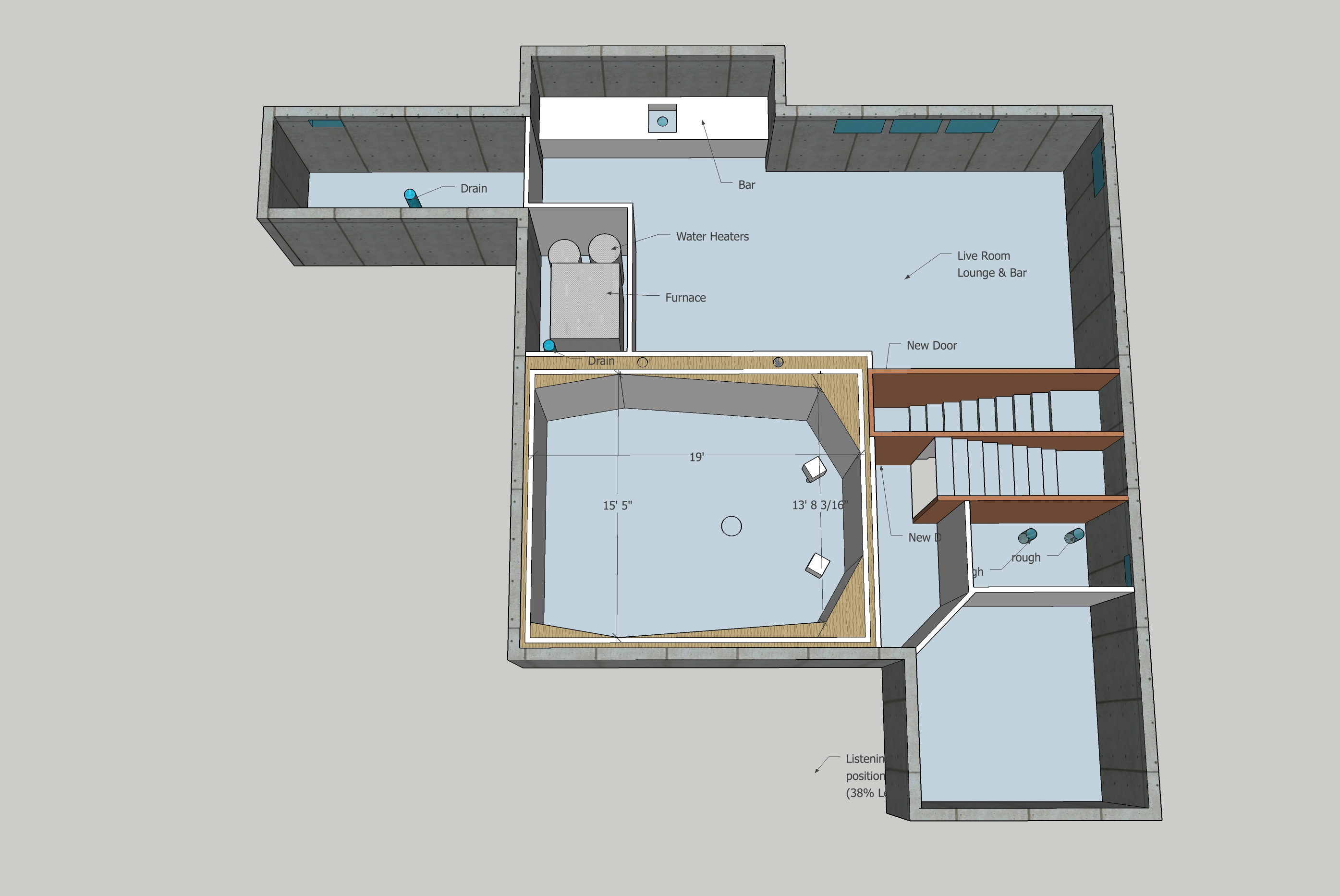

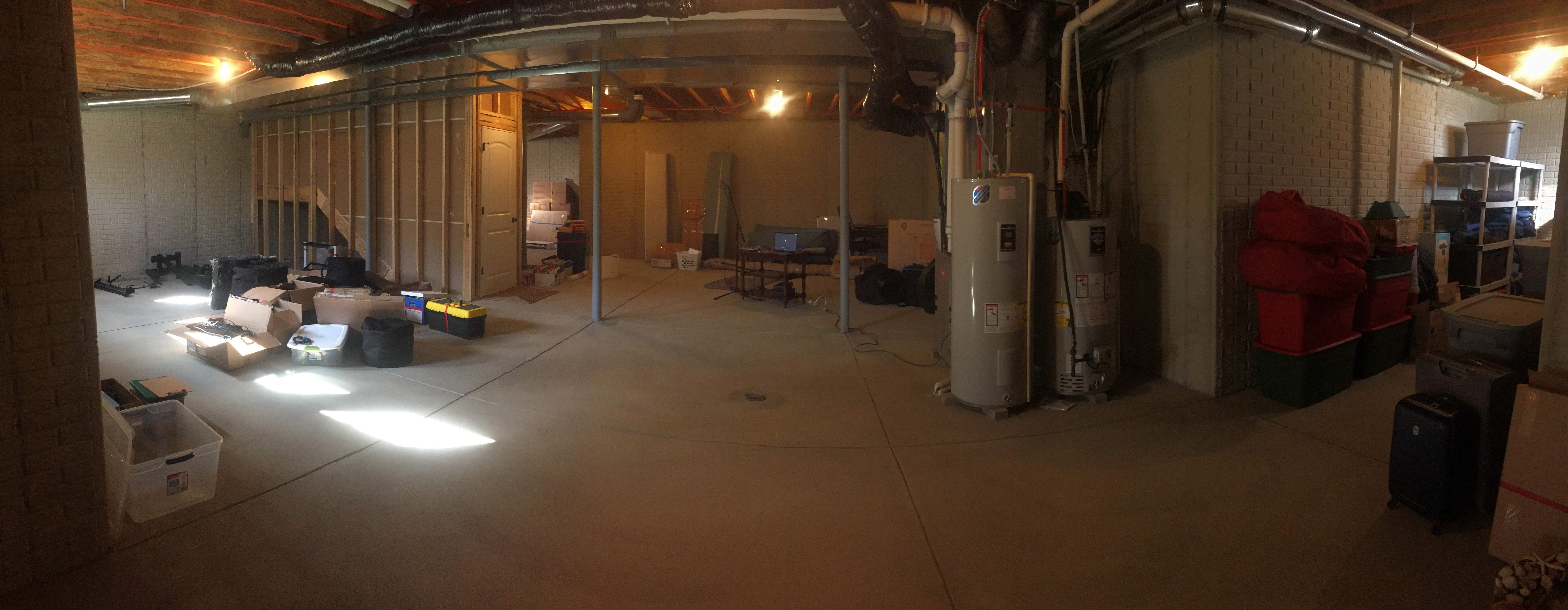

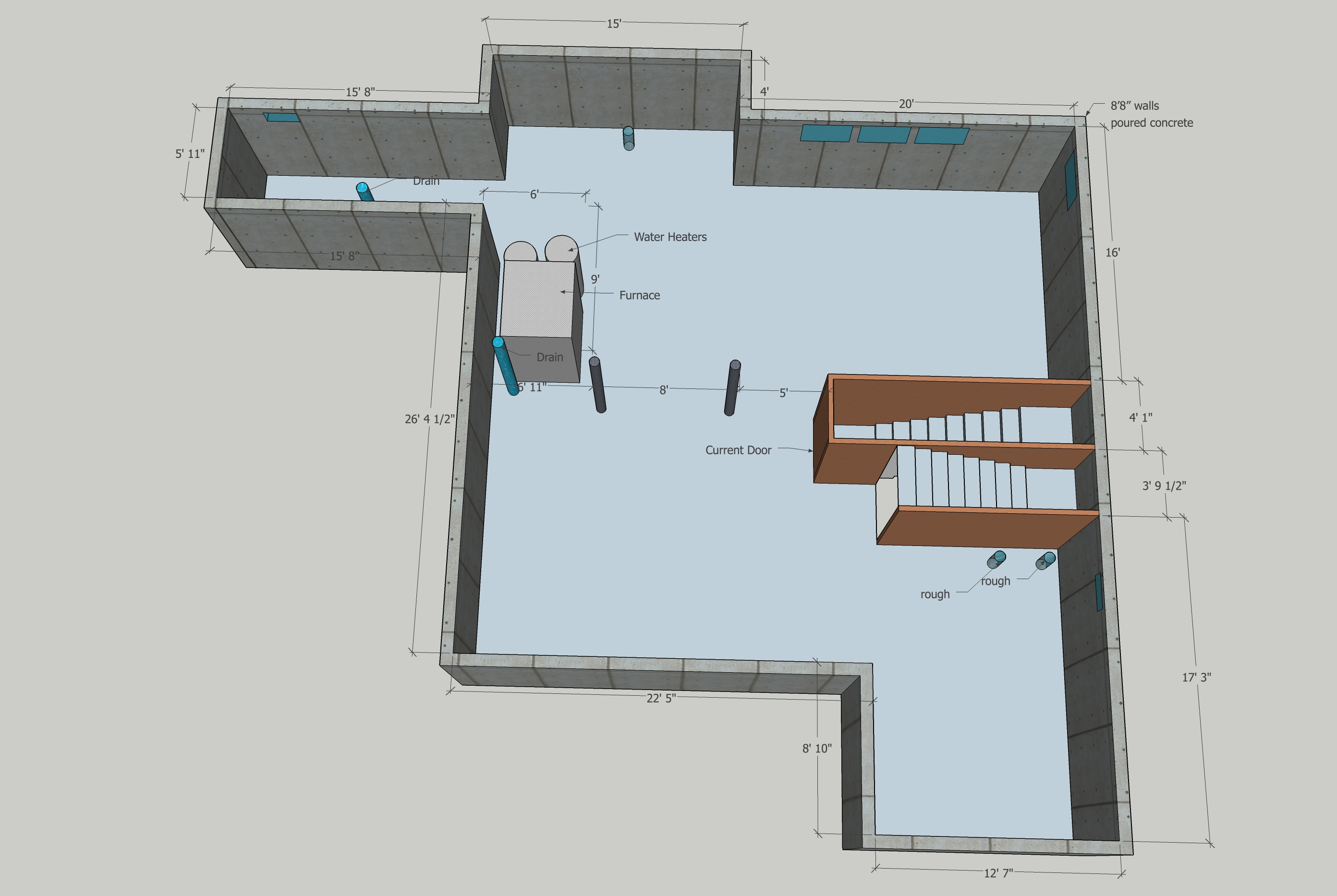

Hi all!
long-time lurker, first-time poster. I've been mucking about as a hobby composer for almost 20 years and finally have the opportunity to build a proper home studio in my new basement. Attached are 1. the current basement layout, 2. my initial box-within-a-box studio, 3. a coffin-within-a-box studio, and 4. pics of the space. My biggest sources of noise are the furnace/water heaters (we're in ohio now, so those will be on pretty much non-stop for the next 6 months) and my family walking around on the ceiling above. It is a poured concrete walls/floor, 8'8" to the bottom of the 12" wood joists; there is currently no insulation anywhere to be seen. It is a raw space, but has a lot of potential (I think).
Use: I will almost exclusively be recording my own vocals (rarely live drums or amped bass) so having a recording/mixing desk with a good listening position and a good mic'ing position in the same room is crucial. VERY unlikely to ever need to record a full band.
Goals: record clean pop vocals with fairly even frequency response; approach ZERO leakage of sound into or out of the recording/mixing space.
Space: about a third of the basement can be dedicated to a combined recording/mixing room, keeping a large chunk for storage and bar/lounge.
Questions
1. Should I bother BUILDING a studio? Or should I stick with my ClearSonic vocal booth, throw some acoustic foam and traps on the cement walls, and just be done with it?
2. IF building, is this the best part of the basement to use?
3. Should I bother making the coffin-shape? Or stick to a rectangle 19'x15.5'? Do I NEED it to be as wide as possible (or is the 19' length the important factor?) Any utility in making it more narrow??
4. If coffin, is there an optimal angle for the walls?
5. Am I even in the right ballpark for a diy build with a $10k budget? (I don't expect to ever MAKE money on my music)
Thanks in advance! If you'd like some LOL's follow along as I try to build this thing (o;
cheers n' blessings,
Garrett

Jealous. I miss my basements. I had to build my studio in the garage. :(
Questions
- Build the studio. It becomes more than just a place to make music.
- Looks good to me. I personally would not have it run right up to the stairs like that. I would provide a hallway. For me, it seems easier to build and to get around the space.
- Really your choice. Construction-wise, it is a little more involved, but not by much. Benefit-wise. It will help some, but the more important factor will be room treatment.
- Don't know.
- Don't know. But yeah, I think you should be able to do everything for under $10k if you are a DIYer. I think I could.
No insulation. What is the climate where you live? Winters? You might want insulation and heat. If you have a/c for the summers, it will always be cool down there.
Great thoughts, Chili -thank you!
Reason for going up to the stairs was to get as long a room as I could; I’m hoping that the floating 2nd walls will help prevent noise transfer, but perhaps I should just shorten the room too.
Insulation: I am definitely cold blooded and things do get cold in Ohio. I’m planning on filling the floating wall and the outer studio walls with acoustic fiberglass. What do you think about filling the space BETWEEN the two walls? Better to leave an air pocket or pack it with mass? I’ve seen recommendations go both ways.
Thanks again!
-g
I think if you pack the walls, it's a benefit. Safe 'N Sound of something. I'd go with the "coffin" and fill that space with rigid fiberglass or rockwool. That's going to make a fairly dead space, so you can always add some reflective surfaces later. It'll also be a giant broadband trap, which is a wonderful thing where there's lots of concrete around.
But most definitely - Make accomodations for HVAC. You can always close vents and returns. But you can't open them if they're not there. I made an idiot move here by putting in a hot air return (several, actually) but no cold air return. Never thought I'd need one. I was wrong. It's a LOT easier and a lot cheaper to do it while you're building.
As far as measurements - I'd highly suggest a book or two by F. Alton Everest -- Just look at the titles and you'll know which ones to get.
ZERO leakage as you say will be the biggest challenge.
G
G
Totally agree. I'm trying to approach zero as close as possible, with a realistic expectation given my budget and pre-existing structure heheh
Thanks G!
-g
I'd consider a room within a room that's a bit smaller, and well treated, including a double door. The ceiling is going to be a big problem but I wouldn't want to reduce the height much, so Safe'n'Sound or even denser material behind some acoustic tile paneling is probably the best you can do. Your vocals won't penetrate into that space enough to bother anyone, and it's unlikely that overhead traffic is going to be so constant you won't be able to use the space sometimes. I.e., I'd concentrate on keeping sound from going out, and that's probably achievable.
The 2nd pic looks fine, but if you provide an airgap and insulate both walls the room will get smaller. But, that's not necessarily a bad thing for what you're doing. If you look at a room mode calculator, you'll see that your proposed dimensions aren't as ideal in some respects as a smaller room, like 18x12.
You will still need to treat the interior space with broadband and bass traps.

Lucky you, having so much space to work with!
P.S. Somewhere among the videos out there about room treatment there's a detailed one that shows test data where having insulated walls that are finished only on the outside (visible) surfaces, with an open airspace between them, has the the best sound reduction.
Since you will only be recording vocals (where noise from upstairs and furnace is a concern), I woudlnt' worry too much about that aspect - just tell the family to be quiet for an hour (that's what I do!)
Have you considered building the studio room in the upper section? 16" wide x 20 feet long + the 'bar area - much better than the almost-square area you are contemplating. This also leaves the door form the stairs OUTSIDE the studio area.
I also recommend you add fiberglass insulation (pink or yellow stuff into the ceiling joists) - this really will help keep the house warmer in the winter (at the expense of having to heat your studio a little when you work in there. When I added insulation to my basement ceiling, I couldn't believe the difference it made upstairs.
Good info!
I'll check out the calculator and consider re-sizing my room.
To confirm the last bit as applied to a room within a room: studio space --> treatments --> drywall --> Studs w/ Safe'n'Sound/equivalent --> [NO DRYWALL] --> air gap --> [NO DRYWALL] --> Studs w/ Safe'n'Sound/equivalent --> drywall --> living space ? I seem to recall this video -thanks for reminding me!
Good info!
Yes, that's pretty much it. Of course, if you double up the drywall with some of that "green" adhesive that will further reduce sound transmission, and more LF content, but it'll add more cost.
I just kept making the numbers smaller - you might find other dimensions that give you more space that are workable.
LOVE it! I'll run those dimensions in the Room Mode Calculator and give that some strong consideration. It would be nice to have those egress windows available when my gear overheats :listeningmusic:
As for insulation, I will be adding LOADS -in the walls, in the ceiling, and I may stuff some inside my clothes in the winter LOL (...itching vs cold...)
thanks!
thank you!
