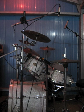

Thanks to this thread i tried the recorderman's technique after experimenting with the XY method, and it gave great results. Here is a pic of the setup as it is now. I still have some tweaking to do.
Here's my setup:
2x mxl 991 overheads
1x sm58 on snare
1x beta 52 bass drum
Presonus firepod
Macbook Pro 2.33 - 1 gig ram
1x Novation ReMOTE 25 LE USB MIDI Controller
I also have a pair of mxl 990s i have to experiment with on the toms and snare...
