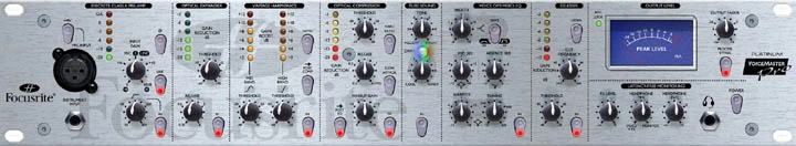

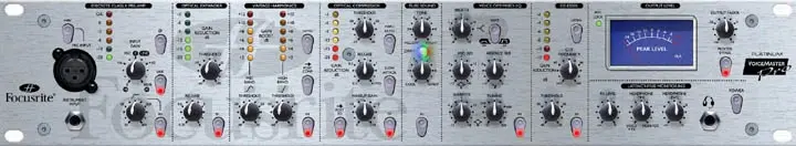

Another option, man am I gonna catch heck for this recommendation, is the new Focusrite Voicemaster Pro around $599. It's pre is just as detailed as the RNP, however it has built in noise rejection. I was using my C1 within 4 feet of my computer the other night. With my DMP3 pre I would not have been able to use the tracks because of all the fan noise. With the Pro, there was absolutely no fan noise coming through. The mic only recorded my voice, with no background noise. There is some kind of rejection filter or EQ based gate on their pre which makes home recording a dream.
This unit also has multiband harmonics, op compressor (which I use on instruments prefering my RNC for voice), tube saturation, EQ with a breath control, de-esser (from their 430 high end unit) plus a latency free monitoring section so you don't have to monitor your voice coming back out of your computer.
All of the above effects have bypass if you don't want them in the chain. There is also an effects loop for adding in your favorite reverb or other effect during recording but which does not go to tracks. This is great for using a rich reverb in your headphone monitor while you are recording a dry track. There is a secondary loop for other effects too. I put the RNC on this loop.
Last, it has a headphone mix control for balancing the recording tracks with the current vocal or instrument while recording.
Sorry, I went off the deep end but just got my new toy and am a little excited. I think this is a great value for little more than the RNP and it is a Class A preamp. I am matching this with the NTK tube mic as the Focusrite is like the RNP, high end push.
Getting back to your issue. The RNP is a great pre but I would test it against the Dragonfly and a tube mic before making a decision.
Here is the baby.
