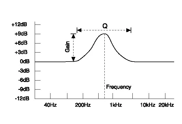

Like this?

Thanks ez. Nice to finally get a reply to one of the few questions that I have posed as a thread. I appreciate it :).
Unfortunately, that's not quite what I am looking for, but close. I'm really amazed that thise graphs are so hard to find these days, they used to be so common. It's a response chart for a multiband graphic EQ that simultaneously overlays both boost and cut curves for all EQ bands on a single graph. If I could find one or a 1/3rd octave EQ I'd be extremely happy, but at this point I'll take as many bands as I can get.
Oh, and BTW, there is a pretty important error in that graphic you have. The Q width is defined as being just the central width of the curve where the value is greater than 3dB down from the peak. It is not the entire width of the curve.

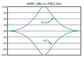

Exactly. I have a generic single-band example boost/cut bell curve that I did manage to just scrape up (see attached). I can build what I need out of that, but I was hoping to find a standard ISO multi-band graph not only to save on work (I can sometimes be just as lazy as the next guy :D), but mostly to get an idea of a realistic amount of overlap between bands (or put another way, typical Q slope for each band.)
Carter, thanks for the lead. Close; the logarithmic scale and purpose are exactly what I was looking for, and the one showing the midrange characteristics is almost there, but those graphs are actually for parametric responses and situations and aren't quite what I need. Rami's explanation is a good one.
