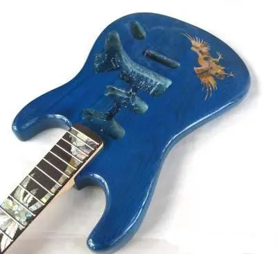

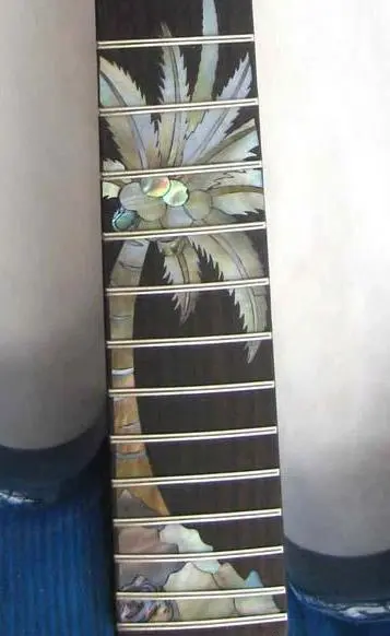

Hey, here are 2 pictures :D
Oh my...I love the palm tree !!! The inlay is gorgeous. I can't see the carving of the eagle very well though. :D
