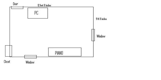

Not sure how much it helps but here is a very quick sketch of the room. The floor is carpeted. My eventual plan is to move the PC and monitors to the far end of the room in front of the window. Just for info's sake, here are all the panels I have. My camera is busted at the moment so sorry for the lack of photos.
1" Thick:
(7) 1' x 2'
(4) 1' x 1'
(2) 2' x 2'
(2) 3' x 5'
2" Thick:
(2) 4' x 4'

using the traps as is? doesnt make any sense
in a room that size you will need ALOT of absorbtion, in small rooms it helps to pretty much cover the entire walls in absorbtion.
small rooms also almost always have alot of troublesome bass frequencys.
and making a few panels that tackle the highs isnt going to help your room out much i wouldnt think.
you have your prioritys kinda mixed up in my opinion.
i know it seems like you can get the most panels done if you only use 1" sheets for any panel, but i doubt thats going to make to much of a difference to be honest.
hopefully one of the acoustic guys will come in here and shed some light on the subject cause this just sounds like a bad idea to me.
ive honestly got no idea what your talking about, your going to build more panels in 6 weeks when your mixing?
oh yeah and whats the point in saying your going to take lots of pics if your camera is broken?? sounds a bit suss to me.
you didnt even include where the treatment is going to be on your sketch, or what your planning on doing with the panels.
post some actual pics of the room, and maybe i can help you out with what kind of treatment you will need.

its suss because..
Thanks - I meant to mention that the room is about 9 x 12. I haven't officially measured yet. I will be taking lots of pics to show this stuff off.
then.. (posted 4 hours later)
we get alot of noobs doing the same thing as soon as there asked for pictures.
strangely all their cameras seem to broken too.
i dont need to re-read your post, i wouldnt have posted here if i hadnt read it already, i think you need to re-read a couple of mine.
enjoy your treatment, im sure its going to work wonders for your room.
your EXACTLY right, now go on & git to building those magical panels of yours.
and just because im a nice guy...
the 1st panels are the ones that i would think to be most important.
the 2nd are the ones that really you should do, but they can come later.
i did all of mine (about 10 and 4 corner bass traps) and 4 for a friend over a week or so, so i did the most important ones first and you can kind of hear how your room dulls as you add them in
the windows you can either cover with heavy curtain, fill in completly and try to sound proof it as much as possible, i have a fairly small window so im building a panel at the moment thats going to hang in front of it (since i cant fill it in, cause i rent)
keep in mind this is very rough without seeing an ACTUAL picture of your room
i did one of these for my room while i was sitting in it and still made a bunch of changes along the way.
