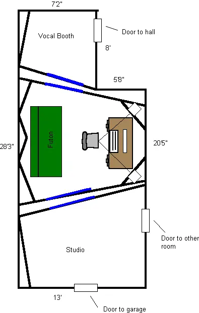

window angles
Hello Wallycleaver,
I keep reading that walls should be angled at least 12 degrees off parallel. Is this true also for windows or glass doors close to each other?
I have uploaded a potential design for my studio. Are the windows (shown in blue) not angled away from each other enough?
Thanks
Lakin

Studio design

Hello MercyfullMusic,
The futon is there so that I have a place to sleep when my wife is pissed off at me. I'm kidding. Of course, it could be a couch or whatever. I figured it would be useful for absorption and some diffusion.
Between the control room and the studio there will be two sliding glass doors. There will be the same thing between the control room and the vocal booth. From reading the postings above, I will do my best to get sliding glass doors with glass of different thicknesses to avoid any sympathetic resonance. Wow! That sounds so scientific.
Lakin

Lakin,
I like the design I would reccomend bass traps in the back corners of the control room.
Mercy, just a few degrees on one will be fine. I agree with ausrock agreeing with me. LOL!!:D
