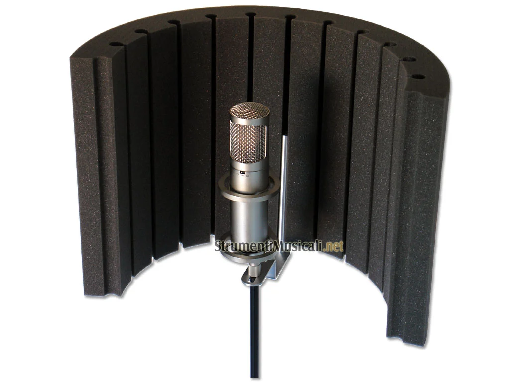

Another question: do you think something like this could be a valid alternative before modifying my room?
Mic shields like those are typically used for vocals and aren't immensely helpful compared to acoustic treatment. A 2'x4' panel placed behind the mic would give a larger benefit and could be used in a wider array of recordings.

ehhh mic shields are ok things is after you record you gotta mix. dont think they have monitor shields out yet!!??... Ugghh just go with acoustic treatments and shield the whole room
by the way GIK don't go trying to steal my monitor shield idea neither I'm gonna patent that myself :D
