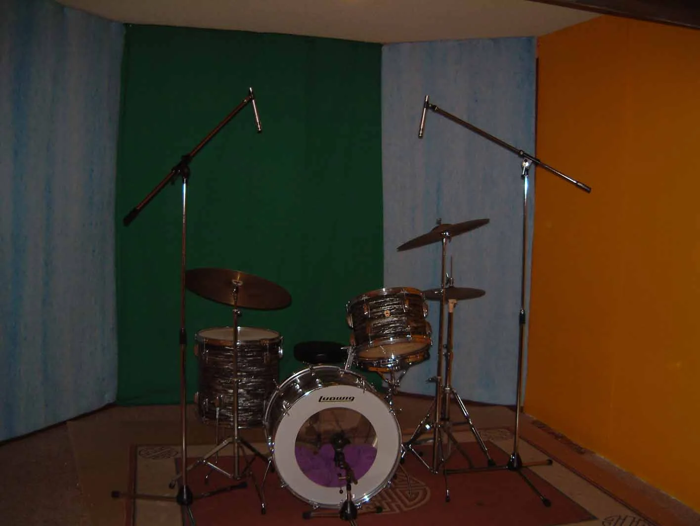

You need to get a drum kit like this, Black Pearl Ludwig, I bought this kit 20 years ago and I am not even a drummer (bass player).
The photo was taken in my old studio (new studio photos soon nearly finished being built). The kit has been used on 100's of recordings and always sounds good.
The photo is a bit of a mock up for the photo as in the way it is miked would be if I was doing jazz, 2 overheads (sennheiser me40’s or me80’s) and kick (AKG D112 or D12), when recording rock add 421's on the toms, 57 on snare, and a small condenser on the hats, plus maybe a room mike or 2.
