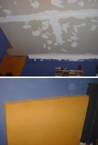

I spent a majority of my weekend ripping the foam off of, then mudding/taping the ceiling in my studio because when I built my room, I put the kind of foam that's at the bottom of the picture below on my ceiling to deaden the room, because it's so small.
It took about two years to start drying up enough to coat my drums and lungs after an hour or two of playing. Took another year or so for me to actually do anything about it.

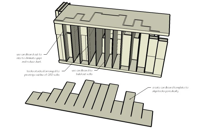

if you want to go further with th bookshelf idea, you could create a QRD template to arrange them... :-)
