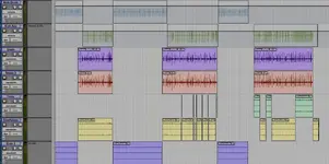

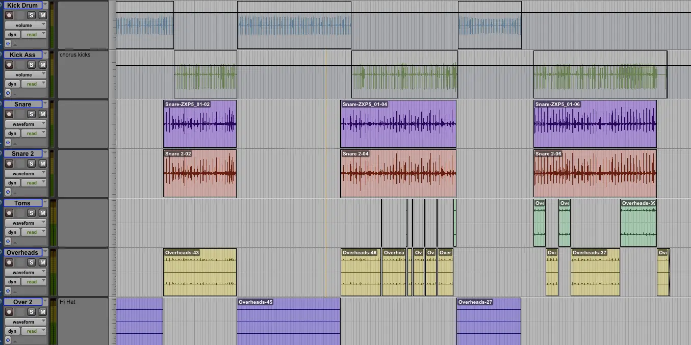

I went for a clean sparse mix. A couple things to note:
I cut up the kick track and moved the chorus kicks to a new track to treat it differently. I also cut up the overhead tracks and put the tom fills and high hat only sections on different tracks in order to give them a different treatment.

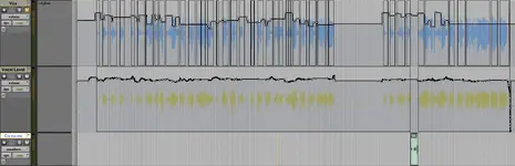

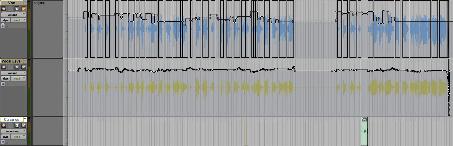

I bounced her vocal track with some drastic volume automation between soft and loud sections to another track. I used the new track with embedded volume changes to do compression and final volume automation. The goal in this was to keep every syllable out front without using massive limiting. I also took out all of her breaths.
