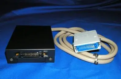

I've got a 4030 as well and also never used it. I didn't know it could interface with otari's! It would be sweet to use the 1/2" 4-track for lead vocal, bass, and kick drum!

The interface for the MX-5050 is Fostex part number 8783. :)
