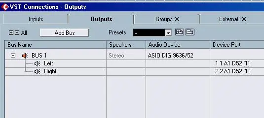

Yep. It sounds like you have your output set up as mono. Not sure how it works with a 1010, but you need a stereo output assigned to output 1 & 2, or something like that. Here it is in cubase with a RME hamerfall. My stereo bus out is assigned to outputs 1 & 2.

Sounds like you may be correct NL5. I think I have the outputs set to mono, but I'm about to go verify.
