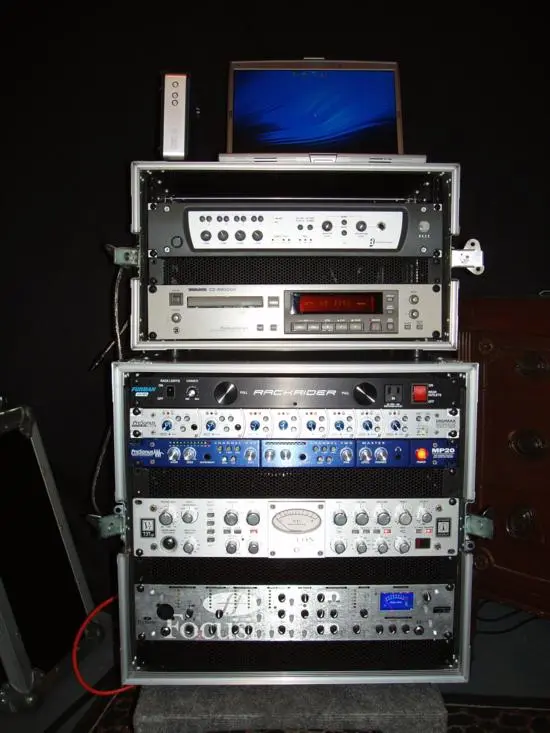

The first one I had got too hot and fried. I had another preamp sitting directly on top of the VMPro and it was too much heat wise.
Sam Ash replaced it and since the first incident I keep it at the bottom of my rack and leave some space above it for heat dissipation. No problems since and this one is going on 2 years with some heavy usage.
Looks like you have it in the right spot.
