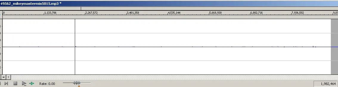

To put it visually, this pic shows the 'difference between left and right channels' , effectively showing zero, indicating a straight mono track, plus some noise clicks here and there.

OK, you guys got me thinking.....I'm recording in Sonar and I'm using busses for the drums. When the drum tracks are assigned to the busses, I can't pan them! I wish I knew how to take a screen shot so I could show you. Anyway, that's the problem. Why can't I pan the tracks when they're bussed? The busses are stereo, but when I try to pan them, they do something, it sounds like they're panning somewhere, but the master buss isn't letting them. Does that make sense? Even when they're solo'd, as long as they're assigned to a buss, they won't pan.
I need the busses for mixing & applying effects.
Could this have something to do with my outputs? I'm using a RME Fireface. The channels are assigned to the busses and the busses are assigned to the master buss and the master is assigned to Fireface out 1 (Which I assume is 1&2- that's the way RME numbers the outs. And if it was just output 1, I'd only hear it out of the left channel, besides, it works fine in full stereo when I don't use busses.) ????
No, the fireface would only affect what you hear and not what is rendered in sonar. I do not use sonar, so I cannot offer any specific advise, but I would make sure that I don't have a 'mono' option selected somewhere.
Update-Remix
OK, I think I figured out the stereo imaging thing. My Master Buss was in mono :o , so now that I've fixed that, I remixed it a little. Check my new mix out.
