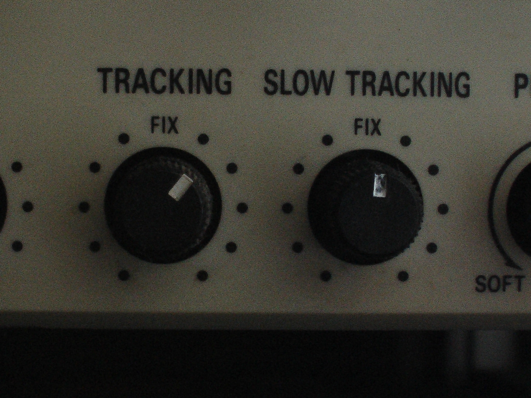

The main reason people dont adjust azimuth is because almost no cassette machines had a user control on the machine. If there was, they'd probably twiddle it, even if they didnt know what it did. They'd soon find out.
In the early days of home video there was always a front panel user "tracking control" so as to manually adjust for the best picture. See attached photo.

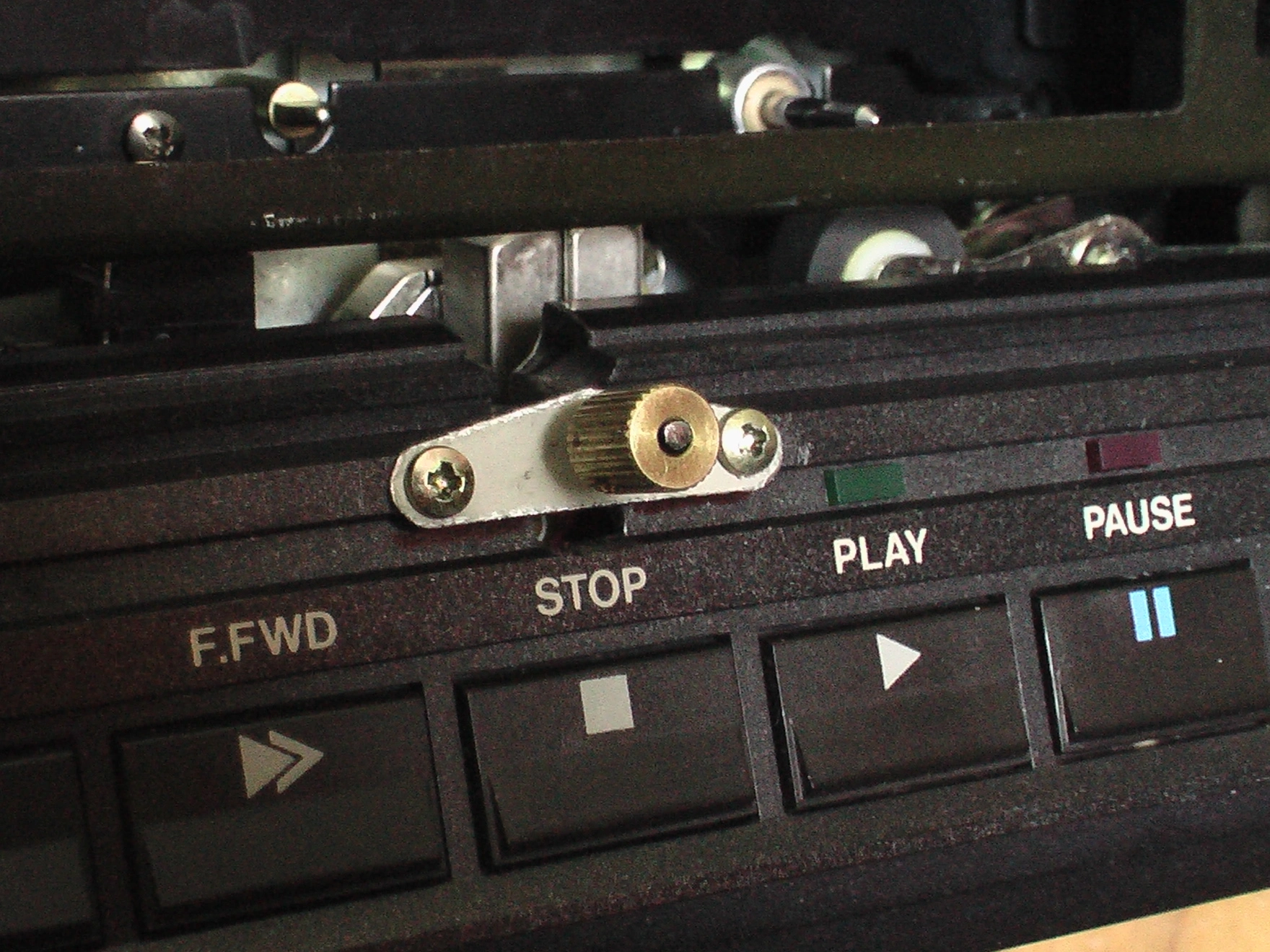

Also attached is photo of a Tascam cassette deck, custom modified with a user azimuth control. I made this mod myself as I got sick of fiddling around with a tiny screwdriver on the azimuth screw.
Now it's easy. It takes me all of 5 seconds to adjust the azimuth on a 90 minute tape which I need to get right first time. I dont want to have to spend another 90 minutes doing the job again. That works out at less than 0.1% extra time spent per tape.
Adjusting azimuth is much quicker than manually EQing a muffled recording - muffled because the azimuth was not adjusted...
Worse, EQing can never bring back highs lost by misaligned azimuth.
And cassettes were notorious for misaligned azimuth.
And another thing. If it's a Dolby recording and playback azimuth is just a little bit off, all bets are off for Dolby tracking.
But dont listen to me. I'm anal. Apparently.
