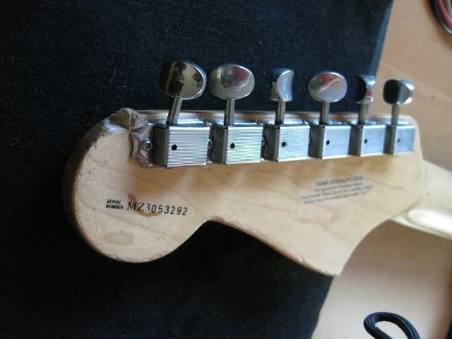

So a guitar has come to me with some fairly big "dings", a victim of live show craziness.
Poor old high E hehe (will replace the machine head or dismantle and attempt to bend it back (not that I hold much hope for that))

I'm tempted to just leave the headstock one alone, maybe seal it?

The headstock. Replace the machine head or repairing the bent post shouldn'r be a too much of a problem. The breakout at the head is going to need piecing in and is a pretty trick job even for a tech. It won't steam out. It won't effect the function of the instrument as it is so if you can live with it just leave it. If it has any bare wood showing seal it off with shellac.

Muttley, thanks for the advice. Will just leave the headstock (and seal it), put on a fresh tuner (it really doesn't want to bend back). As for the neck, I see what you're getting at - remove frets, route out section, add wood... but I don't have any rosewood (collecting woods is something on the (never ending) list - I'm still tooling up (also seemingly never ending!)) so I might send it onto someone with the right stuff to do it in style. And I get to start looking at buying some wood stock :D!
