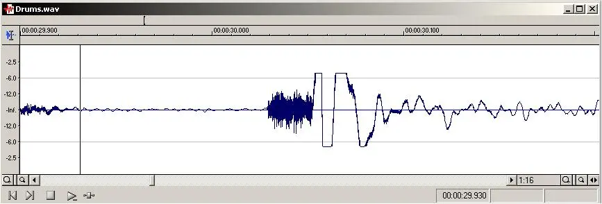

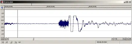

ummmm
ummm... such bad clipping!
yummm....
