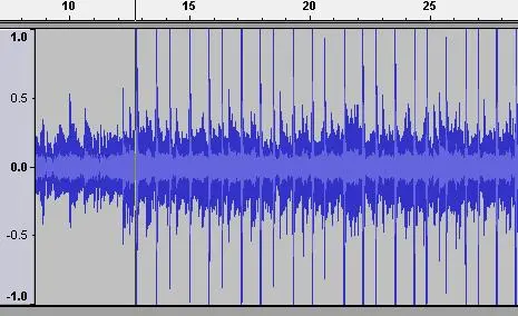

Hi guys, at my church, just for kicks, I recorded a track of our band from the output of one of our channels from the headphone amp. Ya it's lame, but it was really just for fun, I'm obviously not expecting a useful recording.
The sound came out good enough for us to give a listen, which is all I wanted so we can review the new song. However, just the kick drum came out really prominent and clipped all over the place. I guess during practice I didn't notice it was high somehow, or was turned up later and I didn't know it.
In any case, I just opened the WAV with Audacity and ran a compressor on it with a normalize to 0db. The "main" parts of the song in the WAV look normal, however the kick is still spiking. Refer to the attached image. This is the WAV after compress and normalize. And again, the quality is good enough to for us to have a laugh, but for educational purposes, I would like to know how to bring all those spikes of the kick down to the level of the rest of the WAV form, if that makes sense. In other words, remove the spikes and take out some of the prominence of the kick.
I've tried compressing more, but the ratio of spikes to main audio stays the same anyway. I've tried EQing out the lows, that doesn't work. I've played with limiters, maybe I did it wrong?
So if anybody has any ideas how I can even up those spikes and remove the booming kick, I would be happy to learn the technique.

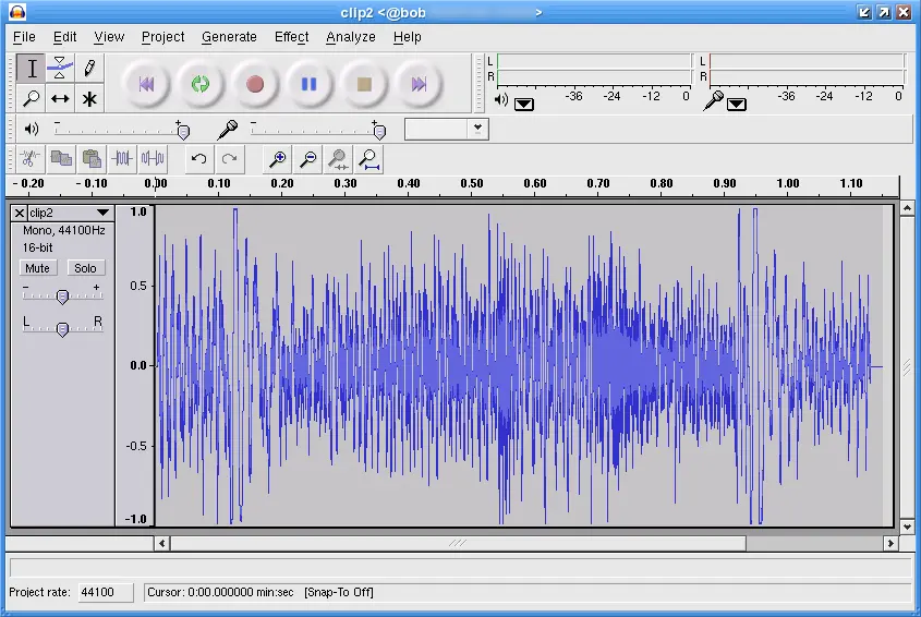

I used Audacity to apply the Fast Lookahead Limiter plugin (from Steve Harris, plugin.org.uk), with input gain of about 9.5dB, limit of -0.1dBFS, and a fairly fast relase time, maybe 0.08s. That did smooth out the waveform a lot, but I wouldn't expect stellar results. It's impossible to tell much with such a short clip.
Btw, the "flattops" are in the original waveform -- the limiter plugin I used didn't introduce them.
