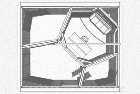

new question for the group.
Hey everyone i have a new question please, the 20x24 i have, how many of you would make the control room 8x20? or is this too big. it seems i would be cutting down on the live room area a bunch. anyways thank you and i still have a long way to go. Braxton
its important to consider the room height as well as the length and width. let's suppose you have a ten foot ceiling. if so, the looking at optimal ratios for the room, you could build it 14 feet x 19 feet (1:1.4:1.9) which is a decent ratio (which means you'll have less problems when you go to treat it).
another option is to choose a smaller CR with a proper ratio that gives you room for other parts like live room etc...
