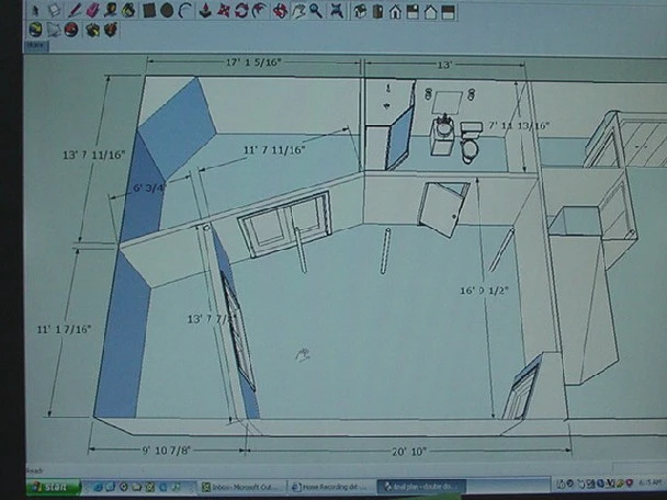

Sorry! Completely forgot the dimensions! Here is a pic of the room with dimensions. I can knock out the small room to left to lengthen the room a bit. My thought was to use the larger room at the top for drums, the small room to the left for vocals and the bathroom as an amp closet. The bass would go direct and the second guitar would have to use a pod for live recording and then dub the amp later. The main room would be the control room. Of course I'll have to treat the rooms but right now I'm just planning the layout. Are the rooms too small for what I had planned?
No, that's pretty good. For some reason it looked a lot smaller, but 16 by 20 is definitely large enough for good results given enough bass trapping and other treatment.

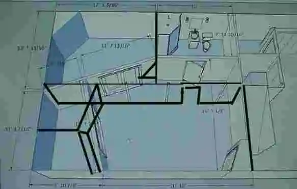

tom18222 said:
thats called an LVL :)
being in construction right now, i can tell you thats going to cost alot of money. put a jack under the whole house so suppord the weight, remove the existing beam(s) and columns. it may be worth it, but thats alot of work.
You don't need to jack the whole house to replace support columns for one load-bearing wall. That's nuts. You just need some temporary bracing to support whatever load those columns support. Simply using a number of 2-by's (placed under the ceiling joists) on either side of where the beam will be placed will do just fine. Or, if you prefer, actually building a temporary stud wall, offset to one side, to support the load, and this lumber can then be reused for some other job.
I would enclose the columns in a wall, have a larger control room in the upper right area and a soundlock/booth in front of the bathroom so you didn't have to work with expensive to soundproof sliding doors. Then you have a large symmetrical space genuinely suitable for a theatre room and I would put two sound booths at the back in a symmetrical pattern.
Sorry to hijack this thread, but I'm interested in that program you are using to design your rooms. What program is that? Is it freeware?

Innovations - I looked at the plan you drew and I agree that this would be ideal with the locations of the posts and offer better iso, unfortantly I'm not the only one that has a say in how the end result looks *sigh*.
Nash - I'm using google sketchup. It's free and easy to use. I highly suggest it. http://sketchup.google.com/
