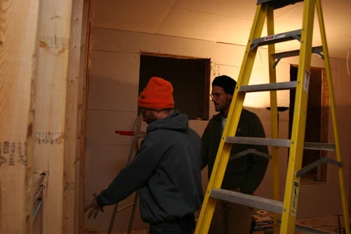

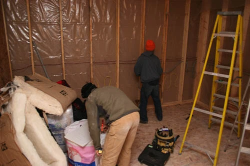

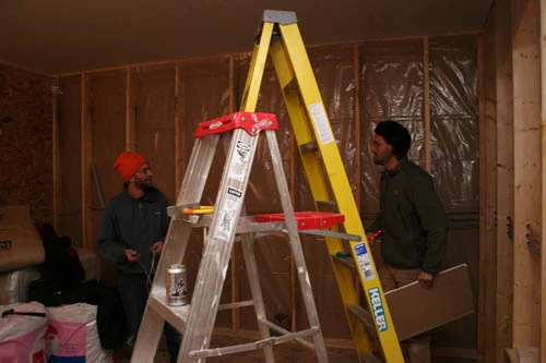

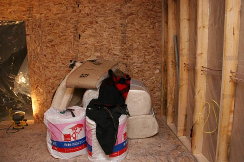

Here's where we're at. We took all our sheetrock scraps and put another layer on the control room partition wall. The photos aren't the best.
