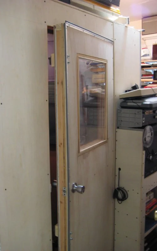

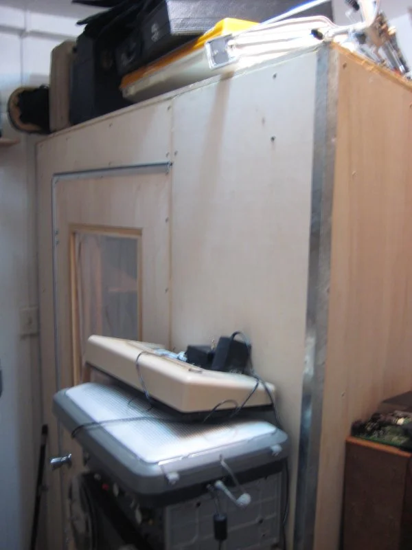

Well, I may not know the nomenclature, but it's a freestanding booth, inside of a room. Looks like a booth to me, anyway. Some photos follow.

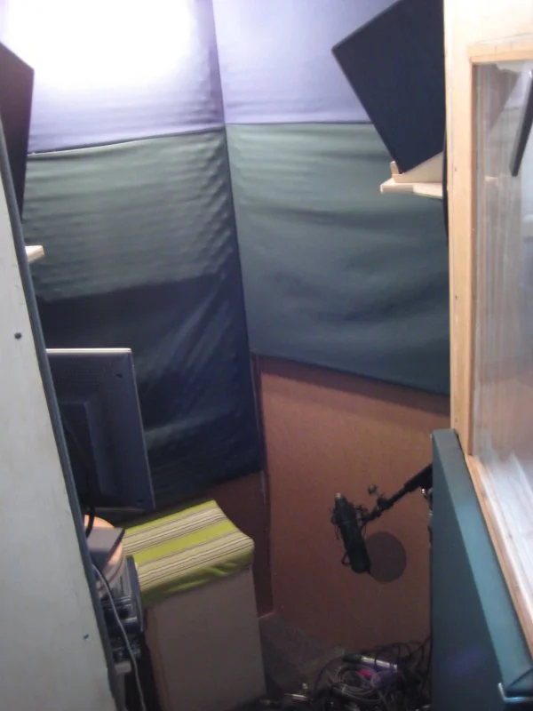

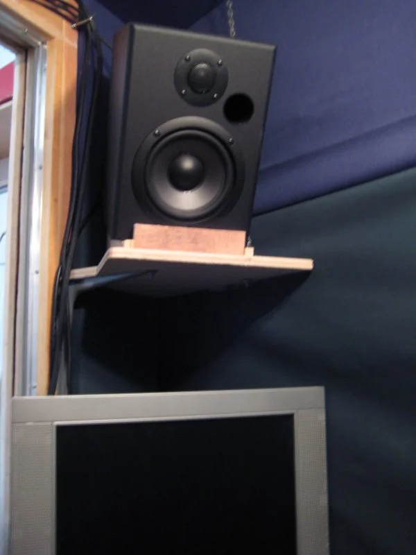

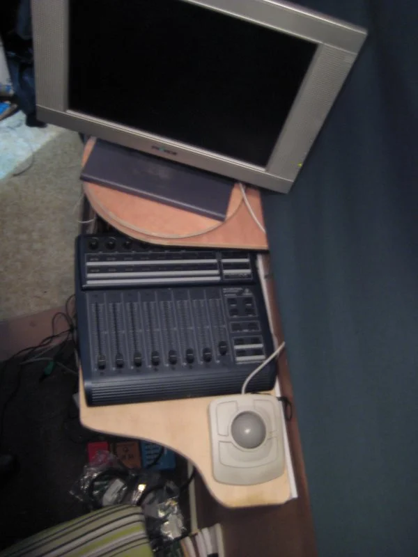

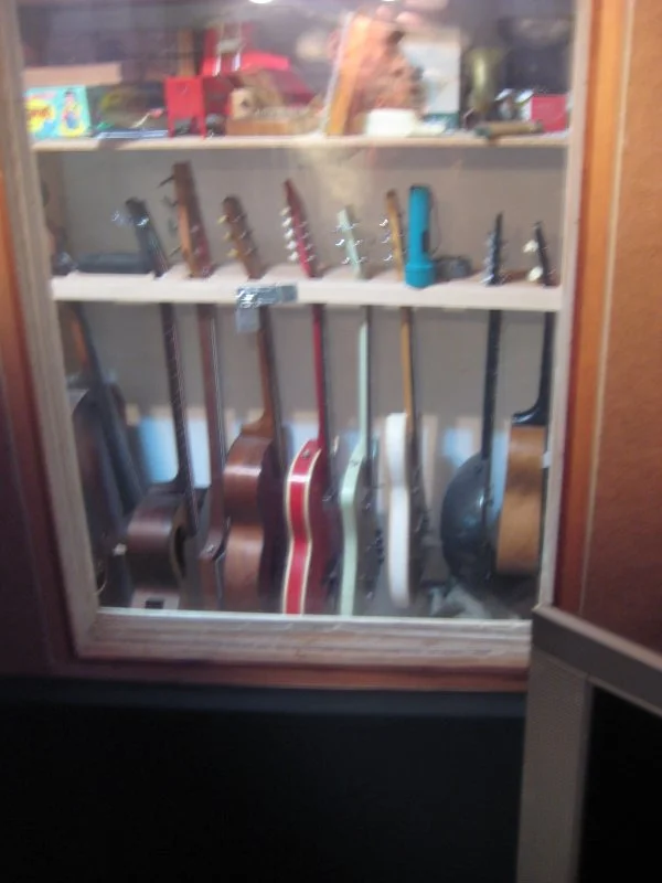

I designed and built the booth to fit my largest instrument (and me!), so it's just big enough for my needs while still fitting into the room. Two of the walls are not parallel, and all walls and ceiling are faced inside with varying thicknesses and densities of foam behind fabric covers.
All walls and ceiling are sandwiches of 1/2" birch ply, an 1/8" layer of neoprene, 5/8" sheetrock, a 1-1/2" cavity filled with fiberglass batting, 3/4" acoustic fiberboard and 3/8" MDF. The floor is 1" MDF on top of 1/4" neoprene on top of 3/4" ply.
The door is the same sandwich as the walls, with a window made of 5 layers of acrylic, 2 of which are set at angles to the others, to prevent the transmission of soundwaves. The door surround is lined with rubber isolation strips and the whole thing closes tight with two dogs.
It's pretty damned isolated, and it's acoustically pretty dead inside.

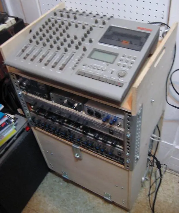

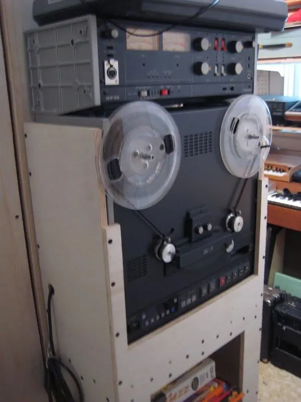

Well, it's like softcore amateur shit, but here's the "workstation" and R2R rig:
(BTW, that silver thing in the middle of the top row is a Behringer Ultra DI, in case anyone is confused. And the PC is inside of the ply cabinet that the gear is in, with appropriate venting. It's a 2.6mhz Pentium dual-core with 2gb of RAM and a 750gb HDD.)

Hey! I have the same reel-to-reel 2 tracks tape! I'll say sorry for my english now, my first language is french. I'll try to say what I want to say:
Is your module (where the 2 VU meters are) attached to the part where the tapes are? Because mine is like on a rack with wheels. The part with the tapes are making an 45 degrees angle, and the module with the VU meters is attached to it, but is horizontal, like if it was on a desk.
I hope I was enough clear... I hate it when i can't find the good words... whatever...
There's nothing wrong with your English; you're using the language just fine -- FAR better than my poor grasp of French!
The timecode unit on my Otari is separate from the deck. I pulled both of them out of a commercial recording studio that was upgrading to all-digital gear, and the deck was mounted horizontally, with the timecode unit mounted at a 45-degree angle above it, so it could be easily read from the engineer's chair.
I have a lot more affinity for old analog gear than new digital gear, so I want to try using the Otari for mastering 7" records. If it doesn't work well for that, I might try to use it to produce tape saturation effects in the digital chain, as suggested by Craig Anderton here: http://www.soundonsound.com/sos/1996_articles/oct96/tapecompression.html .
How do you like your Otari? What do you use it for?
Well it's a nice piece of gear. I was using it back in 2004 to 2006. I used to record my demos on this, but the problem was that I could only make 2 tracks. I found a way to bounce a track to another so I could overdub indefinitely. But the quality of the first tracks were worse each time I would make an overdub...
And then I used my computer with a DAW, so the problem was gone. But the quality wasn't the same. I liked the OTARI, but with only 2 tracks, I can't do a lot of things with it. Sometimes I just listen to some old tapes for fun.
