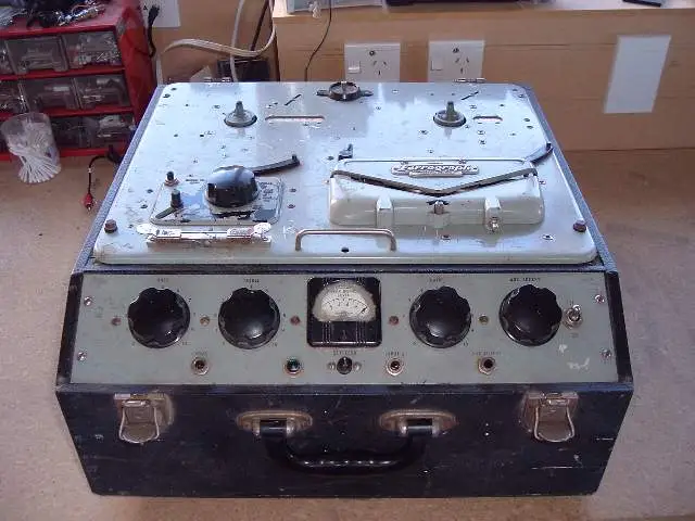

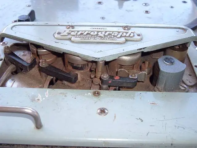

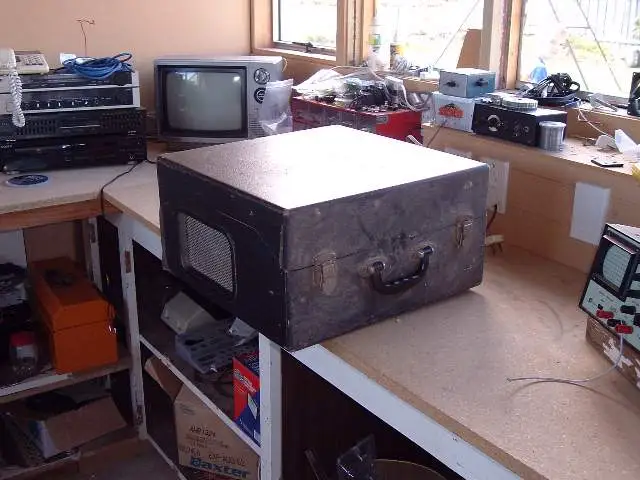

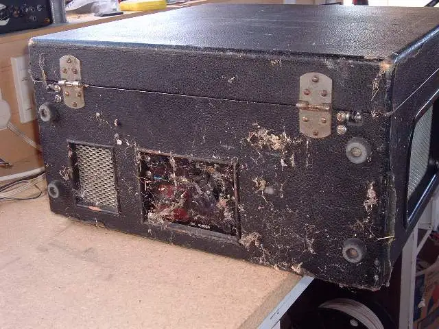

Ferrograph as delivered

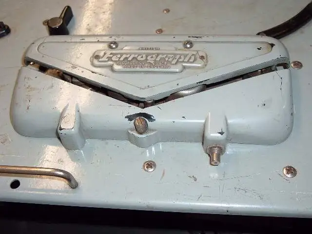

This was dad's pride and joy in the 60's, but has been stored for quite a while. The heads are a tad grubby....

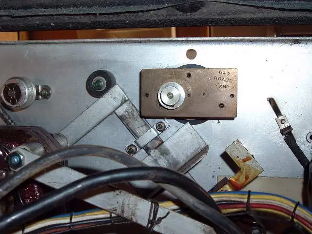

Internals

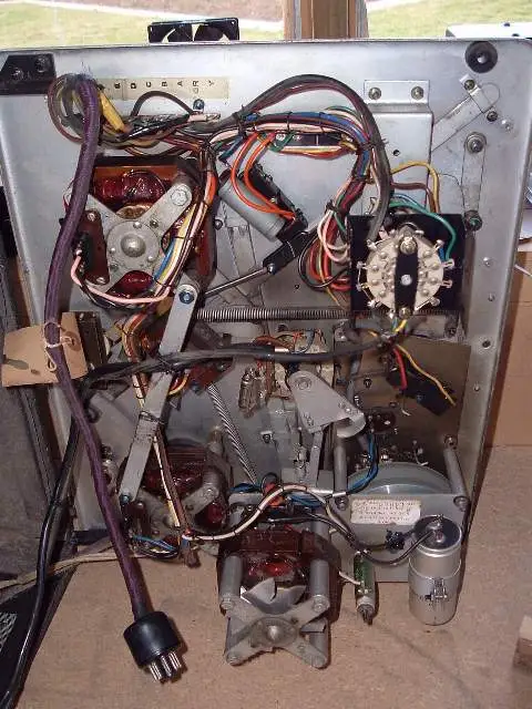

The deck is absolutely solid, but a quick check shows that all the linkages are ok, reels are turning freely and the brakes are good. Not bad for 50 year old rubber parts!
Note in dscf0735.jpg you can see the GX265D in the background, and if you thought sticky shed was bad check dscf0736.jpg - not sure how all these bits of tape got in there, but someone didn't have a good day!

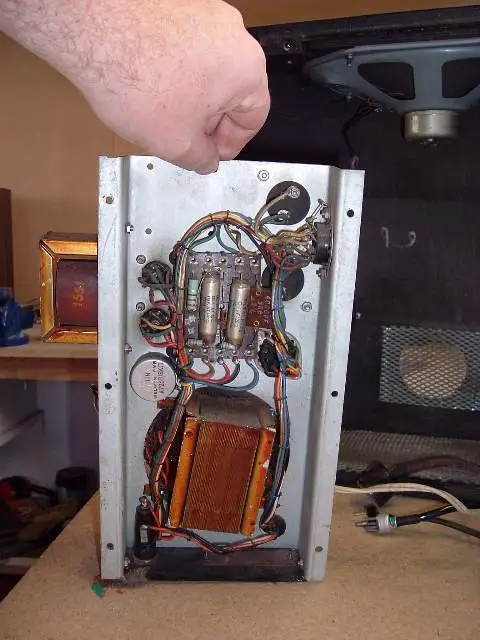

Modules

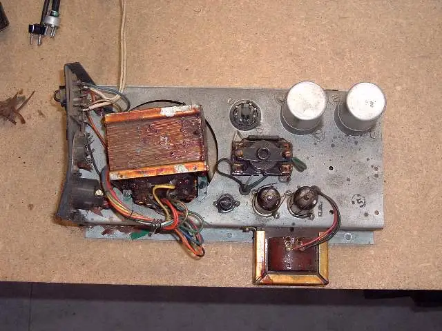

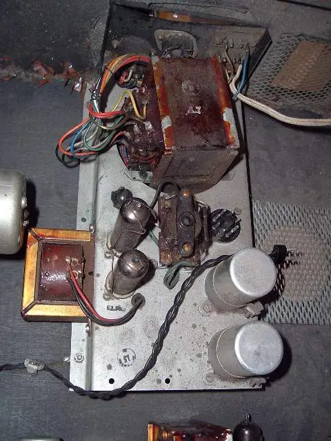

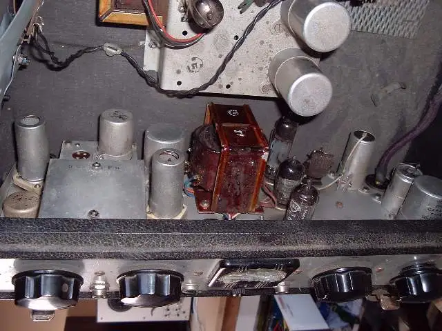

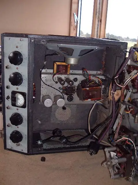

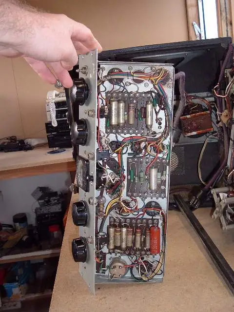

The amplifier module and power supply after being removed from the unit. After these were taken I cleaned some of the dust off the chassis and cleaned the contacts on the valves.

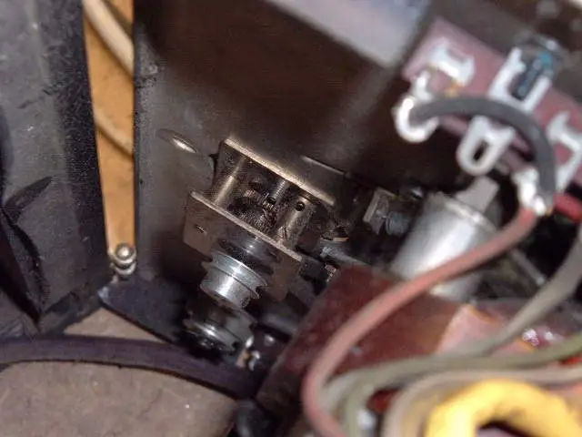

Modifications

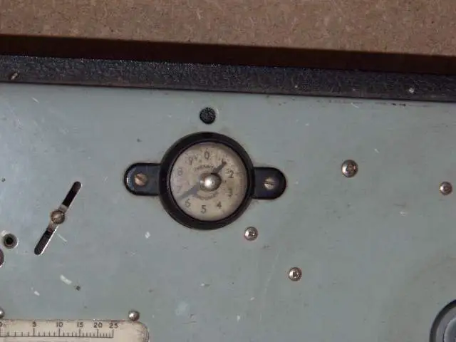

These pictures show the 'optional' tape counter (only fitted as standard on late series 3's as far as I can tell) and the 'optional' pause button in the head cover, standard from series 4 but available as an option in series 3. This cover was fitted to a series 2 and certainly wasn't the original.

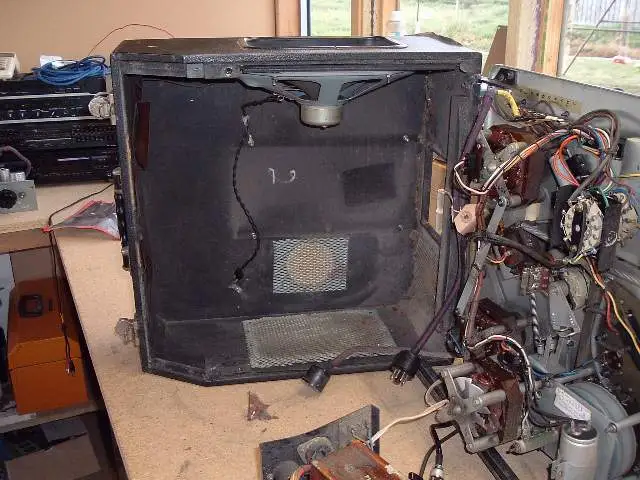

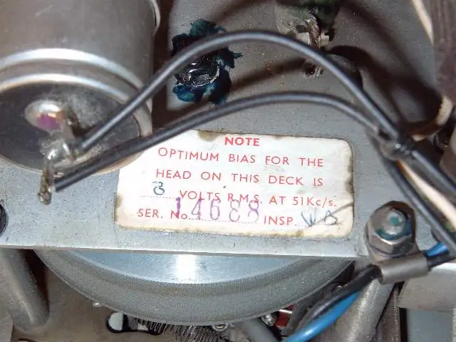

These show the inside of the gutted case - before cleaning - and a note of the optimum bias. The Weare & Wright deck that was the basis of the Ferrograph was assembled by hand and the optimum bias voltage adjusted for each individual head.
