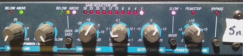

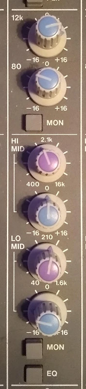

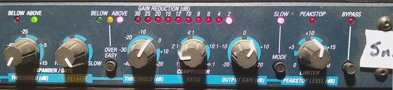

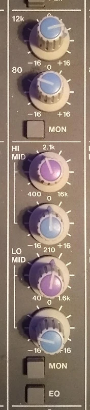

I just checked my last full band mix. All I did to the snare was eq. No compression, no replacement, nothing else. When tracking, I probably had a little eq on the mixer channel and barely hit it with a dbx 166 compressor.
Here's the input chain on the snare. I took these last night, but I bet they haven't changed much since I tracked the snare in question. The compressor pic is from a video I shot, with the maximum amount of compression it showed over several minutes. On the Tascam M2600 MkII the inserts are post eq. The solo snare was a bit thin sounding, but it combines well with the snare in the XY overheads.

Great, very useful to see an example of how much you do during tracking.
