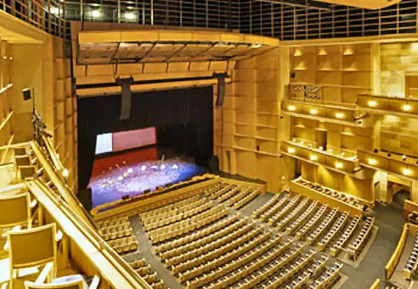

Although, I know for a fact that diffusion is used iin large spaces, but usually the "diffusers" are quite large..ie....in size relationship to the wavelengths of interest. And usually these diffusers are very large geometric shapes for LF diffusion. Of course, in very large halls, LOTS of people will contribute to the absorption as well.:D But..my disclaimer is in full force here. Ethan is the expert...although, look at this.:)
Yes, good point, but this is not so much to diffuse low frequencies. The goal is to spread sound from acoustic instruments on a stage to the farthest reaches of the auditorium. If a PA system is in use the speakers can be aimed as needed, and more can be added to fill in gaps. But orchestras are not usually amplified, and some room shapes end up having hot and cold spots.
fitZ
That photo reminds me of RightTrack studios in Manhattan for some reason-- same size and color of wood I guess. But the wood walls in there were pretty much entirely rigged to open up to reveal individual absorbtive panels-- the entire huge space completely and easily alterable in terms of absorbtion or reflectivity. It was something-- like the recording studio in the Death Star.
