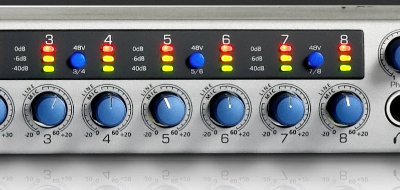

Curious why not to use a 1/4" TRS cable since the Pre73 Jr and Firestudio Project both are capable of a balanced connection?
The gain knobs on the front panel appear to affect the Line ins which would be the 1/4" of the combo jack...

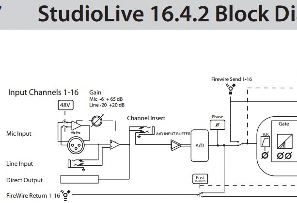

Found this block diagram image for a Presonus Studiolive and it seems to suggest the Line inputs are after the mic pres. Perhaps the Firestudio would be the same(?)

The gain knob on the interface does indeed affect the signal further. If these inputs are true line then surely the adjusting the gain shouldn't have any effect.

I suspect the manufacturer retained the gain control in the path as all instrument line levels might be slightly different.

.." suggest the Line inputs are after the mic pres".
That's just normal electronics. What might be abnormal is what you can find in pro gear : ) Like with mixer routing. If a interface has the multiple MIC pre, that's normally just on the XLR MIC input and a level knob wouldn't affect the line in, but only the shadow knows for sure.

Mark is on the money. That diagram shows the line signal going into a downstream IC. The gain control might still affect the signal but it is probably a dual gang pot and Presonus use a clever gain sharing arrangement to minimize noise and maximize headroom? The company are anyway known for excellent pre amps.
However, this question of "will an attenuated mic pre as a line stage bugger my pre amp sound?" comes up regularly. IMHO not likely. Given a decent mic amp design (and Pres' are such as we know!) the addition of a few resistors is hardly going to change things much, in any case the stage will likely be at minimum gain and hence contribute even less noise etc to the signal. The question is even more marginal if the intended pre amp is one of "colour".
