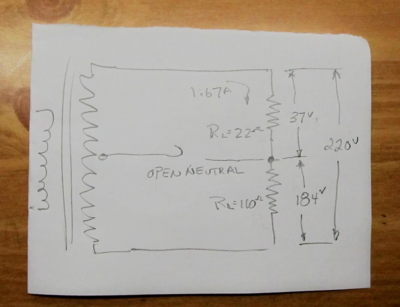

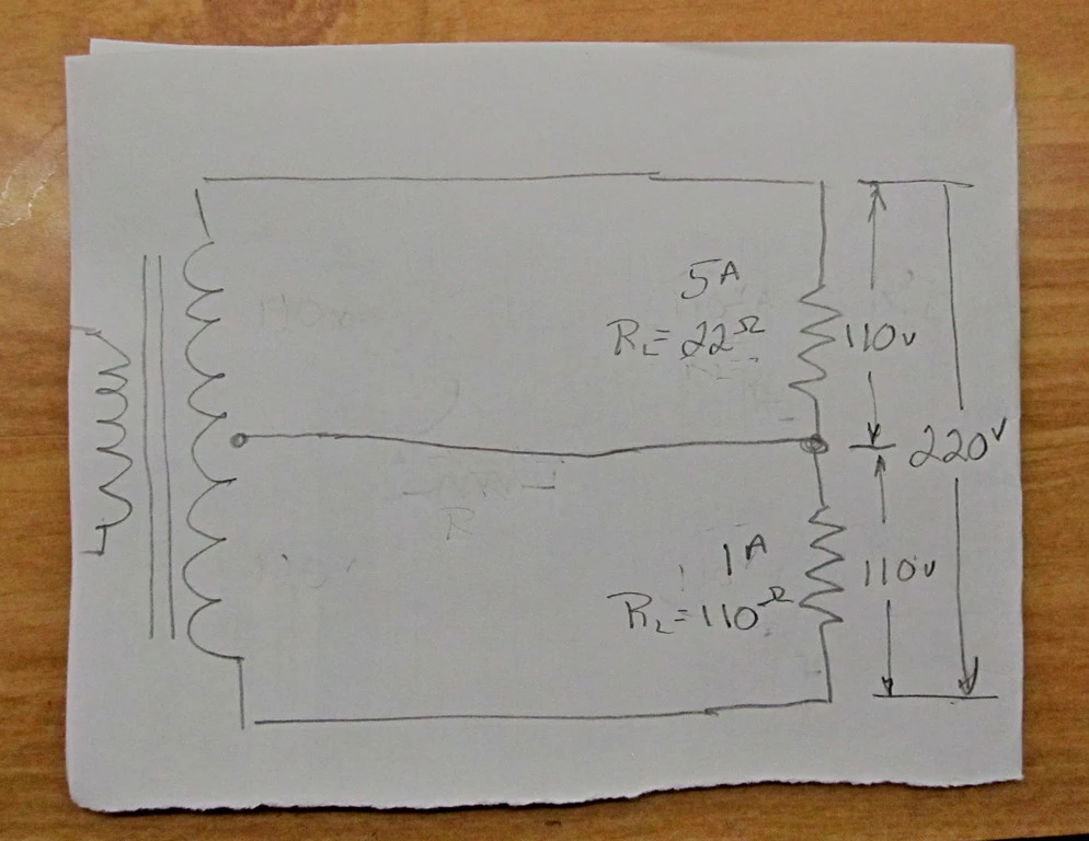

I had a problem a few years back with the service drop to my house. What I was noticing was when I started my table saw the overhead incandescent lights were getting momentarily brighter. The lights were on the other half of the 120v supply leg from the breaker box than the saw. The transformer in the street supplies 240v to the house with a neutral. I metered each leg of the 120v supply and one was about 110v and other about 130v to neutral which normally wouldn't damage anything. Full voltage measured 240v. I had some suspicions the neutral was compromised and causing a voltage unbalance when a heavy load was drawn on one of the legs and by not returning through the neutral was causing a voltage surge on the other leg. The utility company came out, verified what I had thought and found a loose connector on the neutral tap at the service transformer feeding the house. The repaired neutral tap fixed the problem.
Where your electric supply is being split two different voltages somewhere it may be possible there is a similar problem and the voltage is becoming unbalanced enough to toast your gear. If you have access to a voltmeter and feel comfortable checking the voltage you might be able to determine if there is a problem, otherwise call the utility company and have them check it. An open neutral or one that isn't connected well can be dangerous.
The sketch below shows a normal balanced 110v on each leg with a good neutral. The other sketch is what the voltages might be with an open neutral and the current flowing though the loads rather than returning through the neutral. The voltage on each leg will follow ohm's law for a given current through each load resistance on each leg.

That was pretty much my thought too - In a venue near me I fried a computer when we had a neutral fault and the 240V went up to 415V. It took ages to find out where the neutral had failed, but luckily they did.
